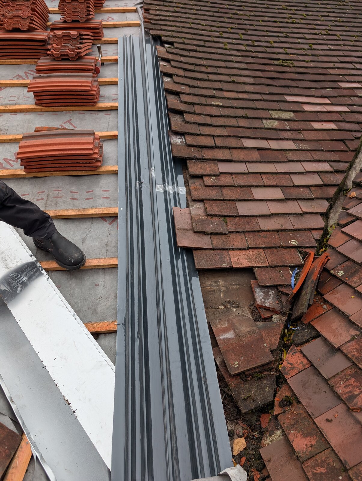

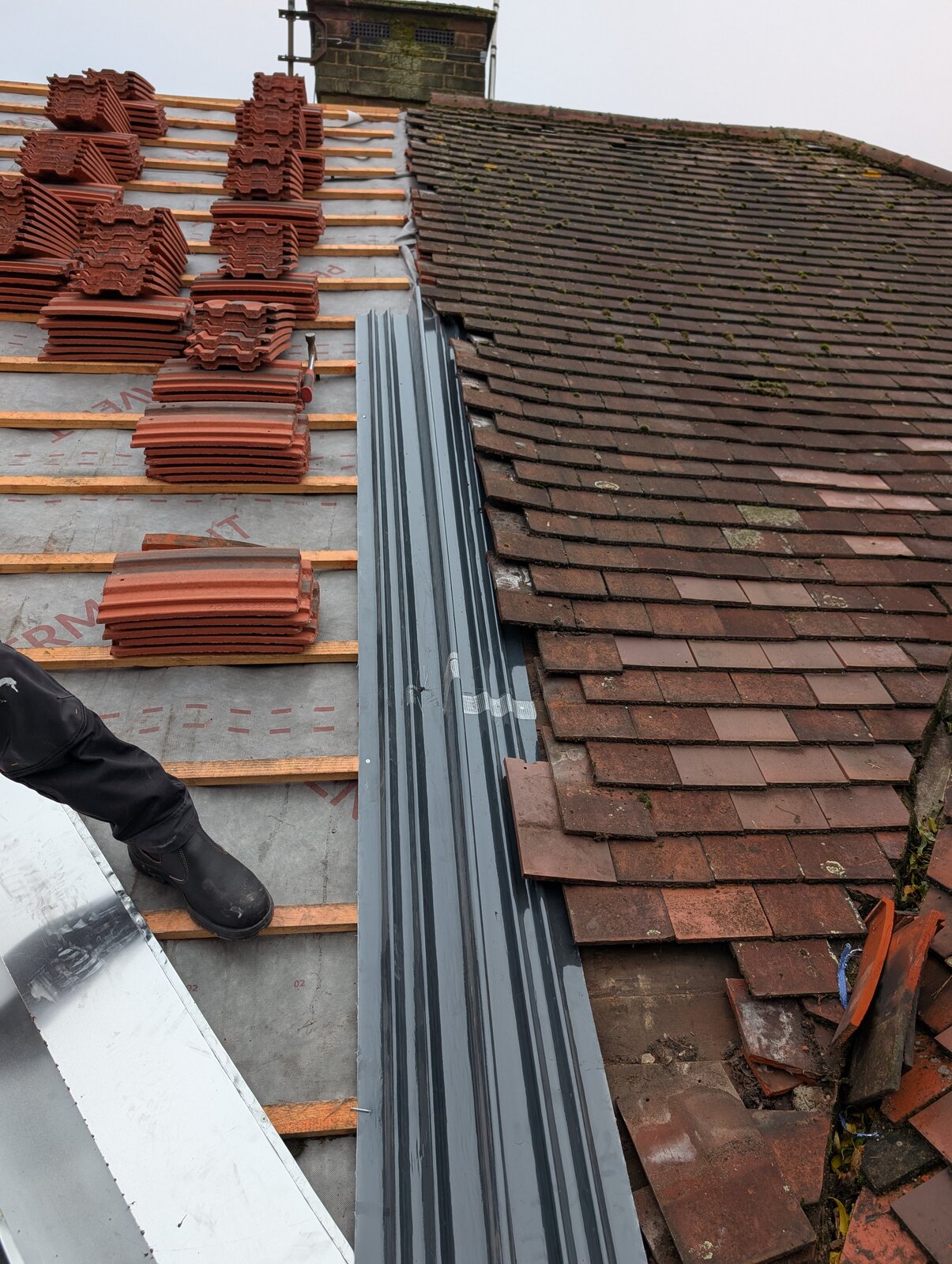

I have a 1930s semi-detached house with had Rosemary tiles on top of boards on the rafters. We're having it replaced with membrane + batterns and Redland 49s, and I'm looking at how to join the roofs. I wish we just got newer Rosemary tiles but the roofer insisted on these and we made the decision asap due to the storms. Oh well.
Anyways, now my roofer is saying that they tried but can't use a bonding gutter, they are small Rosemary tiles with a lip and so they're getting raised too much and they'd need to replace all of the middle tiles. They also can't nail them in to the bonding gutter and so they're slipping. They recommend ridge tiles instead (dry-fix due to them needing to be mechanically fixed now).
My parents had this done years ago but it seems like this is an older approach. Are using ridge tiles still considered ok?

Why not post pics showing a larger context of both roofs - & a pic showing how the valley & the BG are going to meet(?) & discharge at the elevation gutter?
Probably. What would you do here?
Lower the GRP BG, and sit it on (plywood) trays or noggs and all will sit nicely, so that the battens but up to the first profile on the BG.. Like we do with GRP dry valleys.....
Thanks for the advice and the clear photos! We can cut the battens on our side to lower it but I'm not sure how we could lower it on the neighbour's side since they still have boards on the rafters and nothing underneath. The roofers were implying that their tiles are rising because of the height of the gutter on their side when it's on their boards. Would lowering it on our side but keeping theirs where it is help to fix their tiles rising?
Also, the roofer said that we should use a dry ridge system over the boundary instead to avoid disturbing their tiles, and they've gone and installed it. Is this a bullshit idea and should I get them to remove it?
I can't see that working no.
Dry ridge is ok as long as they have used the roll-out breather membrane and SS fixings etc.
