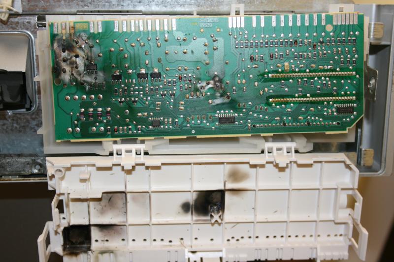

have read through a few of the previous posts on Bosch Power failures and it's clear my control board has blown, even i could work that out! (see pic
) ... i guess the question is, if i simply replace the board will this suffice or is it likely there is something else failing & am i better off replacing the machine as it is about 8yrs old now? ... advice from anyone with crystal ball appreciated

replace mc ,power board 100 quid put a new one in bang ,could be heater blowing it with out test meter you have little chance .8 years is a good life
must admit that is what I have been thinking ... but was hoping it would last a while longer until kitchen refit next year sometime ....how would i go about test ing the heater? easy job or need a bit more knowledge than basics?
put meter connections on heater should read 25 ohms but you need megga to see if it has earth fault , or buy a second hand dishwasher for now then sell it next year you will easy get you money back for it :)
mate, sometimes it just takes someone else to tell you before you pull the plug!
if i could be guaranteed replace board and off we go again no problem then fine but with chance of further failure logic says it's time to replace!!
