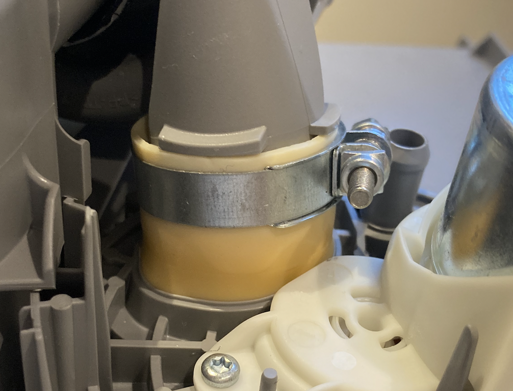

I'm trying to resolve an E15 error on our dishwasher being caused by water leaking into the base. Having run it with the cover off I can see it dripping from the area circled on the picture below. Does anyone know what seal I need to replace to fix this? I've been looking but can't work out what I need to buy. TIA
Luckily it's not too much drama to fix, just a bit fiddly.
For mine I needed this part 12005744. This video shows how to fit it, its not in english unfortunately. The edges of the case are razor sharp and I ended up cutting through the first one so had to buy another, just don't pull on it too hard when you are trying to pull the loop back through the hole!

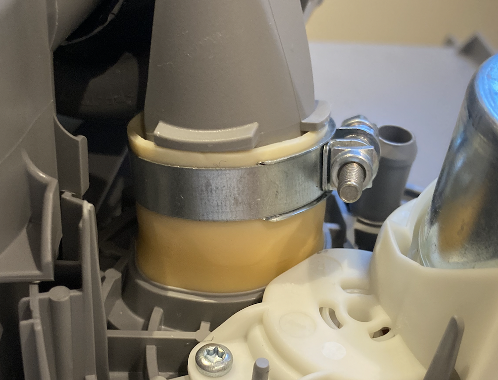

I just fixed my one the jubilee clip had just slipped down.
