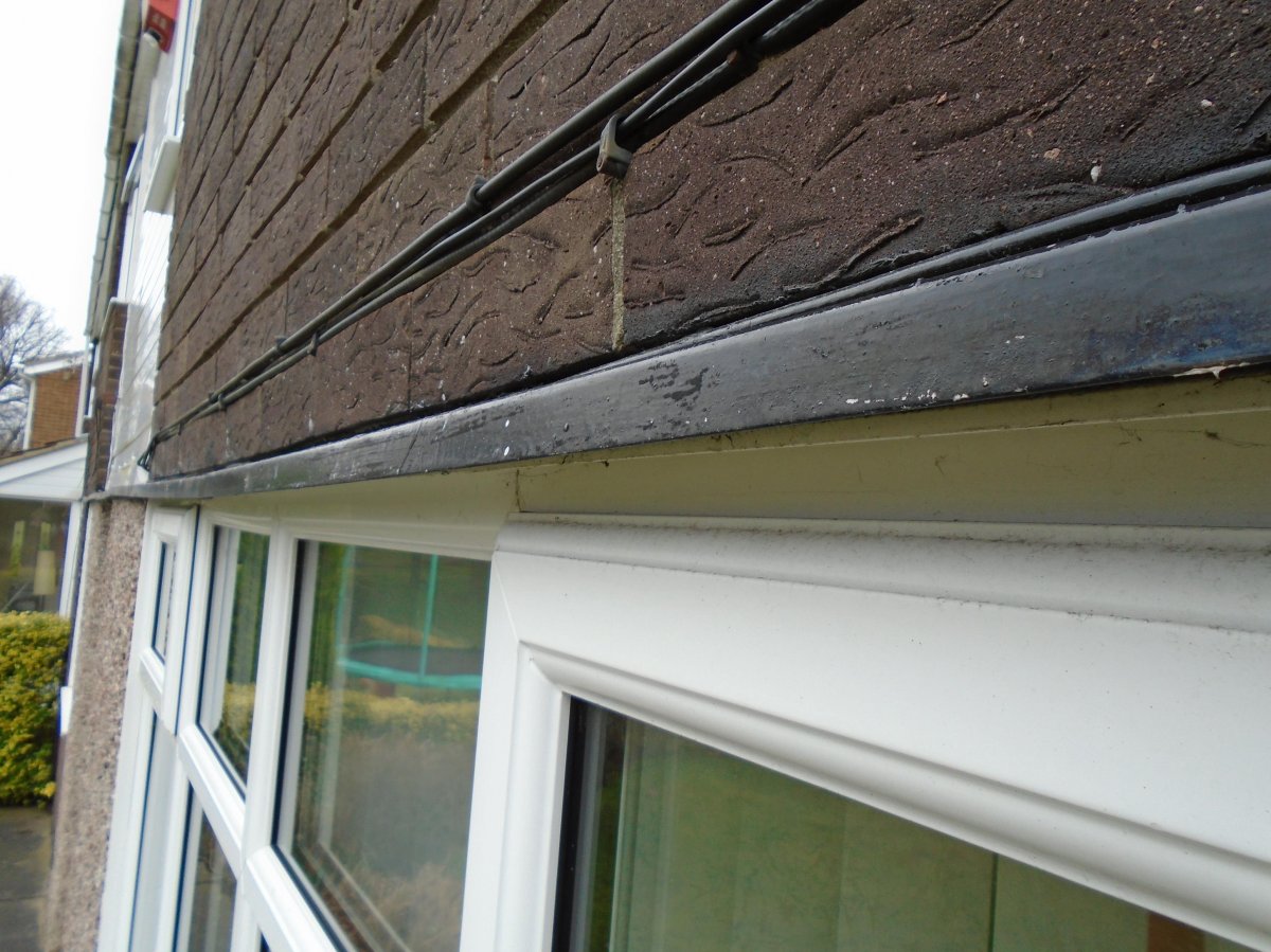

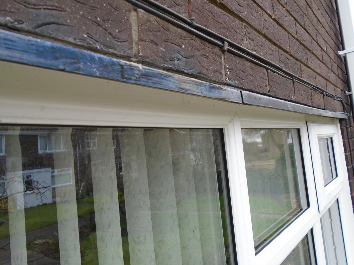

Can anyone advise me?

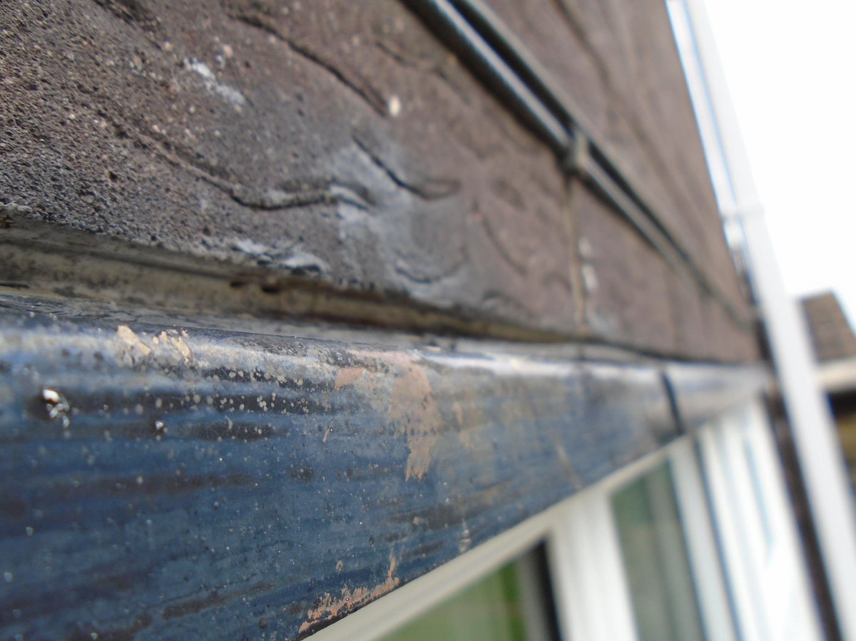

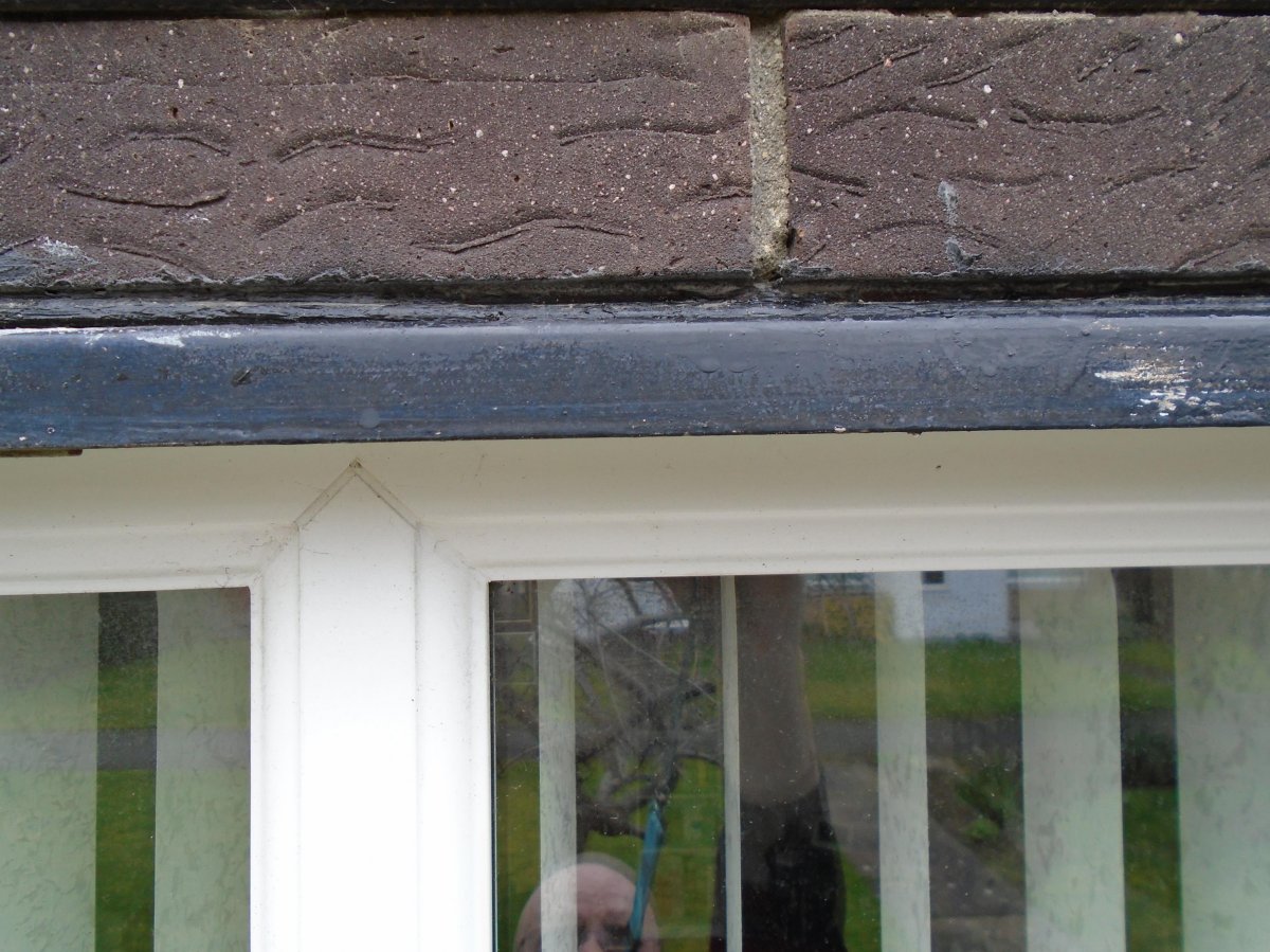

The lintel supporting some new bricking up of window (done many years ago) is obviously too weak and causing sagging, thus allowing a gap between brickwork and plastic window frame.

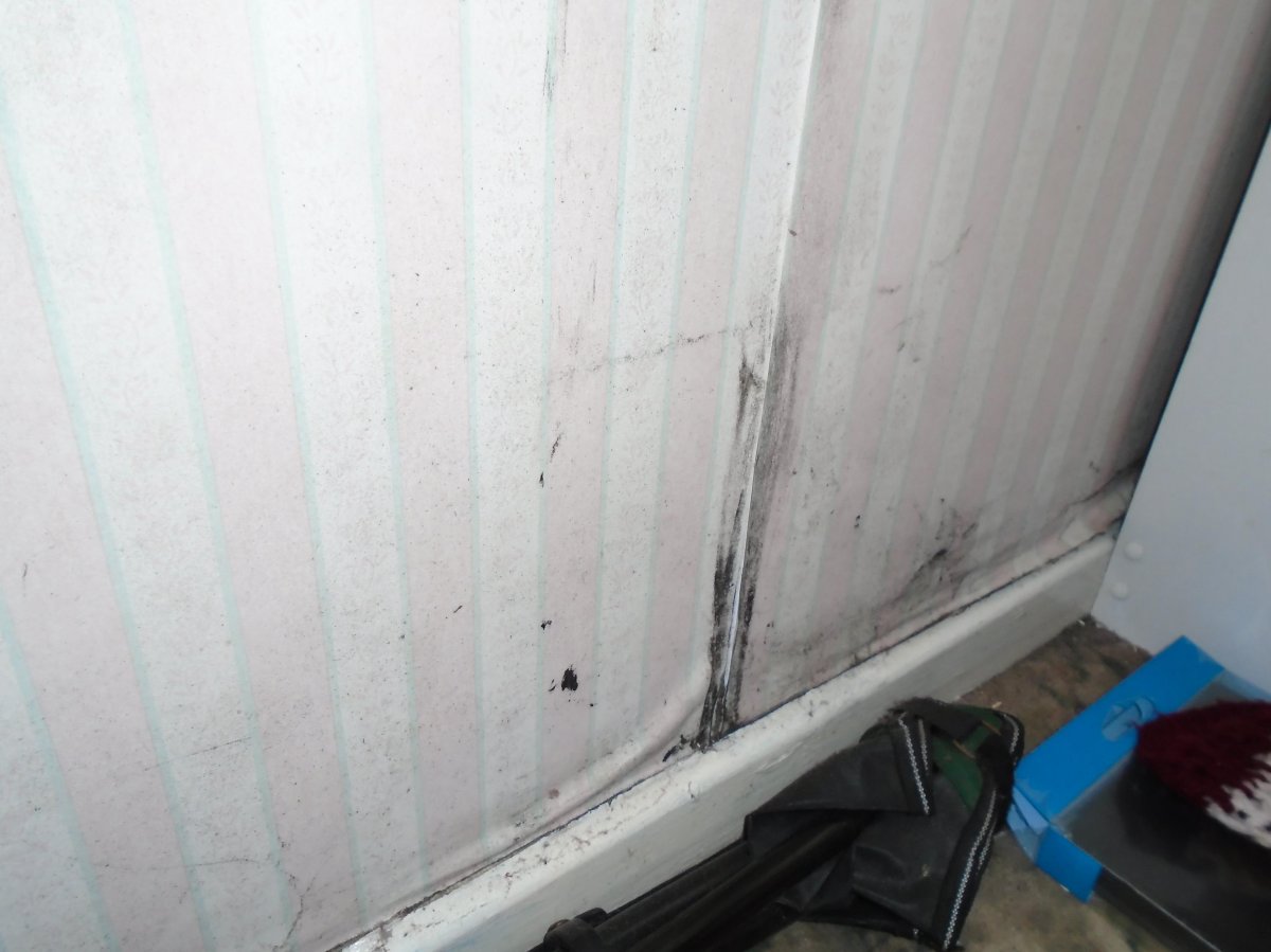

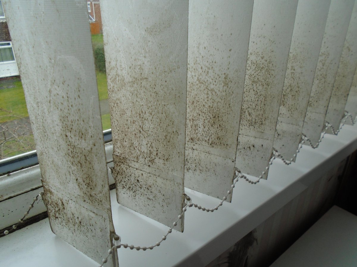

The whole wall o the fron bedroom shows signs of damp ingress and the window blinds have mouldy markings.
As I cannot afford (I am a 79 year old pensioner) I was wondering if some kind of expandable filler could seal the gap, alternatively a steel insert to try the rei-inforce the weak lintel.
I will get in a tradesman to rectify, but any advice would help so I don't get ripped off!
Thank you in anticipation of any helpful suggestions.

Sounds like it could be water penetration or condensation perhaps from thermal bridging, or both.
What kind of lintel was it? Was the cross section a kind of top hat shape, or a capital I? Does the window have trickle vents or do you open it every day for a while? Is that bedroom in use for sleeping (ie breathing out rank air). Where is the radiator in that room and is it on?
Some photos outside and in would help, and any you have from during the work or before.
Post a picture from the inside and outside showing the frame and area of wall above.

The radiator is on the opposite wall near the entrance to the bedroom. We keep the window open during the day, and also use a de-humidifier.
You have a condensation problem for sure. I can't see any evidence of water penetration - ie water running down the frame when it rains.
You need to throw anything mouldy away, and clean any mould from the walls and ceiling with a sterilising solution. Clean up condensation on the windows and cill morning and evening, and then read up on condensation prevention.
You can point that external crack up with silicone if you like.
