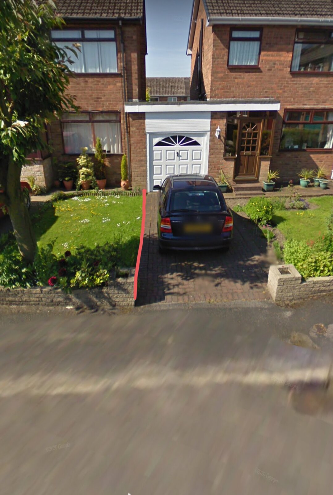

By way of looking at this image...... where would you say the boundary is between the house on the left and the one on the right...
A) at the edge of the driveway of the red one.... or
B) at the left edge of the brick pilar

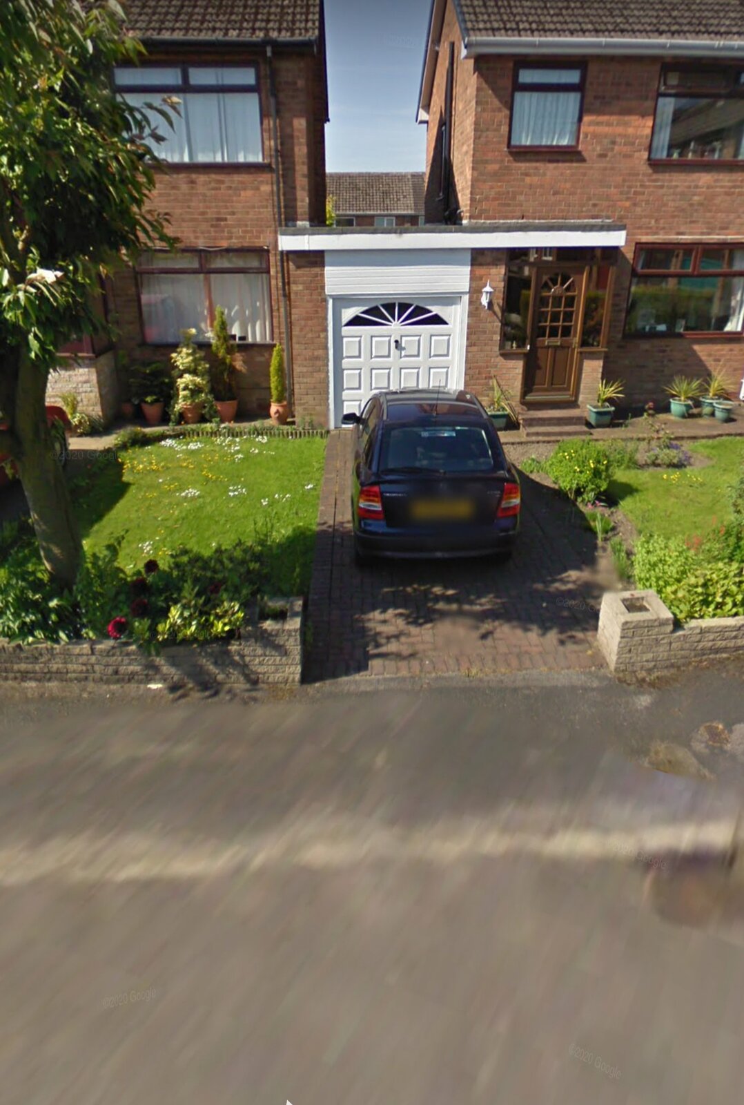

Heres another image....
I think its the edge of the driveway and that flower bed with the bushy white flowers in, belongs to the house on the left.

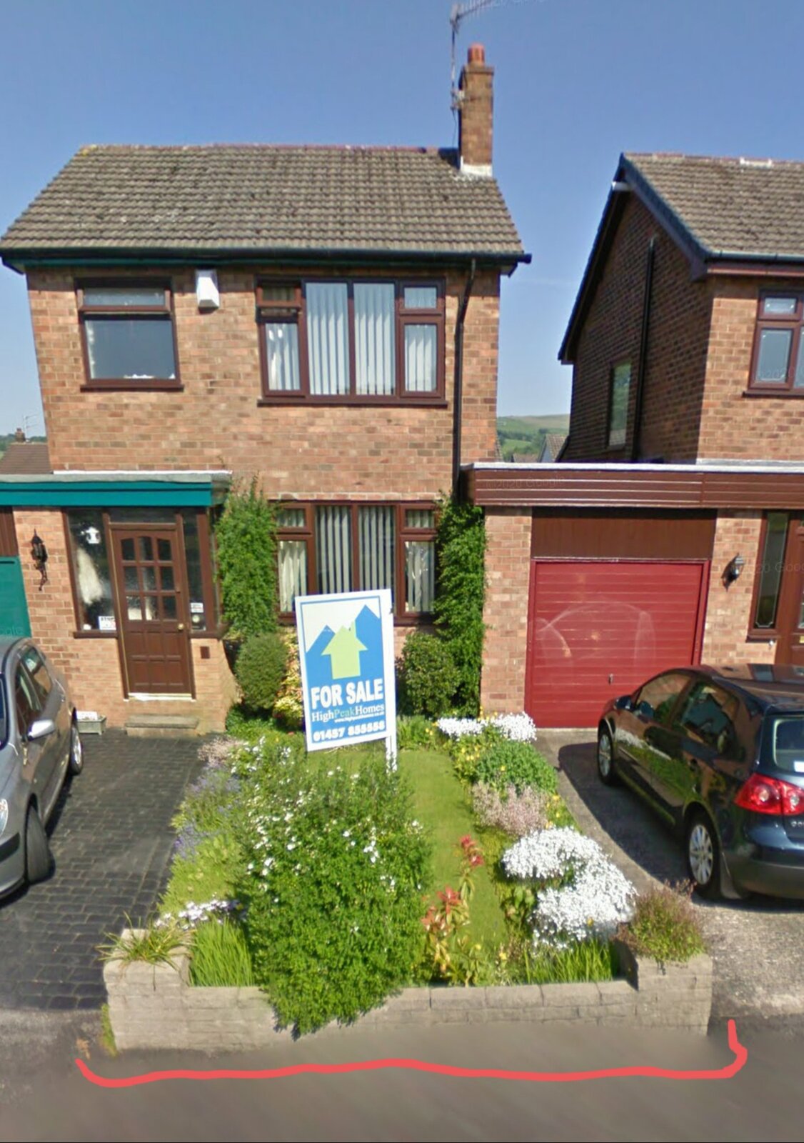

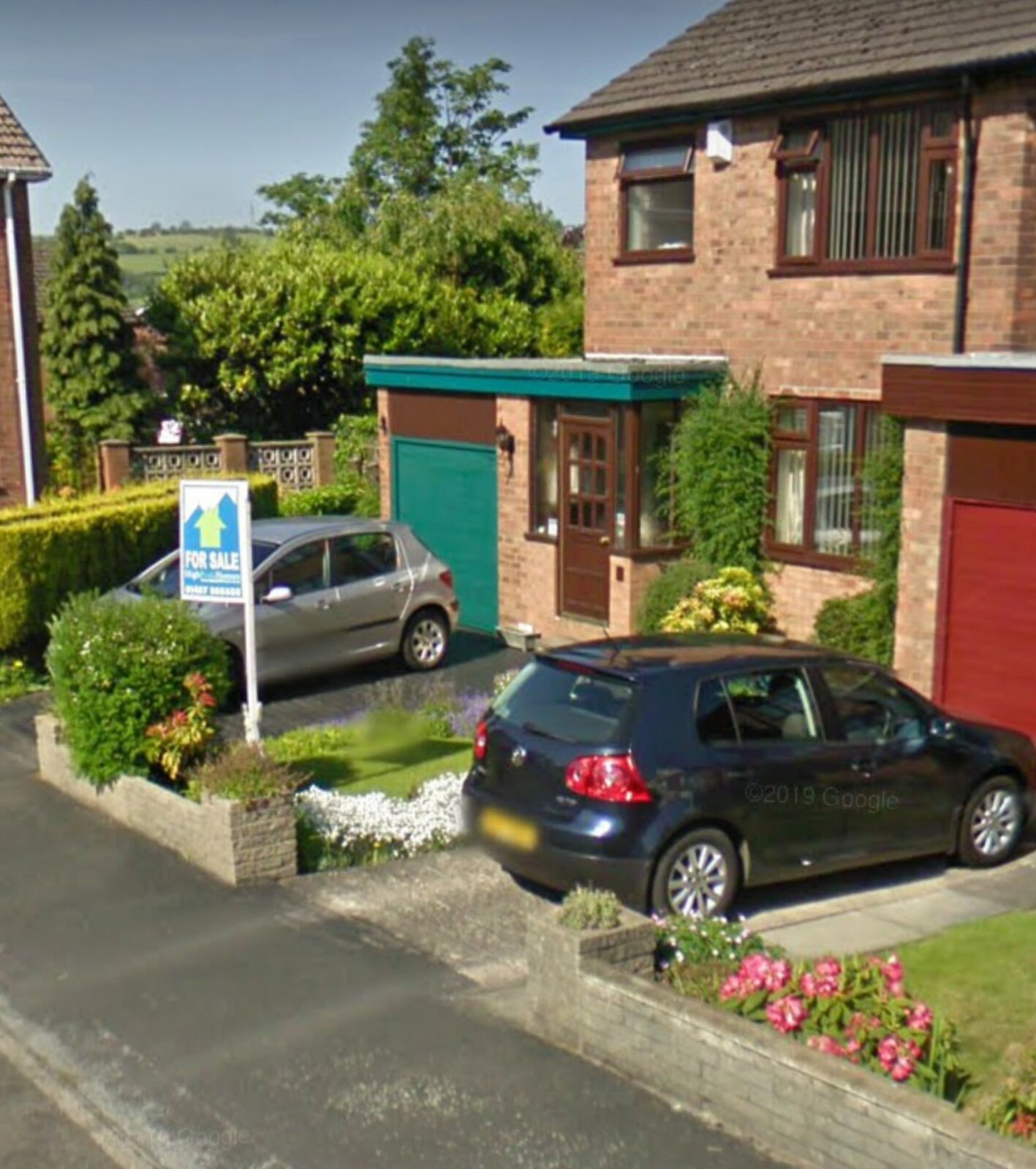

Heres another house on the same street..... shows the lawn on one property butting up to the driveway of the one next door...
I belive the wall at the front shows the boundary...... ie, the entire wall..... pillar to pillar belongs to the house on the left....
The house next door...... u can see the boundary lies along the edge of neighbouring drive..... I think it would be the same for the adjacent properties..... and hence A) rather than B).
You were asking for opinions, mine is B.
If you went in that garage with the white door and turned left, are you on next doors land inside the garage?
There's about half a brick of space inside the garage if u turn left. The gable wall of the left house is more or less in line with the line of the driveway. If the house on the right wanted to construct a fence along this line.....
Do u think its legit. Looks to me like they're nicking a bit of land from the house on the left. This isn't a boundary dispute at the moment...... im just looking for a bit of leverage against the one on the right who is as vile a person as anyone would ever be unfortunate enough to meet and is being really obstructive.
I appreciate your opinion, so thanks..... im just countering it with what I think to see if what I think holds any water

I'd say C in line with the outside face of the left houses wall, although looks like the gable overhangs so it may well also include that.
But our opinion is not going to win you an argument, especially with someone unreasonable.

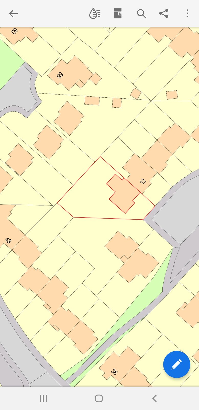

This is what the land registry hold. House outlined in red is the house on the left in the above pics.
Does this make it any clearer? This is nowt to do with me trying to claim land.... but the owner of the house on the right is a total nightmare and won't allow proper access to my gable wall to replace the soffits n fascias. She won't allow scaffold and is kicking off all the time. She has constructed a fence in what I believe is my garden. I'm not bothered, but if she has, it gives me some leverage to gain access off a scaffold on her garage roof.
Although, ive seen much more detailed boundary documents with a 'T' used along the boundary to designate ownership.
I think thats the old documents , we had that in various houses from 1904, 1970's & 1980's
But picture from the back to show where the building override in the back of the land reg - and how that aligns to the front
If then the next door overlaps like the front
Think u might be right Nitro . Just seems a bit odd that the pillar at the front garden wall wouldn't mark the boundary.
