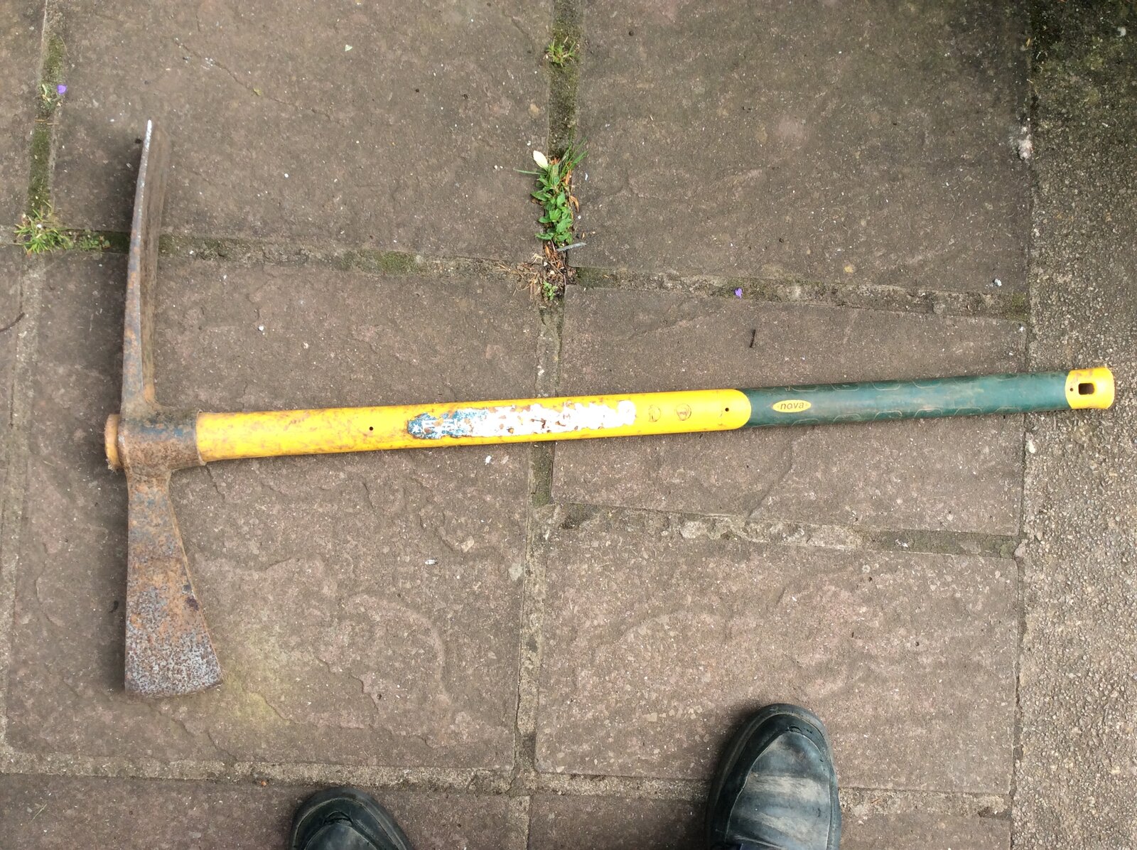

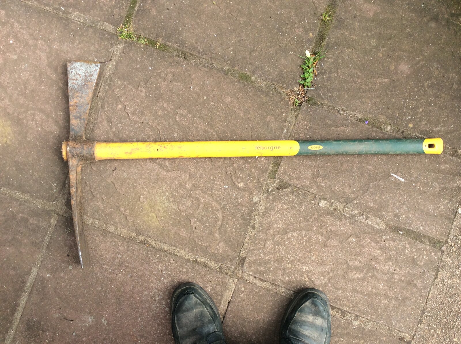

If I cant get a machine to it I use one of these which is the best hand tool Ive come across for digging roots and stumps. Its much finer with longer blades than a mattock which cuts like an axe
That's what I would call a grubbing mattock, if you have room to give it a full swing the "axe" side is useful for breaking roots, the "grubbing" side for removal of earth under and around them.
Blup
Blup
The blade is a bit longer on this and goes by the name of a Corsican axe mattock
