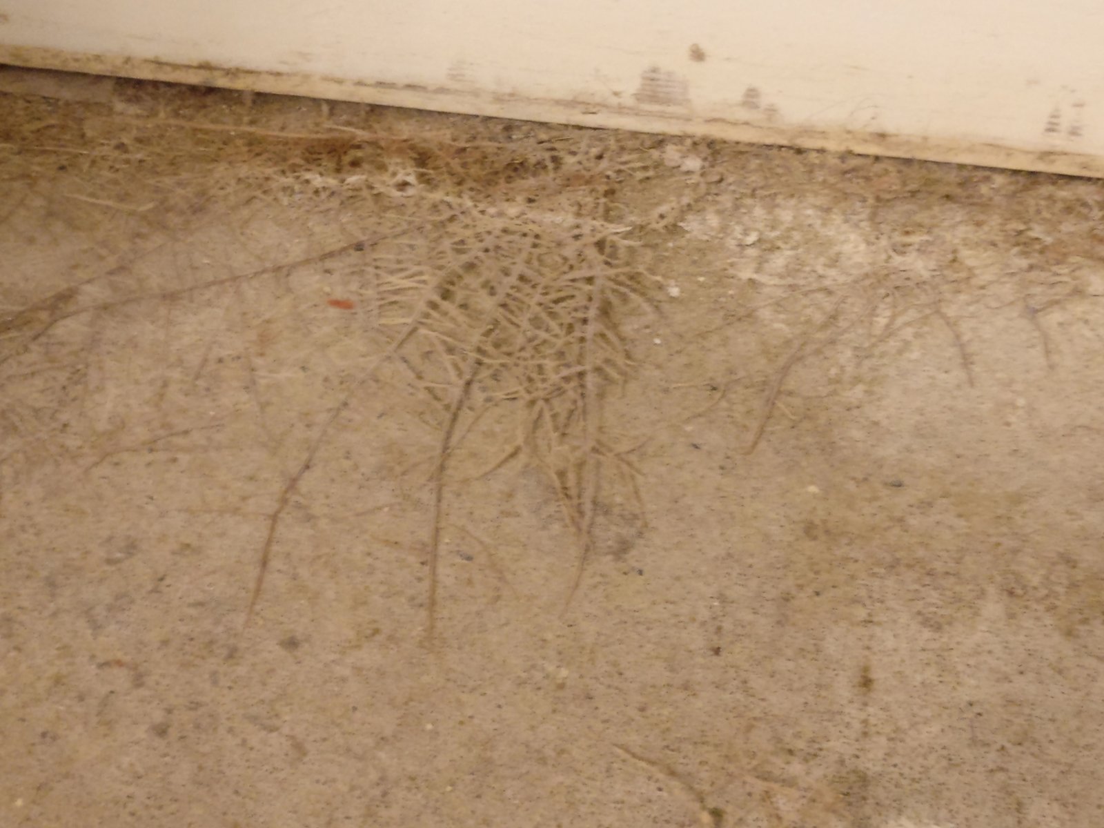

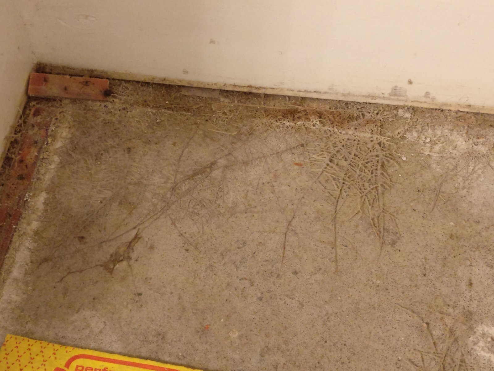

We're in a detached 1870 Victorian house. Investigating some damp on an exterior wall we discovered that under the carpet (it's a concrete floor) are some very fine tendrils extending a fe inches from under the skirting board.
I at first thought it was dry rot but the strands have a bit of strength akin to worn out cotton and we're fairly sure they are roots.

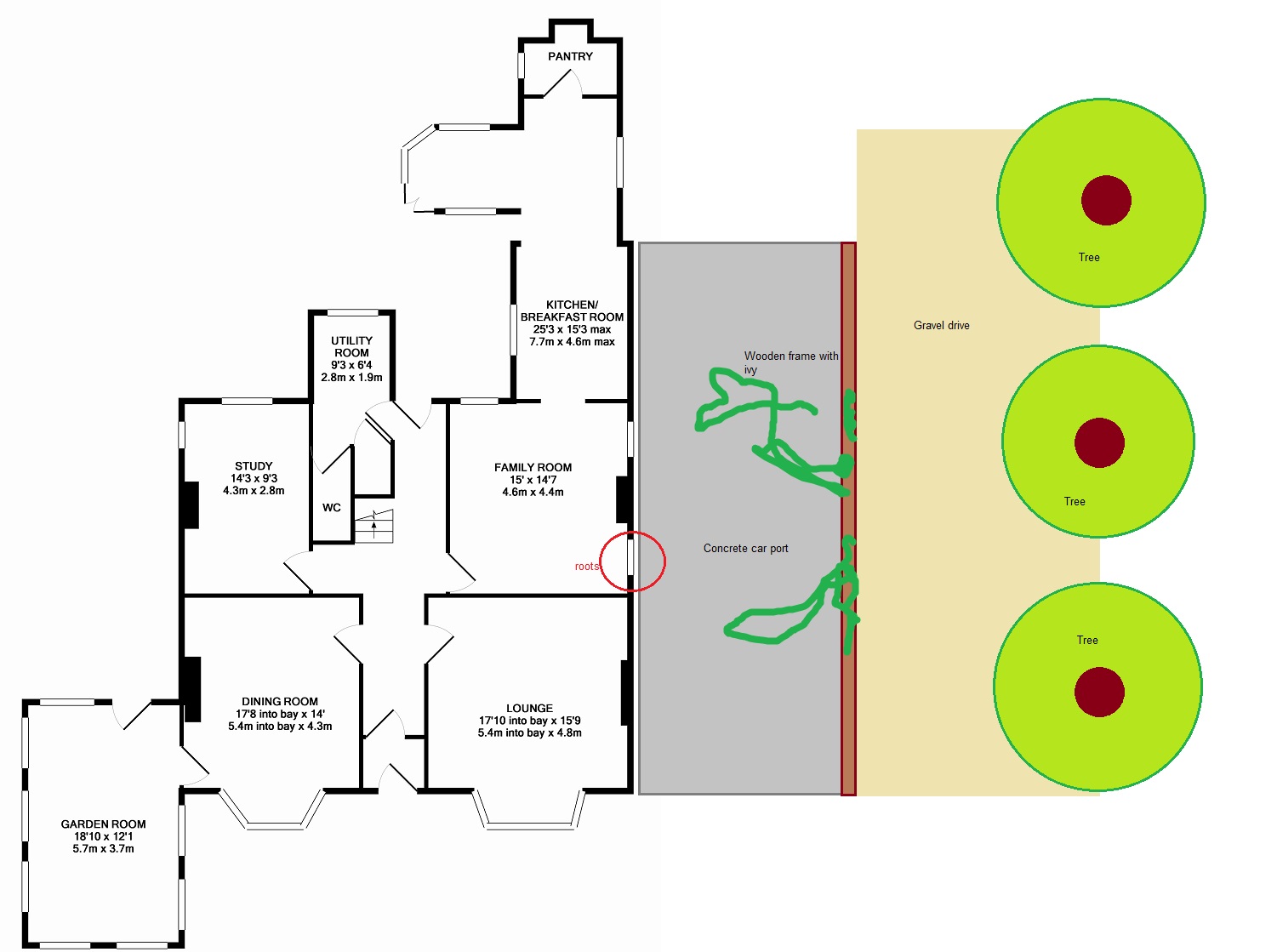

To give a bit more detail, this room has a concrete floor (possibly laid later, we're not sure if it was cavity to being with) which is actually slightly below the outside ground level... there is rising damp the whole length of the house exacerbated by the fact this is the north side of the house. Directly outside the wall is a concrete slab car port perhaps 4m wide. Then our driveway. So there is nothing growing within 20-25 feet of the house and hasn't been for decades, but the roots are clearly newer than that.
We do have a row of mature sycamore trees about 20-25 feet away the other side of the drive and car-port which are probably of order 60 foot tall. I don't know anything about the root systems of sycamores particularly but the general guideline that root systems extend at least as far as the canopy would out the edge of the house in the firing line.

'Roots' inside:

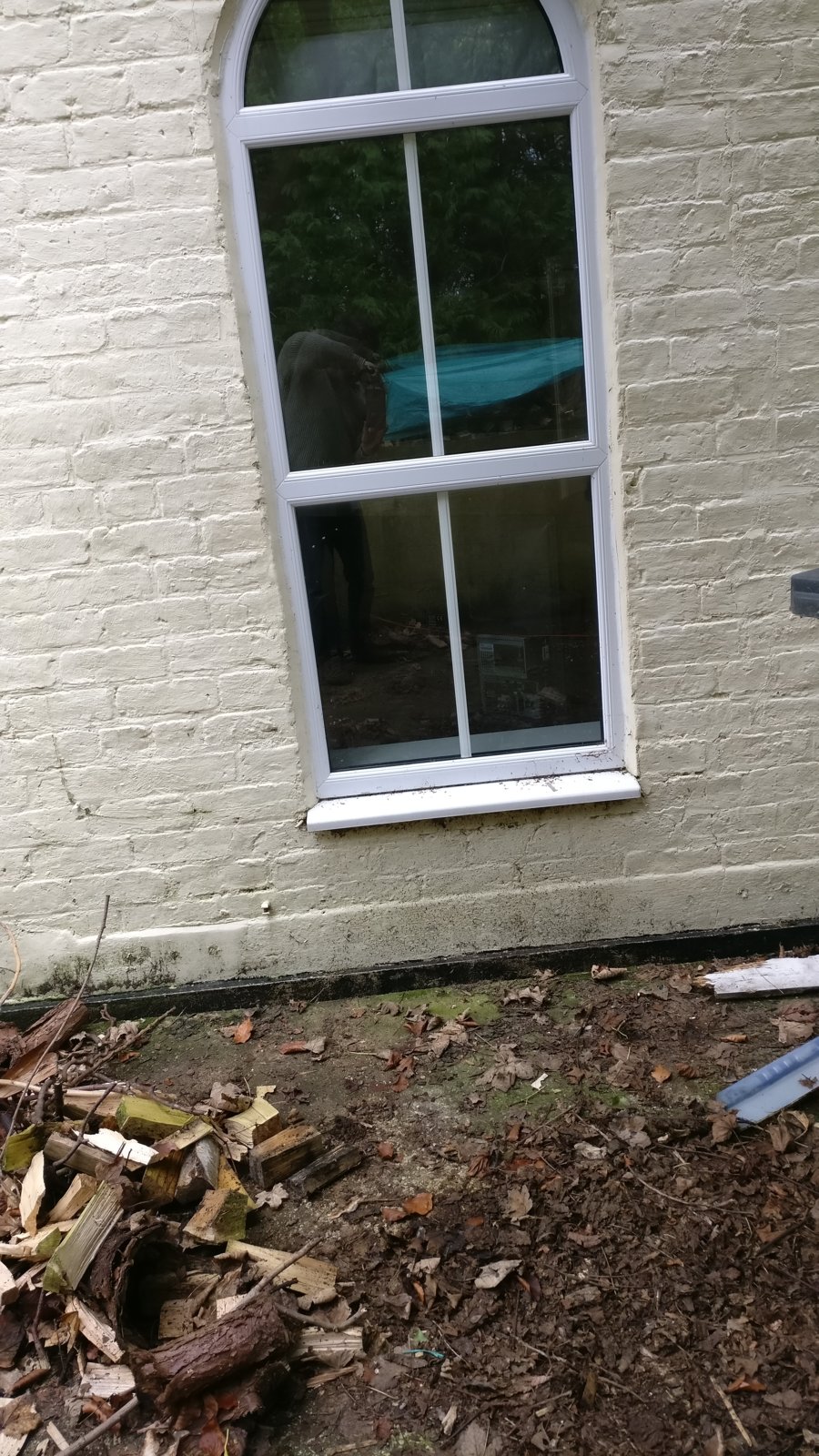

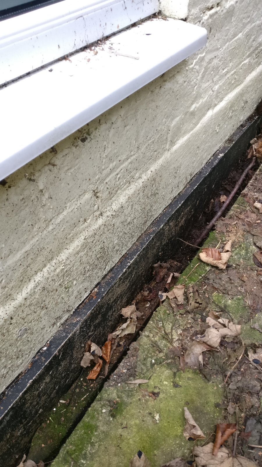

Outside. There is a drain between the house and the concrete slab. Floor level is actually the bottom of the drain so the slab is higher but not touching.

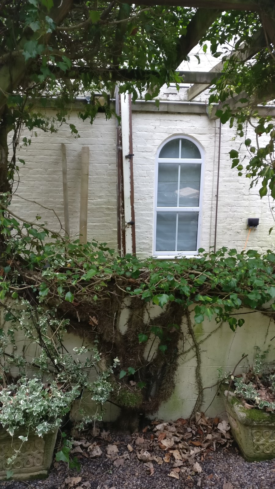

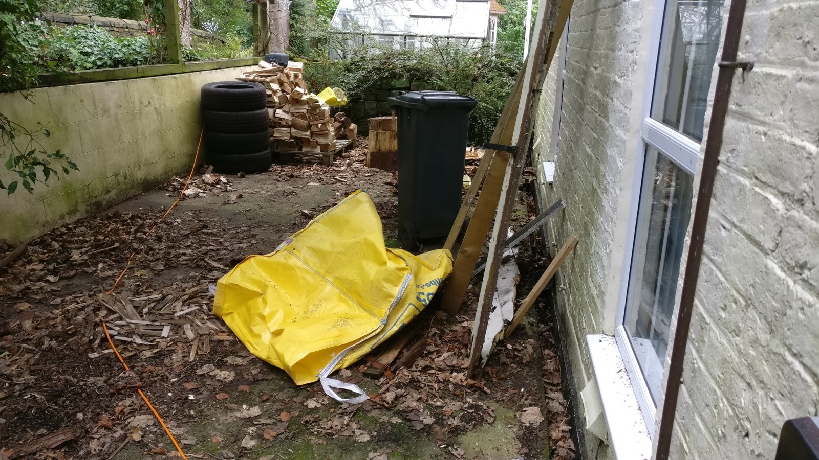

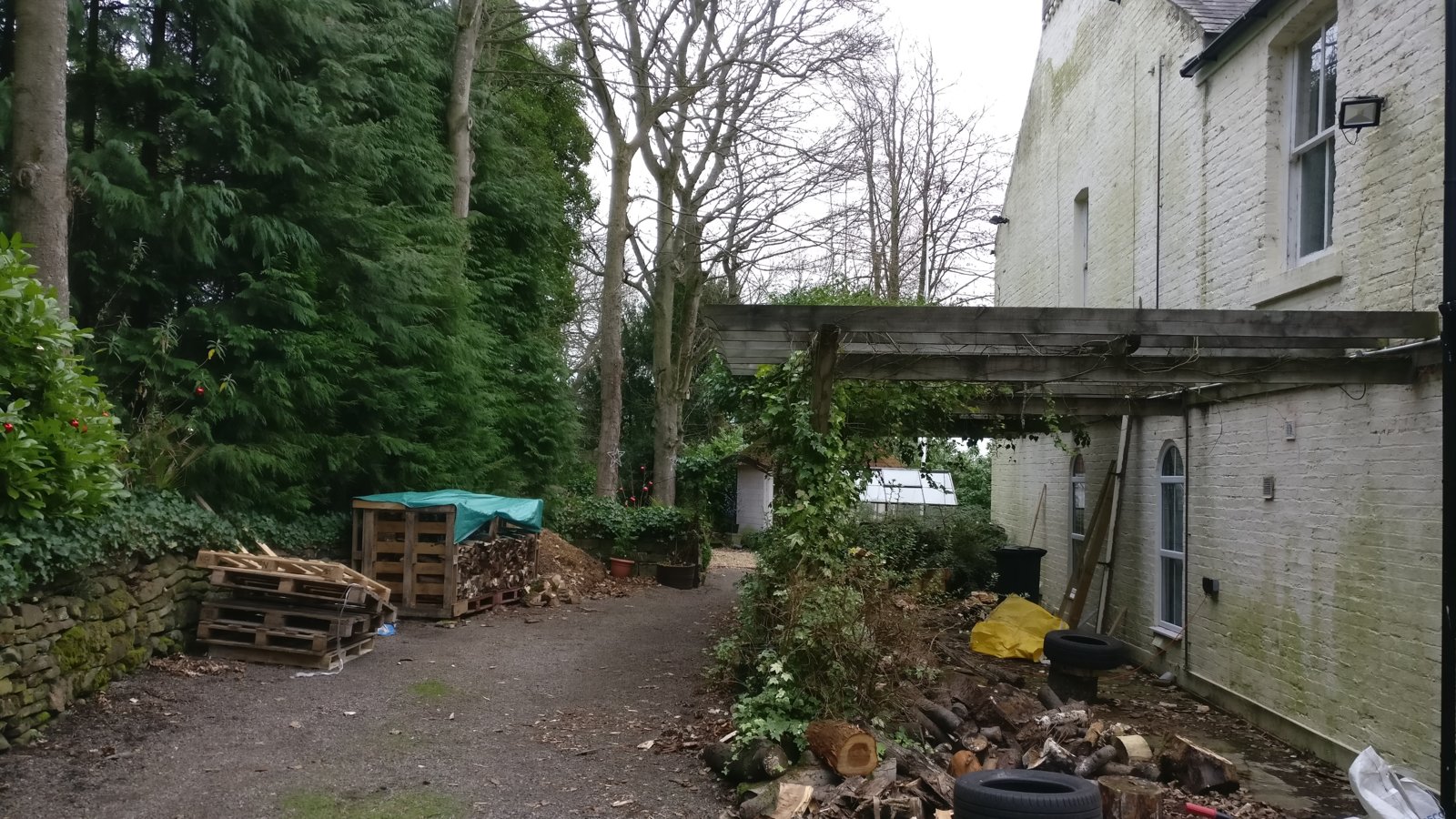

The external wall, car port, drive and the row of trees (just visible among the leylandii hedge)

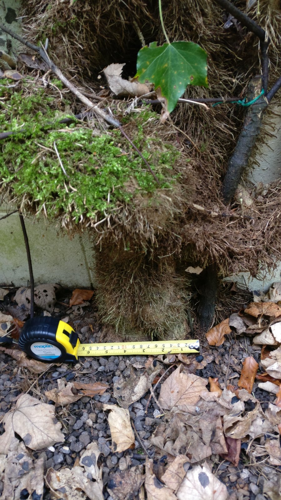

Ivy on the car port, actually rooted in the ground. Pretty big.
And a plan of the car-port... trees are actually trunks 12-18 inches, ~23 feet away.

Photos. Not sure what it is, but curious. I guess it could be the tree. But you sure it's not dry rot?
"below the outside ground level." - was that concrete slab in the car port raised above the damp course? Did it block air bricks? All sounds a bit iffy
Wet rot fungi can send out mycelium in fine strands that look a lot like fine roots as they search for new wood to eat.

I had totally forgotten that the car-port is covered with ivy and that while some of this is in pots, the main plant is not. It is one single plant which is probably 6' tall on top of the wooden structure and with a main trunk 6" thick. This is only about 12-13' from the house whereas the trees are twice as far away.
Is it more likely the ivy is to blame? That would certainly be easier as I plan to remove the horrible stuff anyway (previous owners loved it and we cleared a 100m brick wall of it which took several days!)

It could be tree or ivy roots. I'd start by clearing the carport thoroughly and cleaning out the drainage trench - roots need moisture and something to grow through, so get to work with a shovel and broom. Spray weedkiller in trench (maybe seeds have fallen in and started sending roots out, although less likely as nothing on top). Then see what happens.
If from the trees or ivy I'd expect to see obvious signs on the outside. Unless it is under the concrete, but I am not sure they'd make their way to the house without causing noticeable damage to the concrete.

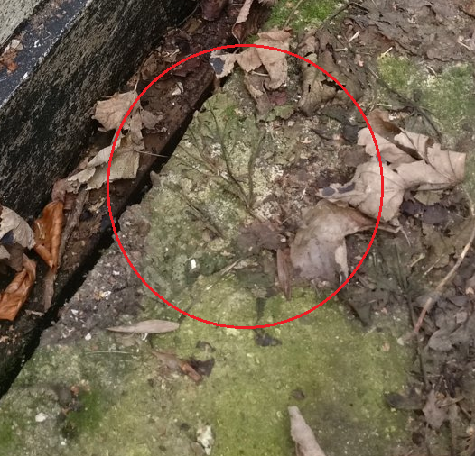

But ... what is this? A decayed leaf, or roots?

I'd guess that's a 'ghost leaf' but I'll double check. Good spot.
Clearing the whole area is definitely on "the list" to check if that drain has any cracks and stop it sitting full of wet (I found a huge toad in it taking these photos). At the very least we'll find a way to stop it filling with leaves, possibly dig down a bit deeper to raise the effective floor level compared to outside.

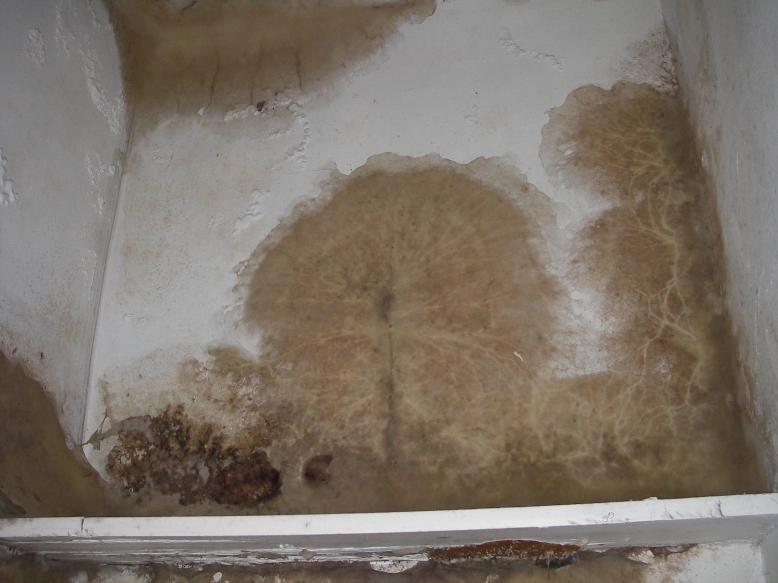

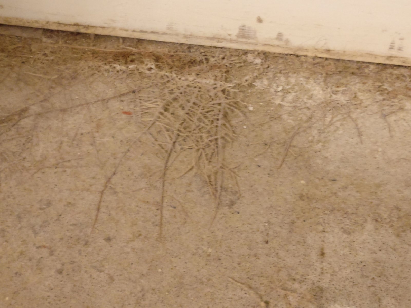

This is dry rot... seems furrier and more clingy than your pic though
The thing that made me doubt rot was that with a concrete floor, the skirting board is not (obviously) riddled with rot and there isn't any other wood. One bit of carpet grip rot had rotted.

This picture is of dry rot that was in my previous house when we bought it. This is it growing across plaster... so I'm sorry to say I agree with the ID from Jonbey
Should be able to tell if its a root ,if you scrape the outer skin away does it leaves a tougher core ..doesn't dry rot have a musty smell?
