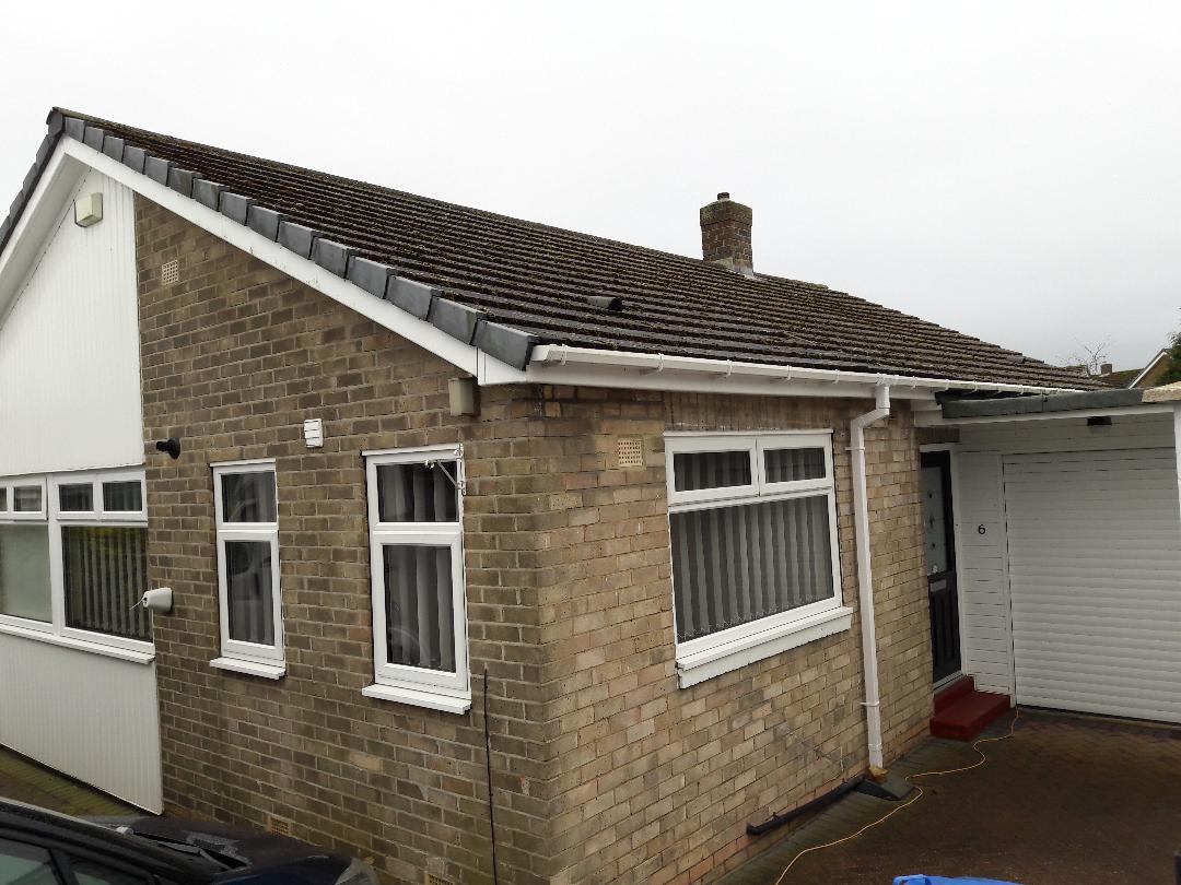

We live in a 1960's bungalow that was built on low lying, boggy land, so that we are in a fog/frost pocket that means the humidity in the house can be high. When the weather is very cold we get damp on the underside of the roof felt that wets the tops of the timbers, where they touch the felt, and can drip down onto the loft floor
We have improved the ventilation by vented bricks on the gable ends, vented roof tiles and vented sofit boards, but clearly still not enough. I think that the roof has been replaced at some time, as we seem to have 2 layers of roofing felt, the lower one is torn in places. We are thinking about a new roof and are asking if we should replace all the felt with breathable felt, and is it likely to help in solving the problem?
TIA

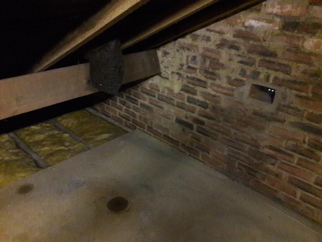

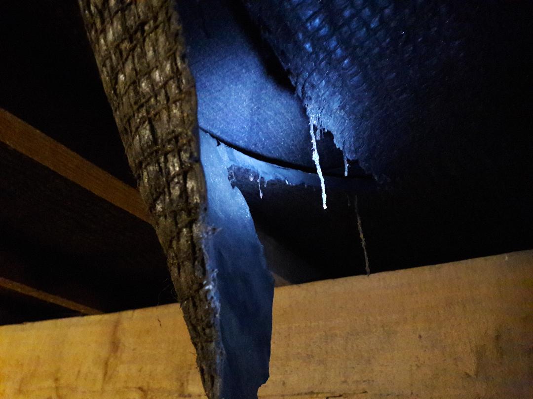

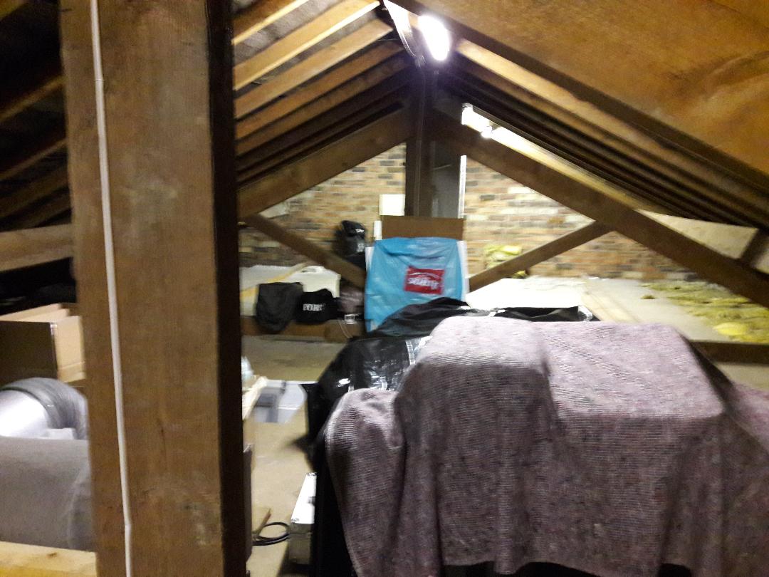

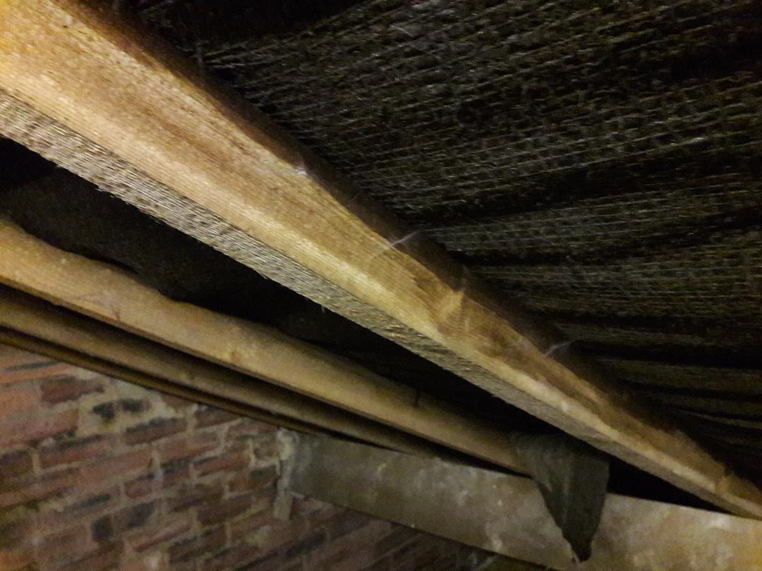

Images show the damp on the rafters and the two layers of felt. Please ask if any more images needed. TIA

I see a non breathable felt type 1 f.
You say you have two layers ? Are seeing the second layer through the ripped areas ? They could just be poor repairs .
If the whole roof definately has two layers of felt, then there is no reason not to pull off the old .
Thanks, there are several areas where it is ripped, with another layer showing above, so I think two layers. Think that I may also try some circular push in soffit vents
Two layers makes no sense . You could be seeing underlay repairs.
If it is definately two layers over the whole roof then it can only make things worse.I have resisted the usual insulation and extractor questions .. there's tons of top advice ref condensation on the site
