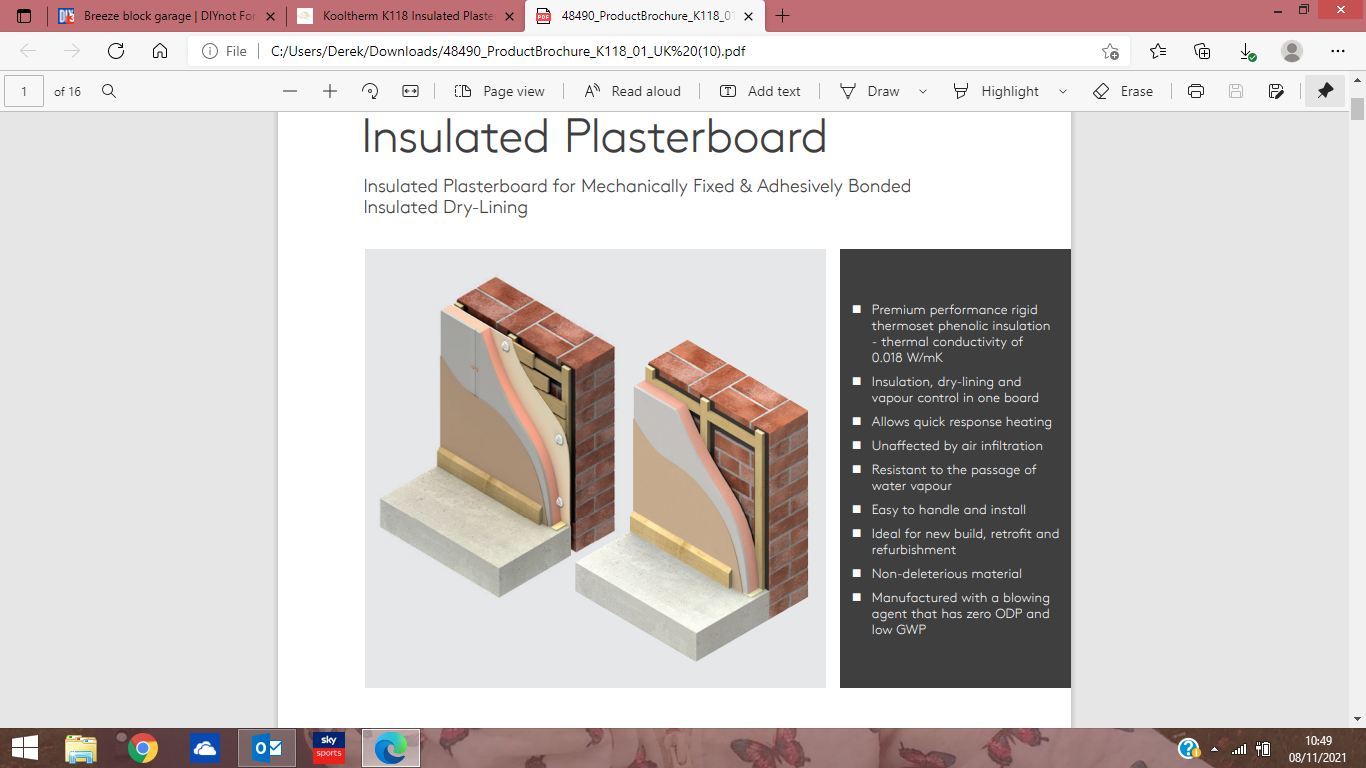

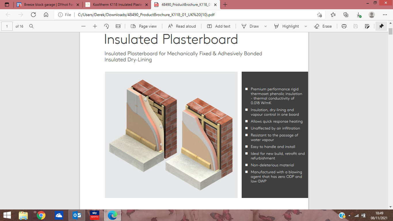

Breeze block garage
Its rendered so moisture should not be an issue not unlike the Kingspan K118 specView attachment 249976

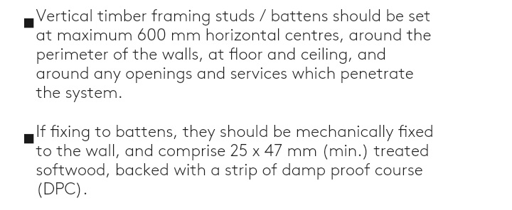

...although, would the battens need better protection from water ingress, if attached directly to the single skin?
The Kingspan specs recommend backing the battens with DPC :)
Edit:
Ooops, sorry @noseall , I didn't notice your comment about running DPM behind the battens.
Read my post again and see if you can get where the DPM membrane occurs relative to the damp outside wall. I look forward to hearing that distinctive noise as you slap your own 'ed.
According to your plan the dpm runs 600mm up the wall . against the potentially soaked single block.
what I asked was what happens to the potential water/moisture that will innevitably soak straight through the block regardless of whether its rendered or not.
The 600mm DPM up the wall is merely a lap for the vertical DPM which covers the wall and is trapped behind the battens and Iinsulation.
It's not difficult to grasp.
The water or damp does what it always did and remains in the block.
its not difficult to grasp if youd stated dpm the whole wall in the first place. and still no answer to where the moisture will go.
