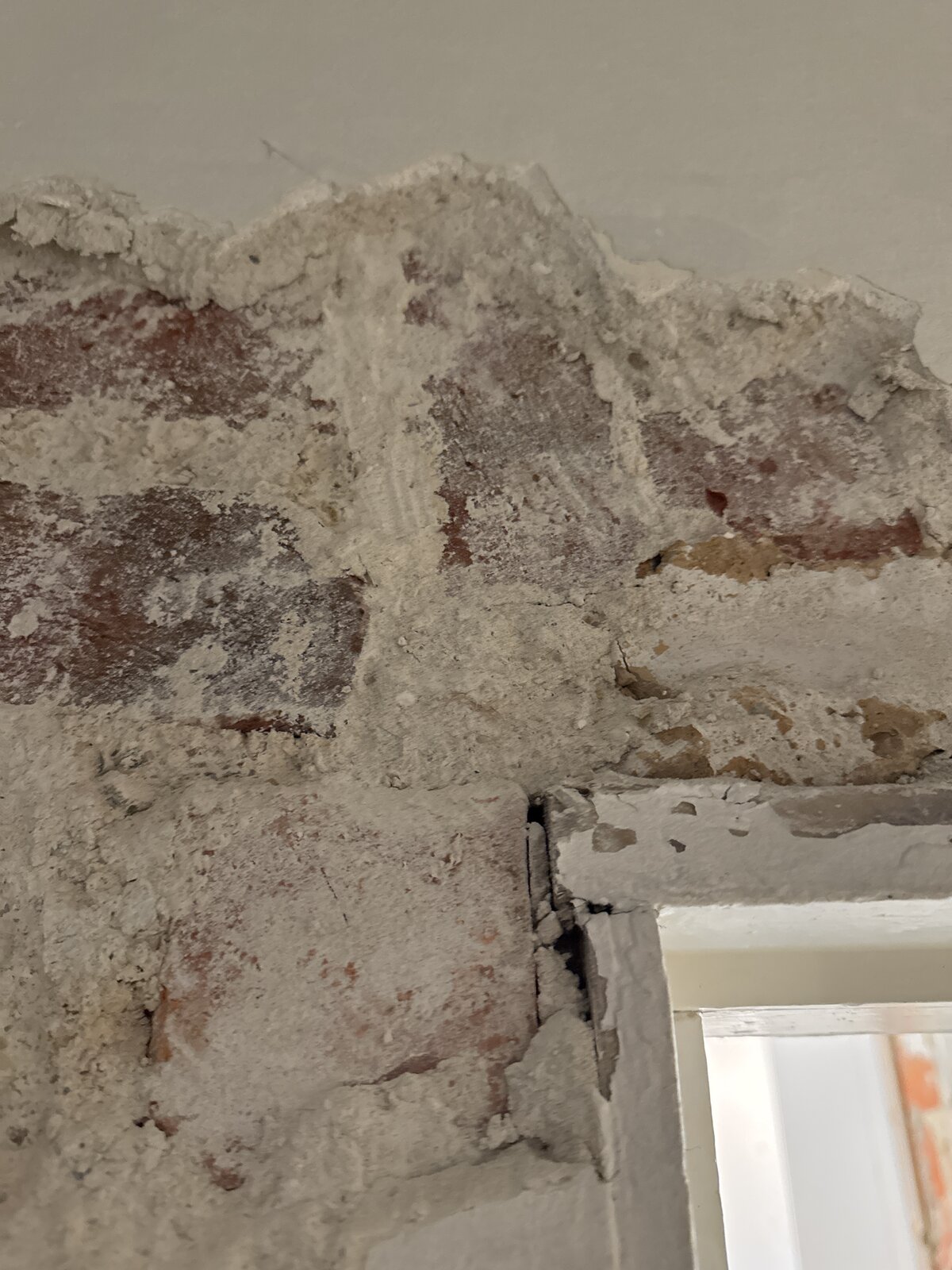

Here is a picture of the one arch end. I’m assuming I can’t just lose an inch off the bricks below right? That seems to be exactly where the arch goes to.
Do I need building regs or control - and is it something I can do myself anyway with a lintel or steel? Feels that with one floor of single brick above it, there isn’t the largest weight from above but conscious I don’t know what I’m talking about!

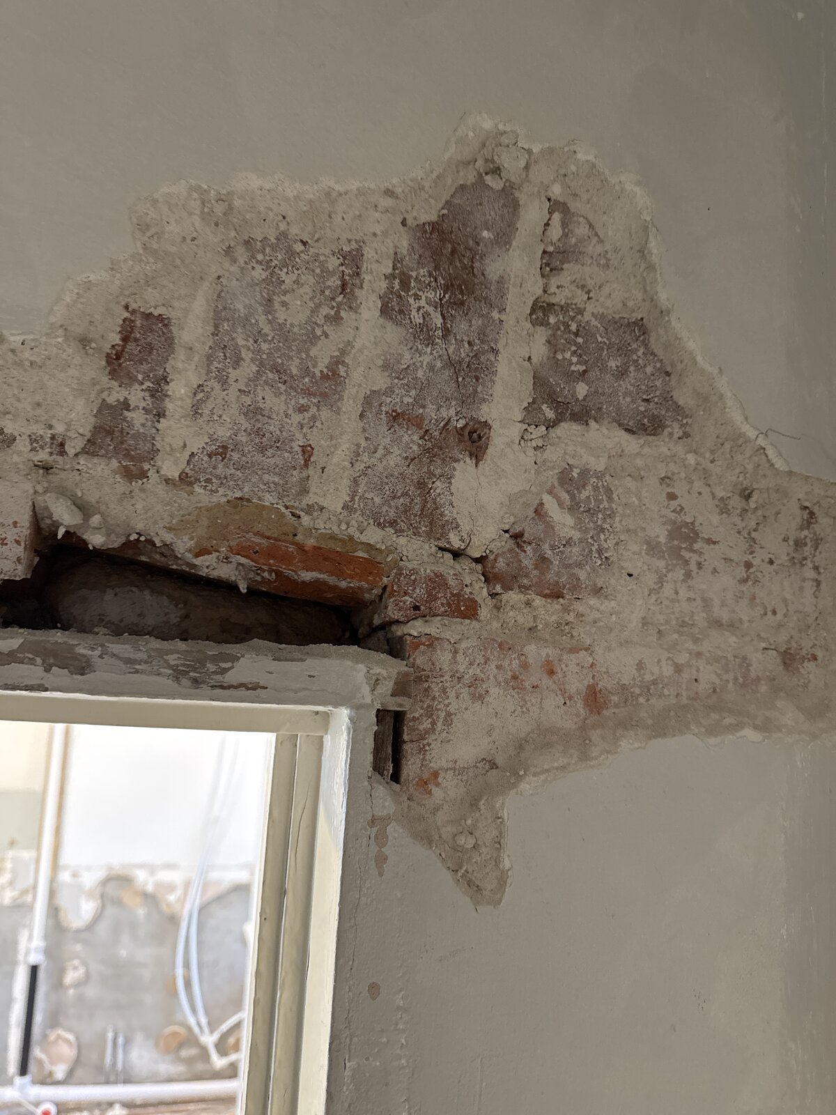

Here is the other side, looks like it’s sitting on mortar anyway. Oh and the walls are two bricks wide!!!

Drill in an acrowed strongboy above the arch, thump out the arch, fit the lintel to the desired height, build back above/make good. If it's 225mm masonry, do the same to both leaves.
Thanks Noseall - happy to look up how to do it online and would be confident - but does it need building regs? Feels like it is structural, so it does...?
And can I confirm, based on the pics, there isn't enough space to shave say 2cm of either side (which is annoyingly what I would need)...
Strictly speaking - yes. Would I bother in my own home for a doorway sized opening - probably not.
