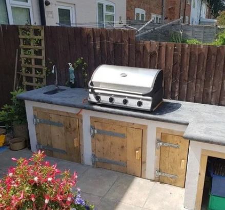

No one said they are building a BBQ out of UPVC.
It would be helpful if the OP posted a plan of what he intends but from what he says I envisage it looking something like this picture, not sure if his BBQ will be totally on the top or inset like this or if it will be open to the bottom. But looking at the cupboard on the left - there is no way that door if UPVC will be effected by heat from the BBQ

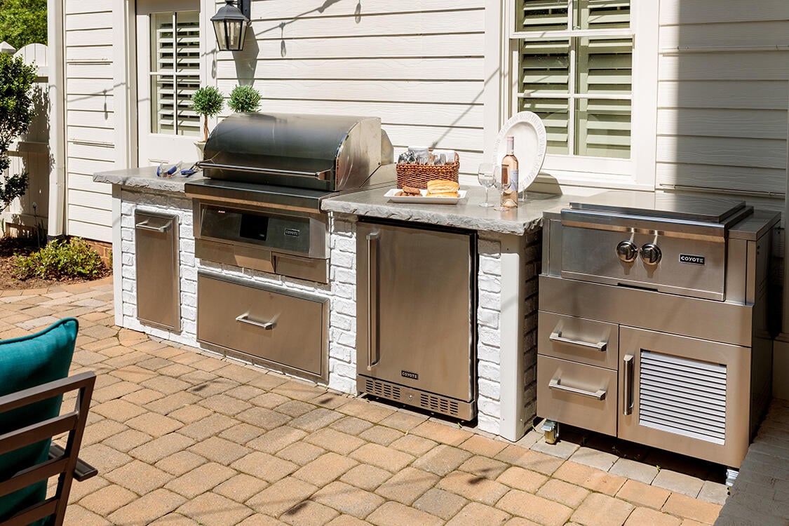

  • reclaimed-brick-outdoor-kitchen-on-patio-with-built-in-pellet-grill-30-1.jpg
Or this design . If the wood was UPVC window frames with glass replaced by T+G UPVC then they will not melt/ distort - or anything.

The toaster is not my cup of tea either but the OP has said
"I'm building a BBQ with an adjacent granite worksurface supported on brick with a pair of cupboards below, one for general storage and once for a fridge."
The BBQ will be on the left of a 3m span with the fridge on the far right. So it'll be (a) below the level of the BBQ, and also have three vertical courses of brick between, and a granite worksurface above. It'll be getting more heat from the sun than the BBQ. And as I said, I'll only have the fridge powered on the days when we're out there using it (so none this year looking at the summer we've had so far!!!)
