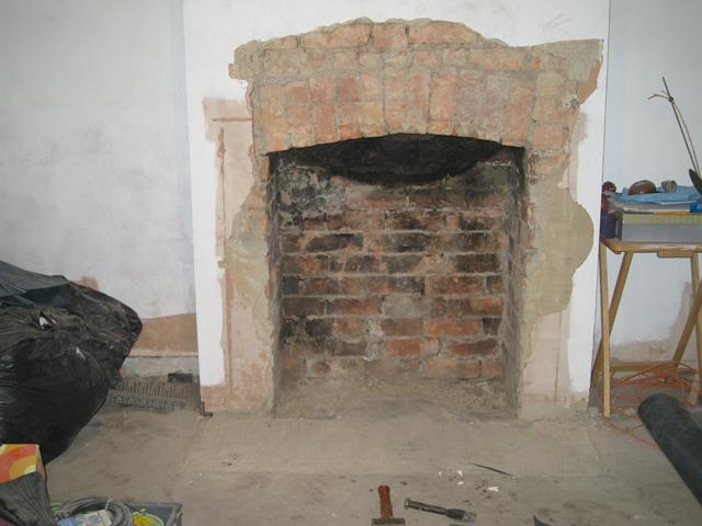

I've knocked out the old fireplace and fireback to the original brick built arch, as follows:
I'm going to install a wood burning stove and intend to render the inside of the recess (like this).
How would you recommend squaring off the arch?
I was thinking about a length of mild steel flat bar (4" x 1/2") hammered into the mortar course at each side with the void above filled with mortar.
Will the steel likely crack the render/plaster when it gets hot?
I'm reluctant to replace the arch with a lintel as it's essentially sound (though could do with stiffening as it has a small amount of give when pushed).
Suggestions are greatly appreciated.[/url]
scary - traditionally these were supported by a length of iron strap, often 3" x 3/8", in the way you describe. 4" x ½" will work but maybe remove some mortar before you hammer the steel in, gently does it 'cos of your movement. Also it ain't going to get that hot so as to cause probs to the render.
Thanks for the reply.
Would it be better to prop, knock out the arch and install a concrete lintel?
I've removed the plaster/render from the chimney breast now as it was blown, so I've got a better view of the thing.
Cheers.
Erm... I can't get 8' x 4' in the car :lol:
I'd rather render and pay for it skimmed as that matches the rest of the house.
I'm going to have to render the recess anyway, so being able to use metal bead saves me fiddling about with the edges (I think).
scary - disturb as little of the brickwork as possible, insert the strap, infill the void with masonry, fit your plaster/render beads then render/plaster. I can guarantee if you attempt to fit a concrete lintel (why bother - there are no loads) you'll loosen more than you bargined for.
OK, thanks for the advice.
I'm going to keep the arch and render the brickwork.
The strap (probably 3" x 3/8") will have to go straight across with mortar filled in above it - I'm not going to be able to bend the it into the arch.

scary - it was my understanding that you always wanted to square off and infill with masonry (as per pic of stove). Try to introduce some bits of brick into the void to support the mortar infill.
