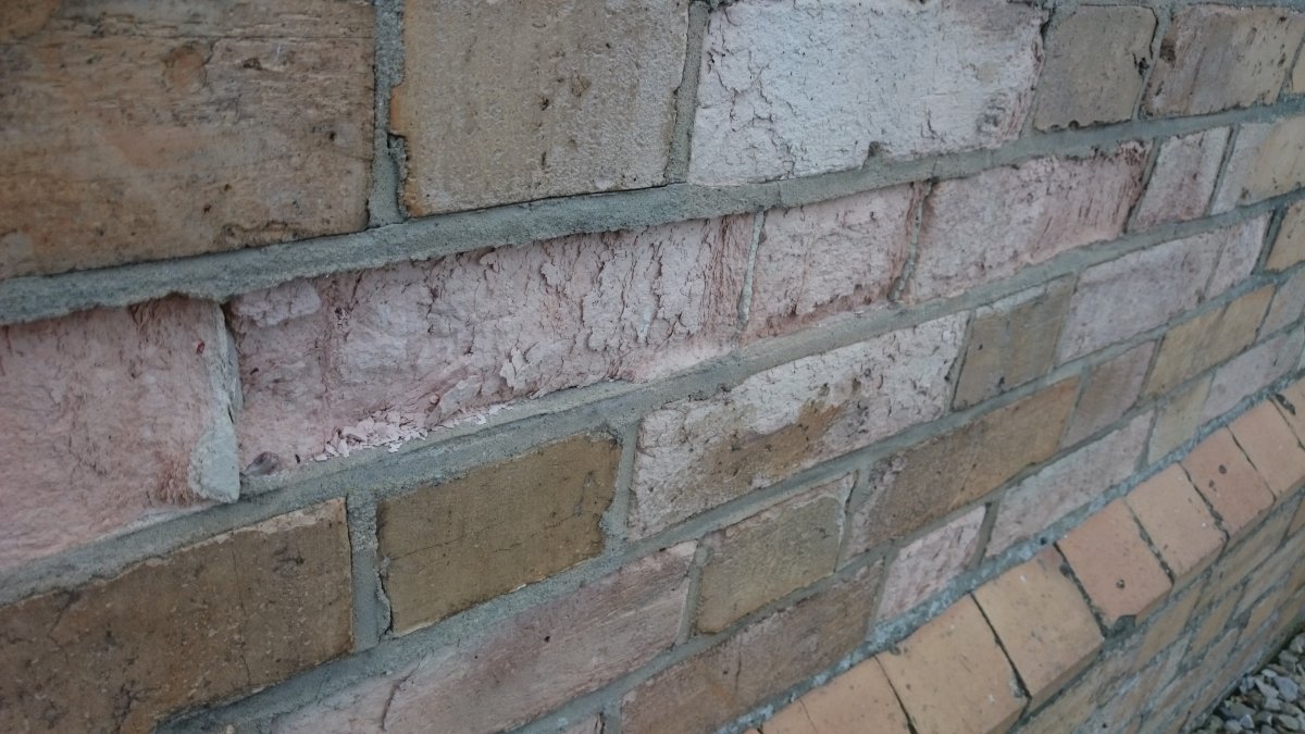

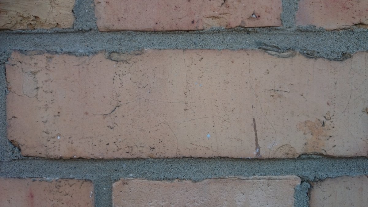

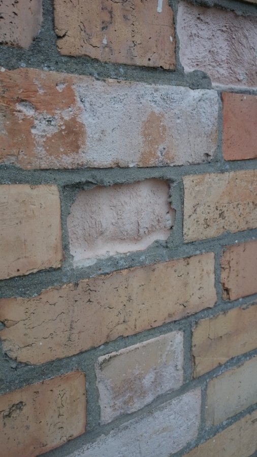

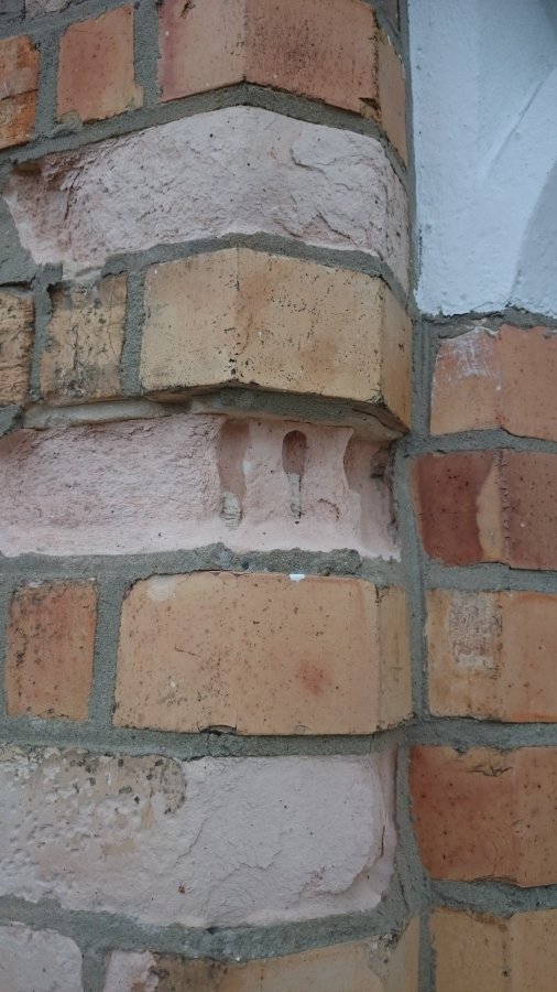

Hello,
Hoping someone can help as had no luck through other sources.
I am hoping to replace some eroded bricks from my house which was built in the 1880s. There appears to be some fluctuation in the size of the bricks but most are approx 22.5cm wide, 6.5 cm tall and 10.5cm deep. I do know they were originally made by the (long defunct) "South Western Pottery Terracotta and Brickworks" located in Poole, Dorset.
I have attached some photos in the hope that someone will be able to suggest a close match.
Thanks!
Thanks for your kind reply Woody. Yes, they are not far off but I was hoping for a more "rustic" looking brick to fit in with the character of the house. That said that kind of brick may not exist!
My grandfather had this problem once; matching some old odly-shaped bricks. So he cast his own to match, using dyed cement.
I doubt you will find a modern match, even those still making imperial sizes, especially for the special shaped bricks. Probably architectural salvage yards or a bespoke brick maker who can match old historic bricks. Either way not cheap.
