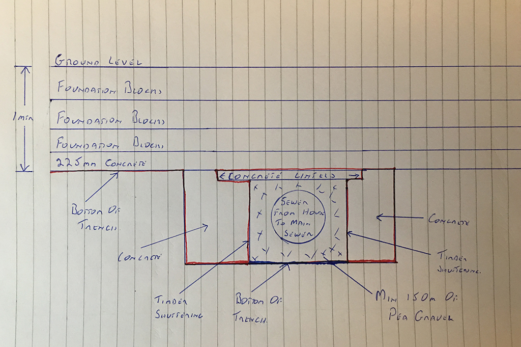

Hi Guys,
I have used an excavator to dig my trench for the footings on my extension (1m Deep) and just in the process of tidying it up by hand before pouring the specified 225mm of concrete. I knew i have a sewer pipe crossing about 300mm below the concrete footing so this will need bridging. Its on my land and not a shared feed to the main sewer which is well off my land.
Before I get the BCO in to sign off on the trench prior to pouring, i want to make sure i have done the bridging correctly.
I am thinking of doing it as per the attached picture so the whole thing can be done in one pour. Basically i would dig 350mm either side and 150mm below the pipe, put in some shuttering either side leaving a 150mm space all around the pipe and filling it with pea gravel. I would then sit concrete lintels across the shuttering with a 200mm overlap either side then pour the concrete encasing the lot in one go.
This would provide support for the lintels (200mm either side) and leave a level continuous run or concrete throughout the trench with the lintels encased inside.

The whole length of that strip foundation on the side of the extension that goes over that pipe, needs to be at a depth which is level with or below the bottom of that drain. Preferably the strip goes under the pipe and you bridge over it in the blockwork
You can't just drop a section like you have done and then bridge over the pipe.
Plus there needs to be clearance (50mm or so) above the pipe to allow for settlement.
Oh, and you would normally have engineering bricks starting at 225mm (3 course) below ground level on the external skin - inside skin can be blocks as per your drawing.
Given the run on that side of the extension is about 9m long, surely I can step down the foundation on either side of the pipe, keeping the stepped down section clear of thd 45 degree line either side of thd pipe? Like the pic below?

It would be better to have at least 2-3m of foundation at the lower level, but if the pipe is nearer to one end then half the strip would normally be at the lower level.
There are several factors to influence all this and you really should be getting the advice from whoever is designing the extension, and remember that building control need to inspect the trench before the concrete is poured.

Also make sure the base of the trench is flat and any step really is a step, to stop any risk of things sliding down hill.
