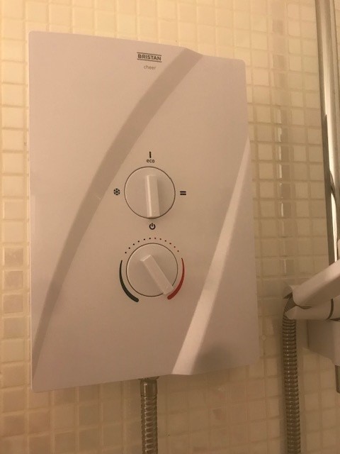

hi just wanted some info,
our bristan shower seems to not get hot enough when showering around this time of year (winter) we have the dial all the way round to red and its nowhere near as hot as it should be, in the last 2 years we have had a new boiler fitted, a combi boiler, with the hot water taps and heating works perfect and is red hot, apart from the shower.
anyone got any info that may be of help please. Thanks!

Show us a picture of the mixer.
You could also try a flow reducer or a smaller shower head. Some water companies offer them as water saving aids.
this is the shower.
It appears to be an electric shower, not a mixer.

If you already have a combi boiler, it will typically have around three times the power of an electric shower (around 30kW compared to around 10kW) so it will give a better shower.
You could have a mixer shower plumbed into the bathroom hot and cold pipes.
Test the flow and temperature at the bath taps. Fill a bucket, time it, calculate litres per minute of fully hot water. It is likely to be a lot more than your electric shower delivers.
It can be useful to have an electric shower as a standby in case your boiler breaks down.
