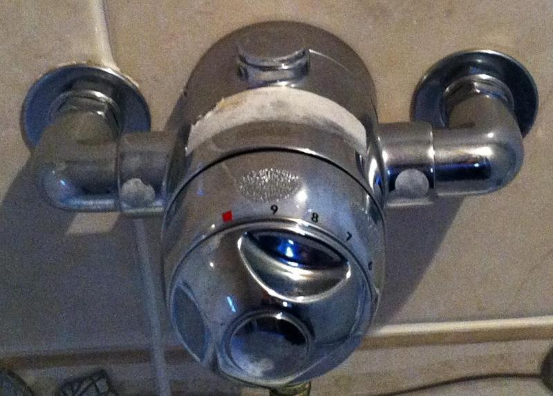

Hi
I have a Bristan shower that dribbles a lot after it is turned off. I think it may be a Bristan Omega, but I'm not sure - here is a photo of it:
Can anyone confirm what model this is? Also I can't get the cover off the front to get at the cartridge. Does it screw off or should I try to pry it off?
David[/img]
You will need to fit a new cartridge and to remove it you will need to remove the small circle on the front of the shower to access a screw (me thinks)
Just to make sure does it dribble from the shower head and does it ever stop? If it does stop after 20-30 seconds then you could try descaling the shower head, do this first as it is much cheaper and easier to do.
Remove head and place in a container full of lime scale remover so that the head is completely submerged.
