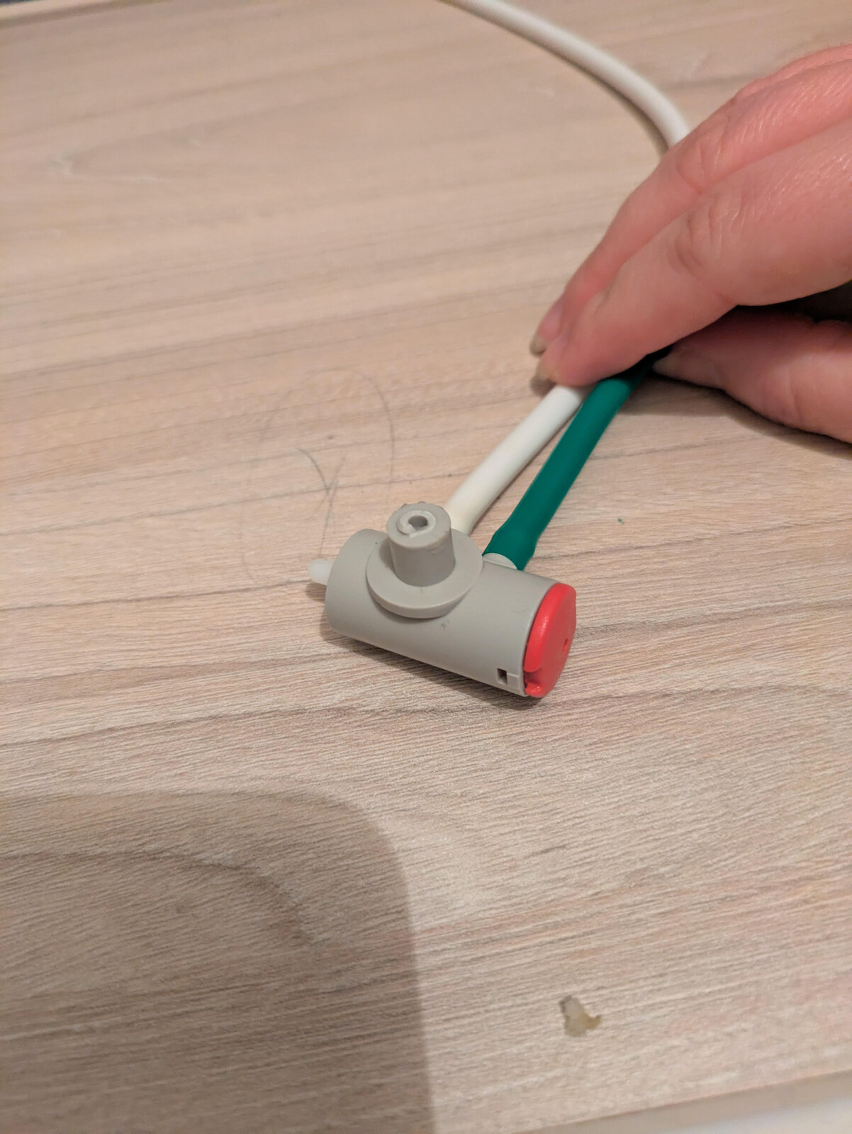

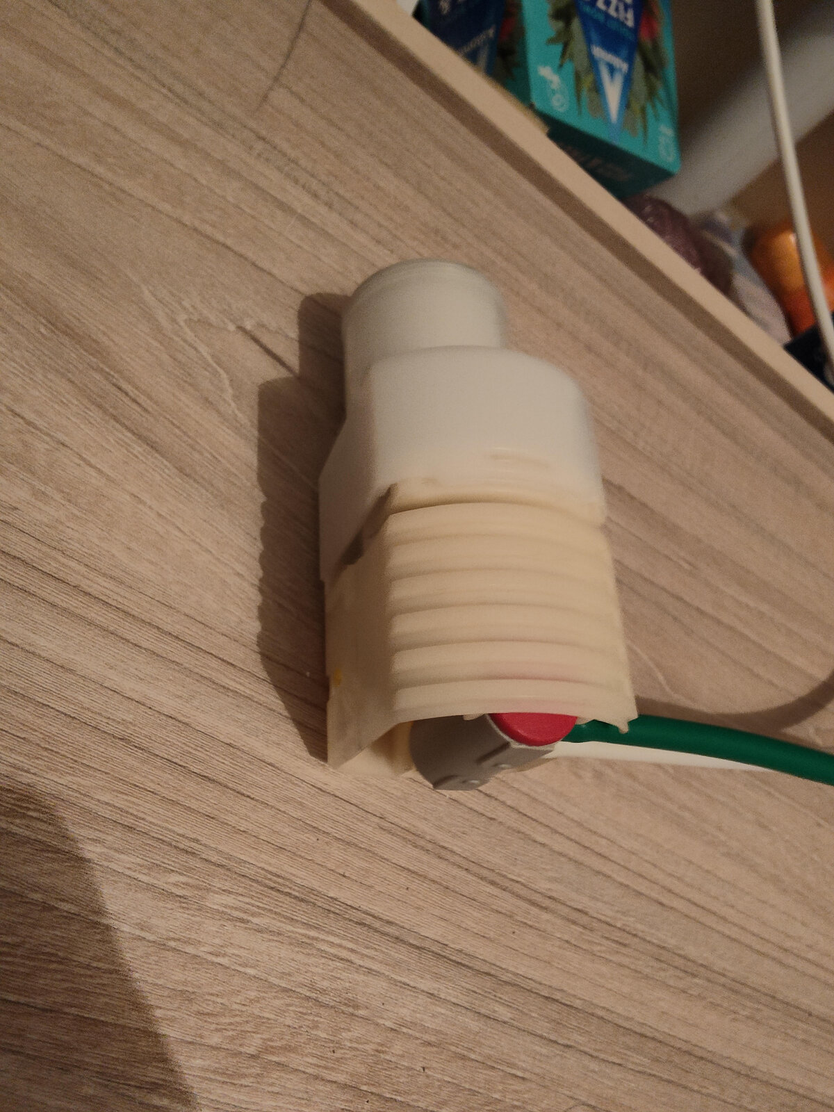

Hello, my toilet flush button in integrated toilet cistern is broke and I cannot find replacement anywhere. Does anyone possibly know if I can replace it with different button? It is the one with little pump that has 2 cables coming out of it. I have attached images.
Screwfix do replacement buttons @ND specify the hole size which might help. Otherwise replace the whole flush valve, its not much more expensive
