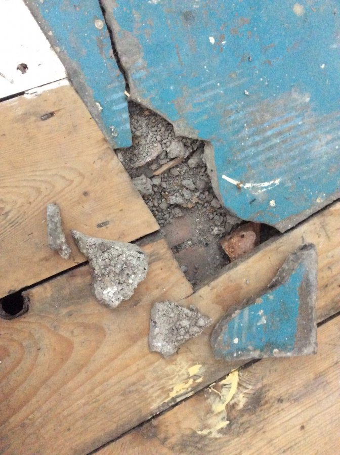

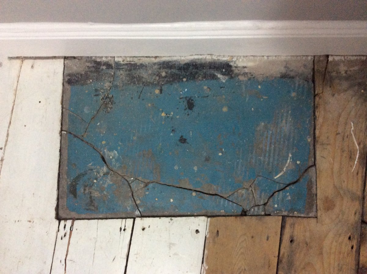

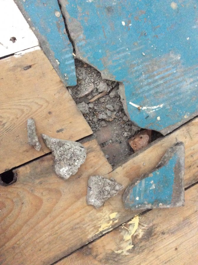

where a fireplace has been blocked up in a first floor bedroom, there is a hearth set into the floorboards which is breaking up. This appears to be a screed of something, around 1" thick, laid over what is now rubble in the gap underneath. I would like to repair this and paint over (am painting the floorboards) but not sure how to go about it
Such hearths were usually made from a single stone hearth piece.
Your hearth could be a screed of sand & cement - lift some of the pieces out & post a pic of whats underneath the surface layer?

There's no way to "repair" the broken stuff, neither should you want to "repair" it - its too fragile.

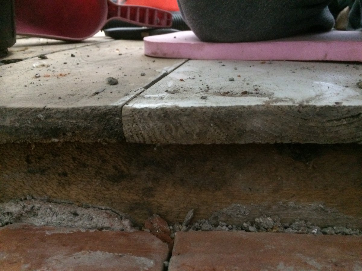

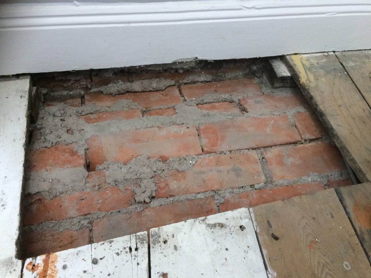

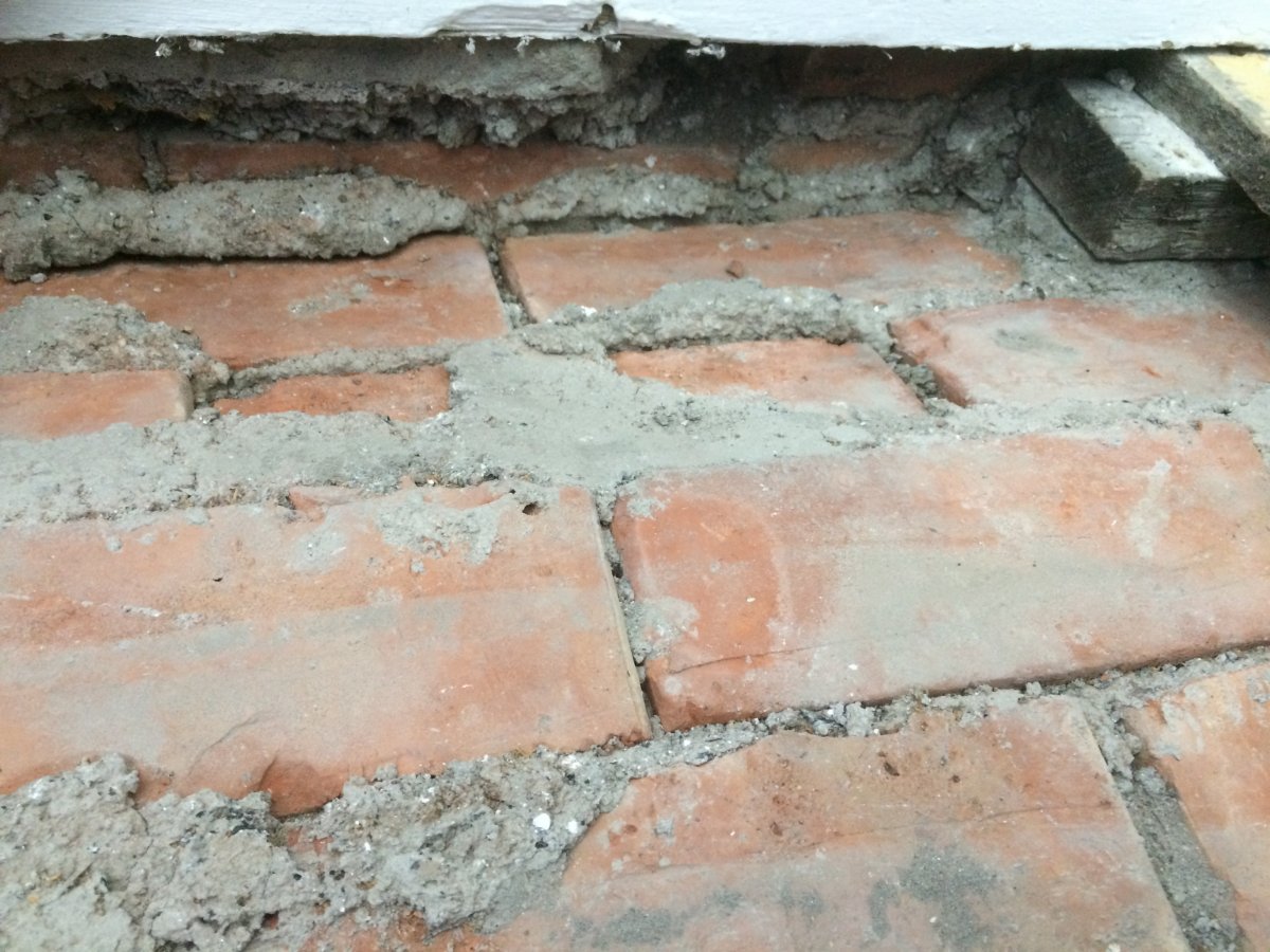

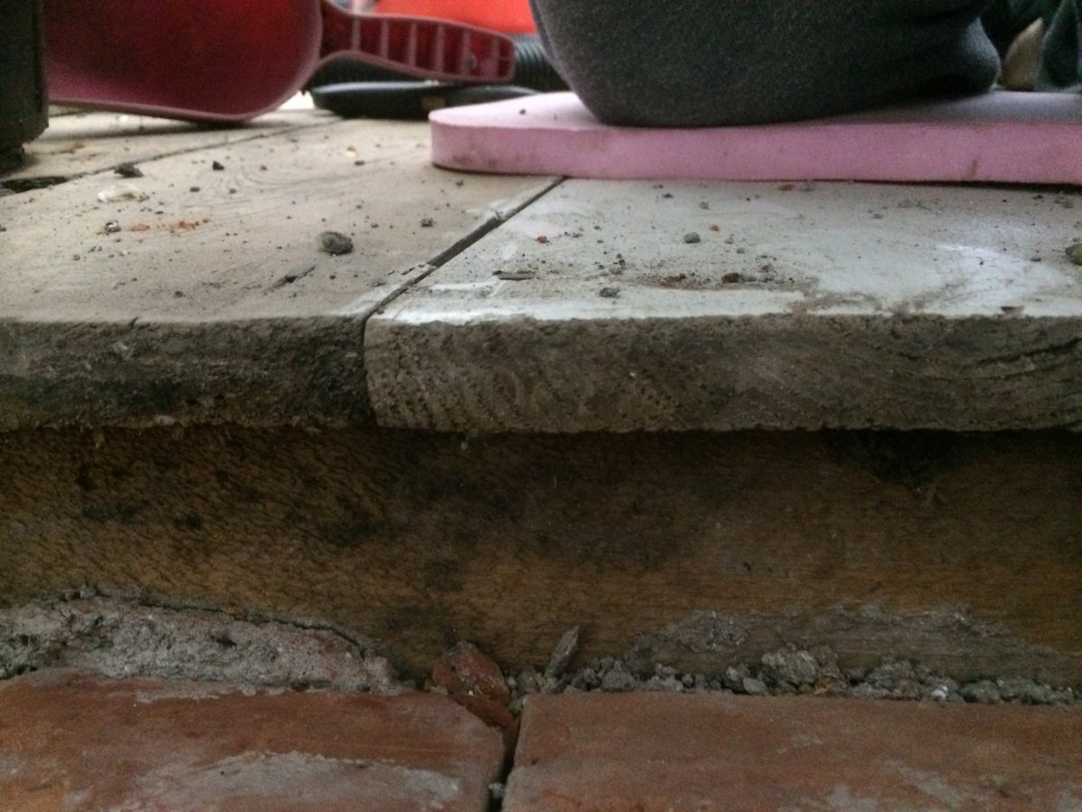

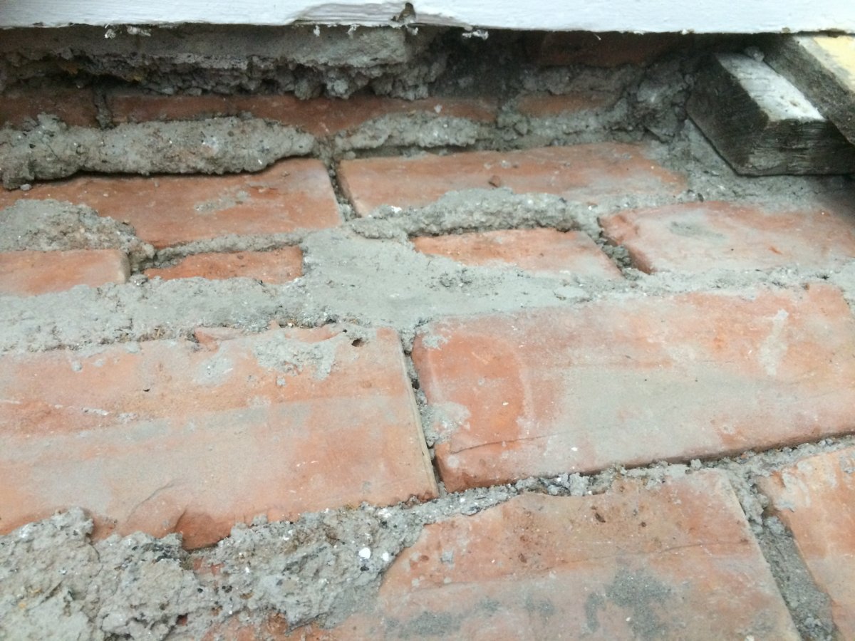

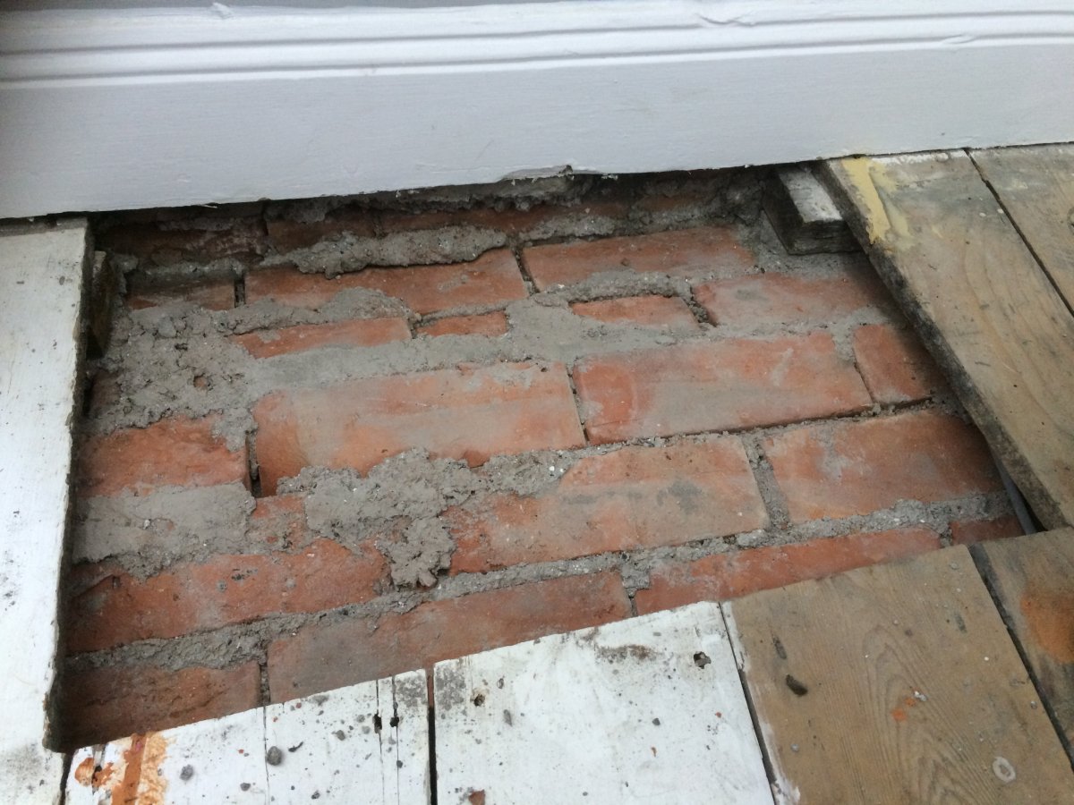

Ok, done:
Bricks, not level. Joist just under the boards at the front, cut against the chimney breast. Bricks drop away by around 2" front and rear
Thanks for the new pics.
Leave the bricks alone.
You now have alternatives:
1. you can drive a few long screws or nails into the surrounding joist box (its known as trimming) leaving them sticking out.
You can then fill with a semi-dry concrete mix and smooth off the surface.
2. First, firmly fix a piece of say 2" x 4" across, almost below the skirting - this will act as a bearer for the new T&G boards.
You could then fix some 2" x 4" to the trimming joists - the 2" x 4" will act as support to pick up new T&G flooring.
Alternatively you could cut back the in-place flooring to sit half-way on the trimming joists - this will give bearing for the new flooring to be fixed to.
To do this first remove all nails and screws in the old boards.
Pilot hole your new screw holes to prevent splitting.
Thanks - I think I will go for the second choice, I'm happier with wood than cement!
