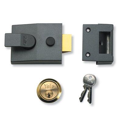

I came home 10 minutes ago, closed the door behind me, and now I can't open it again. The Yale lock seems to be broken, and I can't slide the bit that goes across back into the door (I have NO idea what it's called, sorry - English isn't my first language), no matter what I do.
I think my lock type is this type (P89?), at least the part that's on the door itself looks like the part of the left:
The black button type thing seems jammed, and the bit with the Yale logo on it starts feeling loose when I try and push it up or down.
I'd gladly remove the lock entirely, but there are no screws that I can see, it seems melded to the door - how do I get it off the door (I just need to get off one of the parts, really)????
What should I do?

you may have double locked it when you took the key out can you go outside another way and try unlocking from the outside keeping in mind iff it dosent work try moving the internal snib and try again incase its locked from the inside as well

no, I can't go outside. I can't open the door! The bit that normally slides into the lock, won't slide in. :(

can you phone someone with a key to your door or pass the key to someone else as you have double locked the bolt when you took the key out so someone will have to unlock it from the outside
the bolt had to force the keep on the frame away to close thats why it was tight
and dont forget iff they cannot open from the outside to move the sniblock on the inside and get them to try again
Yay! That did work! Thank you so much!!!!!!
