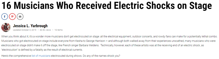

ooooh - lots of them (but not all dead), even with the very first Google hit (click here) ...
Kind Regards, John
Edit: in fact, looking briefly at more of the Google hits, it's clear that umpteen people have been reported as having killed by electric guitars over the years (including at least some others 'in baths')

While I don't know that you could blame his tube amplifier, Keith Relf of the Yardbirds was fatally electrocuted while playing at his home on 14 May 1976. The cause of death was blamed on an improper ground. Ace Frehley of KISS was nearly killed at a show in a similar fashion.

"flame-shooting chastity belt" is hardly a guitar. The list seems to include microphones, ear pieces, and to be frank I was surprised there were so many with what one would have expected were extra low voltage devices, clearly from reading the list I am wrong. Glad I am not a rock star.
