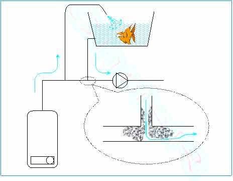

It's pumping over because there's a (partial) blockage in the circuit between the vent and the feed. It usually starts off at the bottom of the feed pipe and grows. Often you can clear it by removing the pump, and poking a drain spring back up the pipe. Won't go round an elbow though. You can also cut the feed pipe and poke a drain spring down there.
I did a pic, some time ago...
If the blockage is soft, red rust (magnet won't stick) you stand a chance of shifting it with the method I put in one of the faqs - Blocked Feed Pipe - I think it was..
chris r has got it bang on and with a nice picture to boot , also i would add the distance between the vent and the feed should be a maximum of 6 inch . not 12 inch .. cheers
