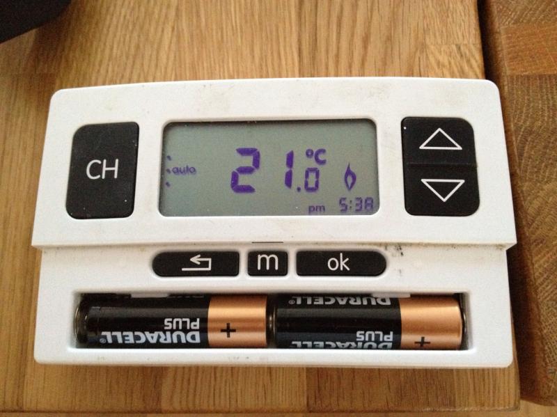

It is controlled with a wireless controller / thermostat:

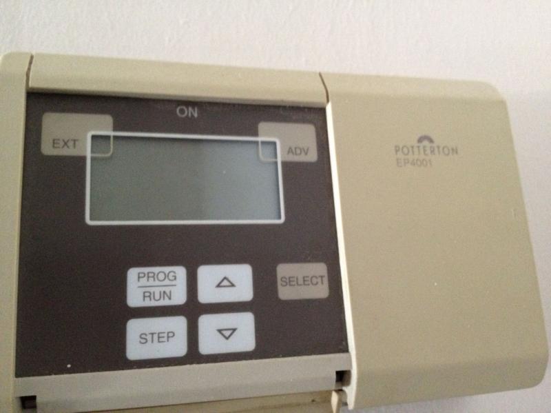

There is another control panel on the wall that wasn't connected. Today I connected it to the mains and the controller powers up and works (it's a Potterton EP4001):
The Potterton controller has the ability to set different heating times for the weekend, something which the wireless controller doesn't have.

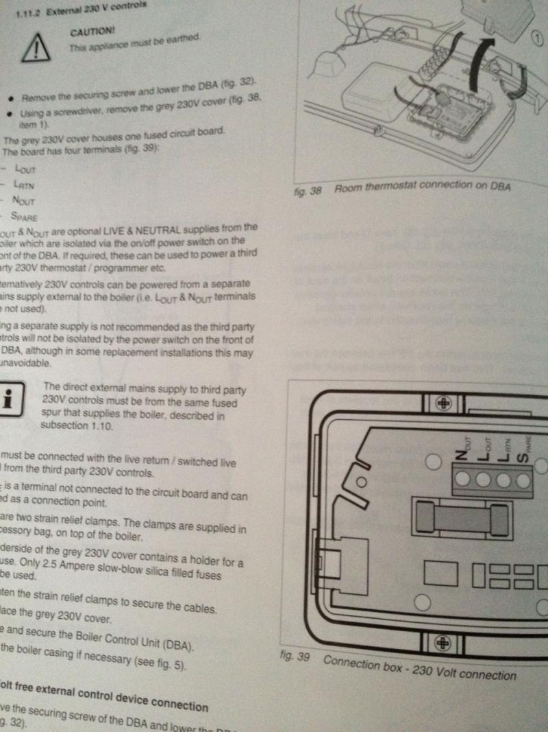

The boiler side of the wireless controller looks like it just goes into the Thermostat Terminals (2 wires). Reading the instructions of the boiler it looks like you can take Live/Neutral out of the boiler on a terminal block and run them to a third party controller (i.e. the Potterton).
I presume (please correct me if I'm wrong) that the Potterton will simply switch the Live and I can route this back into the "Live Return" terminal of the Boiler:

Am I correct about my assumptions that I can wire the Boiler Third party Live and Neutral to my Potterton and that my Potterton is basically just a switch and I'll wire a Live Return back to my boiler.
Assuming I do that, what will happen to my 'wireless' thermostat? I presume it will continue to act as a thermostat but will that work in tandem with the Potterton or conflict with it or be ignored once the Potterton is connected in??
