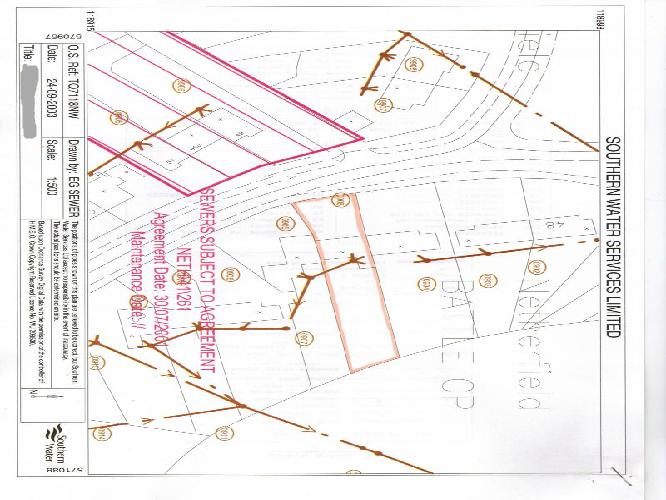

Heres an image of the sewer map. It looks to me that I'm at the head end, I just can't bare to part with £867 for a pen pusher to sign off something!
If my understanding is correct, from your description you don't have a public sewer - it only becomes public at the point where another property joins it. Why do you believe that you need SWs permission?

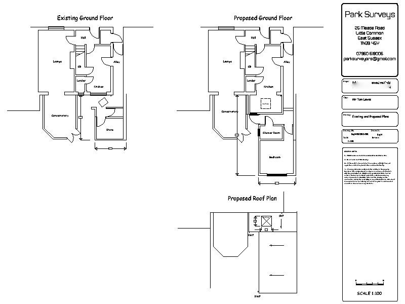

I cant really move it out of the footprint of the extension as there isn't really space to plus i'm adding a toilet and shower downstairs. I'll try and upload a pic of the plans so you can see.
The little rectangle outside the kitchen window is the manhole cover, sewer runs off diagonally to the bottom left. In order to keep the build cost down it has been proposed to building control that the manhole stays where it is but is replaced with a double skinned lockable sealed cover.
According to Ofwat, the bit of sewer on your land is a Drain, and therefore your responsibility. It only becomes a public sewer when it enters the next door property.
Also see Transfer of Private Sewers
It could be that SW accepted responsibility for the complete sewer, including your part, when the estate was built. Ask to see a copy of the Agreement mentioned in the sewer plan.
