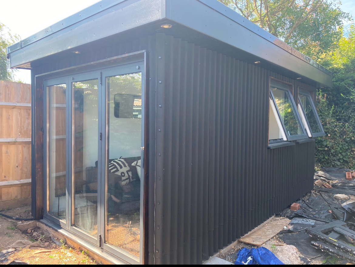

Building off a concrete slab
Was fixed down, but only by a few concrete screw/bolts here and there.
I used corroline corrugated sheets. Not for everyone but I love how it looks and surprisingly seems an amazing acoustic barrier.
I did a thread on it here with photos at each stage https://www.diynot.com/diy/threads/another-man-cave-garden-room.594447/

Still trying to get my head around how to tackle building off the slab.. Is your timber frame sitting in the blue bricks? What are the blocks I can see in photo? Ta!

It’s built off the blue bricks, yeah.
You can probably ignore the blocks for yours - they’re a specific detail of mine where part of it is a retaining wall due to higher ground on one side. I did a separate external dense block leaf with a cavity, plinth bricks and flashed the cladding over it.
I'd expect that building regulations should specify what should be done to anchor a timber-framed house. I'd download them (free) and have a read for yourself rather than copying whatever others decided.
