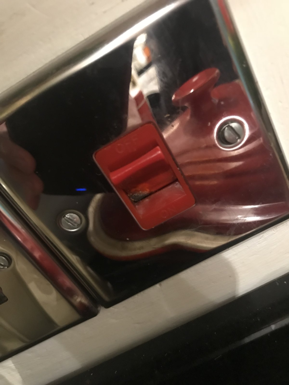

Looking for some advice
I was using my hob when just after I could smell burning, I went to switch it off on the wall, however the switch was solid and wouldn’t move, I had to really force it up and noticed the switch has started to melt and turn black
Any idea of what the cause can be?
Probably a loose connection inside. However it will now need replacing along with any damaged cable involved.
Loose connection behind the socket? Could a faulty hob cause it?
That plug was wired in years ago, the TV always flickered everytime you switched the hob on and off but other than that it’s been fine
Are you looking for someone to tell you something different? Up to you...
The red switch looks like its made by Varilight, there a budget brand, it may be just worn out due to switching quite a high load appliance

Screw connections for hobs and showers need to be checked and tightened regularly, they just gradually loosen due to the heating and cooling.
You should have it checked at the consumer unit end as well when you get that one replaced.
