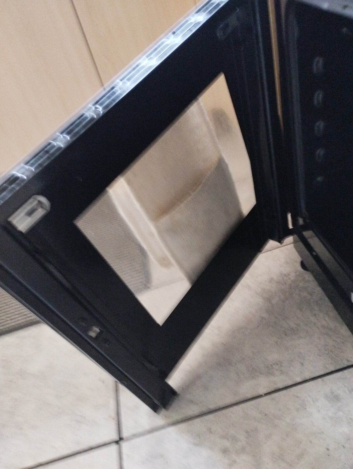

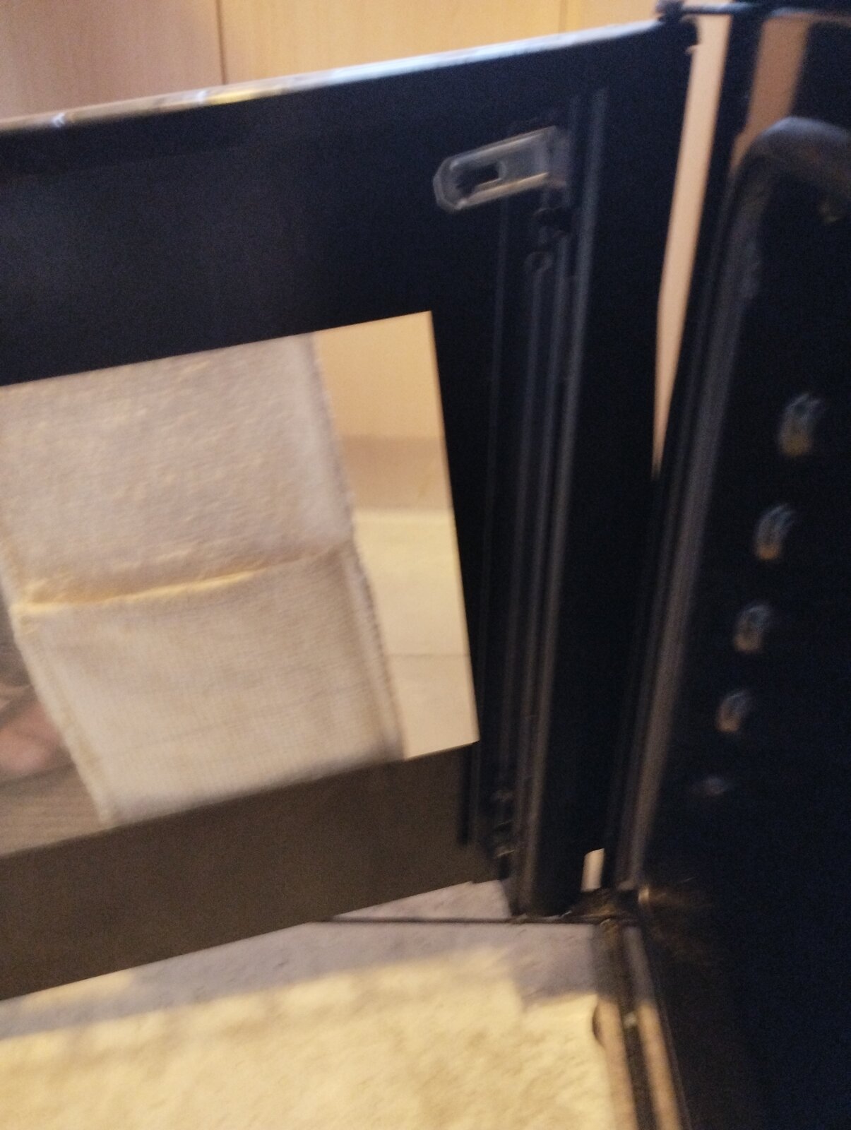

Bush AG56TB door fallen off
Tried for hours to get the door back on, can get the inner glass label in, but it's not secure and keeps falling out again
Need some help how to refit this
The video was no help for my problem the vertical and horizontal part if the door on the oven side have separated, can't see how to get it back together
Have to be very careful opening and closing door as the door assembly just slides and the glass falls out
It is a bit difficult to tell from your description -
But it looks like the front panel glass has separated from the door frame, on the hinge side.
The frame is usually bonded to the glass - the only mechanical fixing point is probably a screw going through the glass and into the handle.
The frame may need re-bonding to the glass - and I'm afraid I don't know if this is a DIY'able job.
Others may have a better idea.
I removed the door, cleaned up surfaces with surgical spirit and used epoxy resin, so far so good.....the glued part doesn't get hot only warm si should be ok
