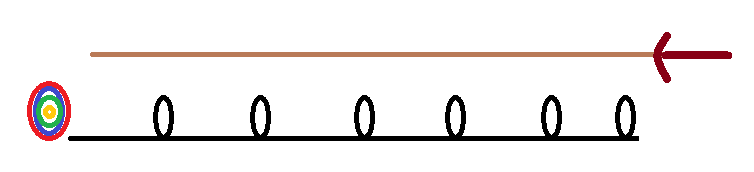

Another version I made: The wand was a 15mm copper pipe about 1200mm long 'lance' which had to be passed through a row of rings without touching them to push the target (an old CD with coincentric rings design on a microswitch) at the end.
It has to reach of course which my quick sketch may not
