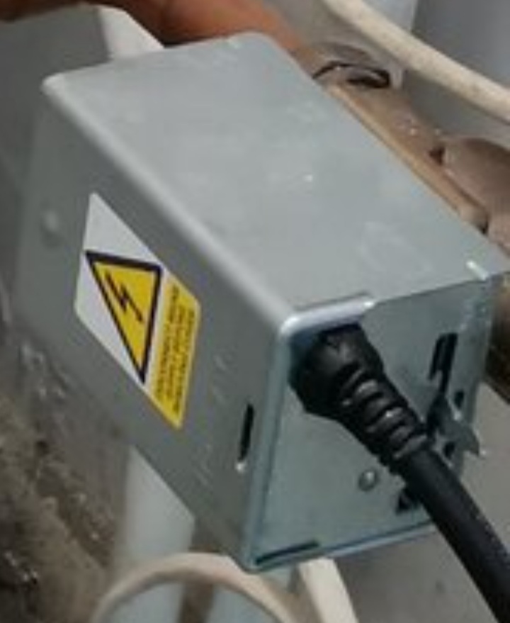

It's all in the wiring , there are 3 switching wires in the Nest, CH on, Hot Water on, Hot Water off, only a Y plan would use all that. Oh, and another one that's used the earth cable without changing the colouring, that's so not cricket.
