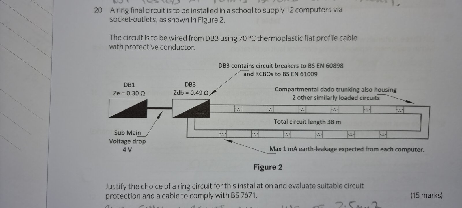

C&G 8202 past exam paper question. Cable calc.

Here's the question:

Why a ring?
Why 32A?
Why grouping?

Further to this question, seeing as we're all looking at it here, they ask about earth leakage and leaky PC power suppies.
What do they mean "high integrity earth"? If the ring has its own breaker and is an independant circuit, the earth is going to be 'high integrity' anyway? Or is there some other wiring required, such as a thicker CPC?
