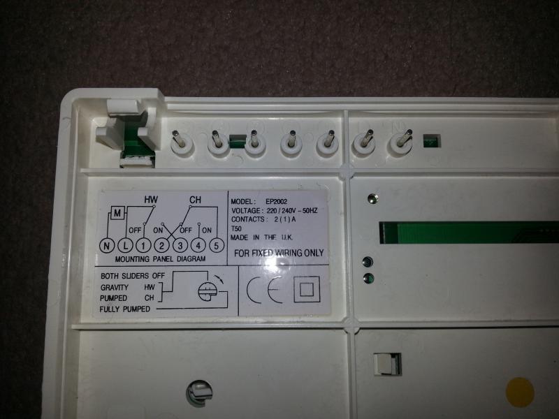

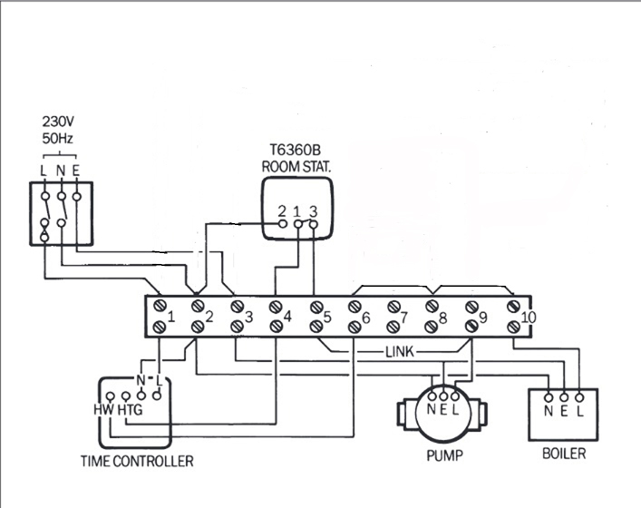

Hi all, l think l have a c-plan h e acting system but without a room thermostat, l need to change the programmer for a newer model, Potterton ep2000 for a Honeywell st9400.
Can this be done without a thermostat, and would a standard c plan wiring diagram be OK to use just bypass the thermostat
Thanks Chris

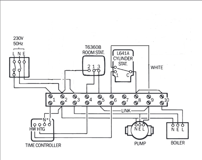

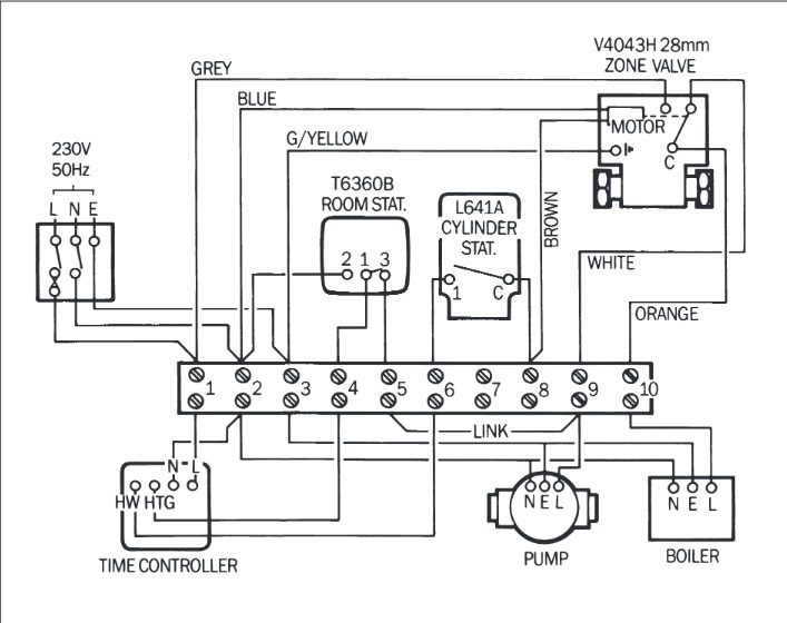

There is really no standard C plan as it has changed over time, C-Plan_old2.jpg the very old had no pumped domestic hot water or cylinder thermostat, C-Plan_old.jpg then the cylinder thermostat was added, and C-Plan.jpg then a motorised valve, central heating in the early days was to warm house before you got up and lit the fire, it was just a back ground heat, in all three versions yes the room thermostat can be linked out, and there was only a tank thermostat on the version with a motorised valve, the programmers had switches and mechanical links to swap from 10 to 16 programs, in essence without the motorised valve you can't switch off the domestic hot water, and some old boilers needed the permanent thermosyphon connection to allow them to cool as there was no run on.
However fitting a 16 option instead of a 10 option did not harm, but even if you select central heating only you still get central heating and domestic hot water.
So yes you can use the Honeywell programmer,

looking at the picture it seems there is a turn unit that will limit options but even if not set it will do no harm, just you can't have central heating without hot water.

A C-plan with cylinder stat and motorized valve was the norm in the late 1980's, and probaby much earlier, as there's no point having one without the other. It defeats the whole object of a C-Plan, which is to have controllable 'gravity' HW.

The second C plan I show has both the NO and NC contacts used on the tank thermostat, I have wired the Nest heat link in the same way, having no tank thermostat, the room thermostat with Nest allows me to both set the hall temperature and select when if the central heating is not running that the DHW is heated, and it also sends a signal to my TRV heads so they are at the same temperature as the Nest wall thermostat. There must be hidden behind my plaster board some where a joint, as wires start as red, yellow, blue in house but at the boiler locations are brown, black, grey, and one wire is open circuit. It did take 230 volt from house to boiler, but today it only has 24 volt on it, so not really worried about where that joint is.
