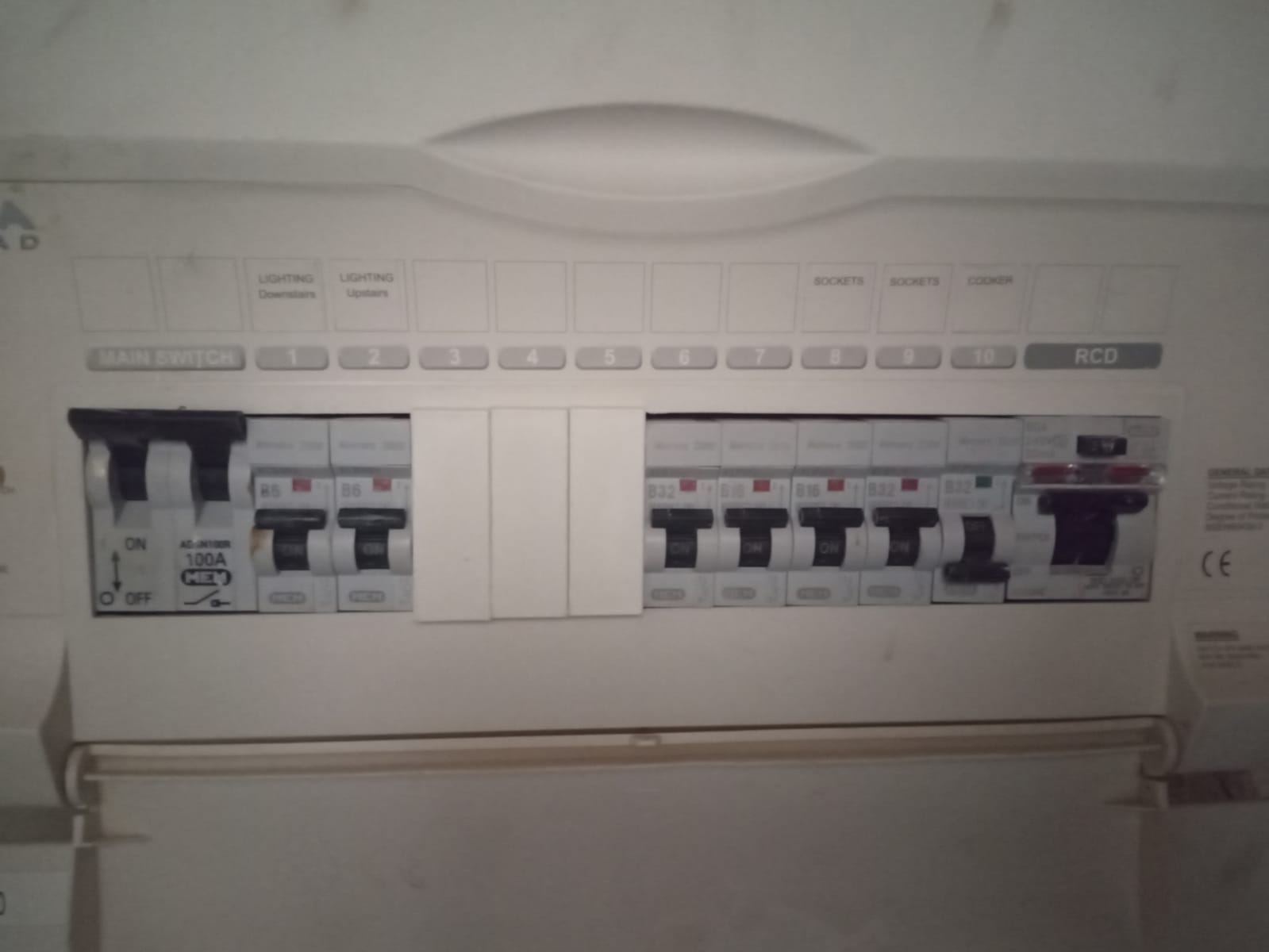

Cable entry into Consumer unit
Yes, but not Eaton/MEM. And the lighting busbars are on the unprotected busbar direct from the main switch.
Would be worth seeing a pic of the whole thing. Even better to see inside.

Here you go

That is exactly how my Square D was designed:
What you describe/illustrate appears to be one of the variants of how a 'high integrity' CU can be configured. However, if that's what the OP has, it would still presumably be the case that, as TTC suggested, the two lighting circuits would be without RCD protection.
Kind Regards, John
Kind Regards, John
Yes but let's not forget lighting circuits were amongst the last to require RCD protection, no idea of correct date.

I think that started with the initial version of 18th, in 2018. However, as plugwash has observed, the requirement for RCD protection of buried cables (almost inevitable in any lighting installation, given switches) was earlier than that.
However, I think what we are probably all agreed about is that, unless it was installed by a total clown, that CU was installed an awful lot more than 4 years ago - so who knows what regs applied at the time?!
Kind Regards, John
Well, there could theoretically be two RCDs if both were connected to the main switch by cables (as in a 'high integrity' CU), rather than one being connected via a little busbar - but, as you imply, only an idiot would "do it like that" :)

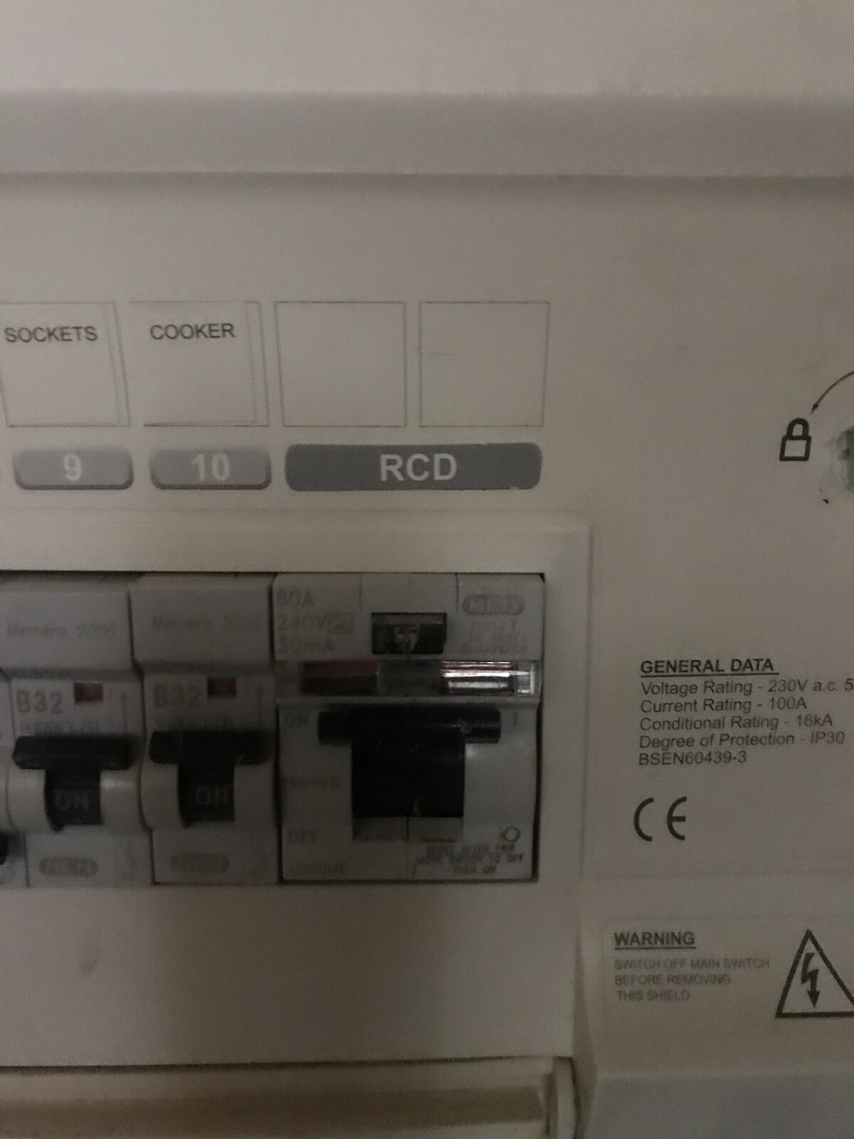

Presumably this would require three separate neutral bars?
That is an RCCB - a Residual Current Circuit Breaker - which is an RCD - a Residual Current Device - as are RCBOs - a Residual Current Circuit Breaker with Overload protection.
I’ve seen some garage CU’s that only have an RCD (and some MCB’s). There’s no main switch.
In that situation, the RCD is ostensibly the main switch?
Indeed - and that's what 'high integrity' CUs have. There has to be a neutral bar for circuits protected by each RCD and a neutral bar for circuits not protected by any RCD - so, yes, if there are two RCDs and also some non-RCD (maybe individually RCBO-protected circuits, then there needs to be three neutral bars (which, as said, is what 'high integrity' CUs have.
