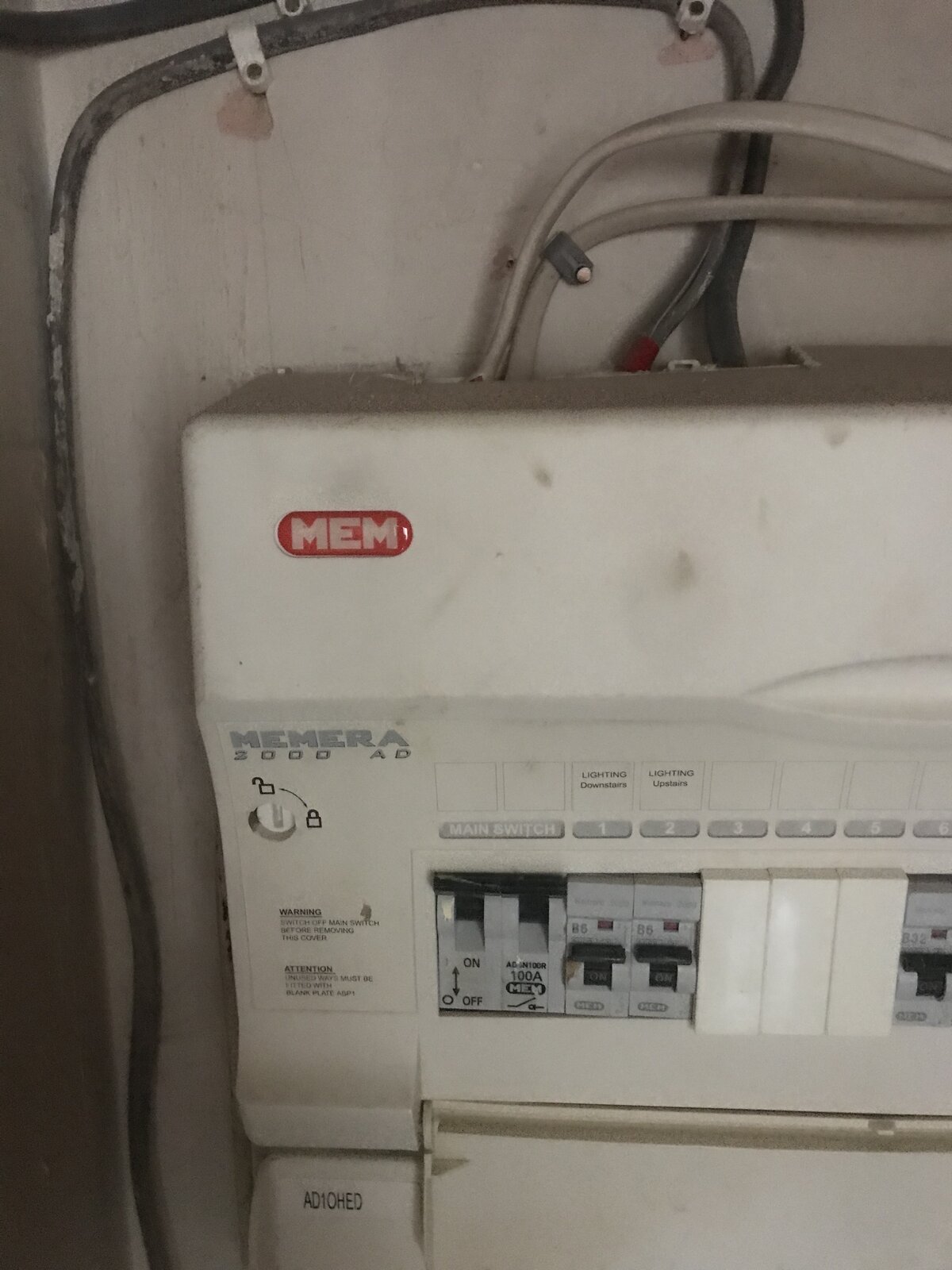

Was at my sister in laws yesterday and like you do, asked to take a look at her consumer unit. This was installed 4 years ago by an “electrician” she tells me. It’s under the stairs.
Am I wrong to think that there are so many instances of similar work and have passed all the required checks, etc. It has a gaping hole where those cables are entering.
That looks a lot more than 4 years old! Did she get an installation certificate and a building regulations completion certificate?
The holes are too big and do not meet the IP requirements. Did he/she cut them with their teeth??
To meet requirements they should be tight around the cables. A squirt of silicone would make them compliant.
But there may be more horrors to consider....
For starters, and just at a first glance, the two lighting circuits do not appear to be RCD-protected. 4 years ago was the time of the17th edition and from that point most domestic installations required RCD protection on all circuits due to cable depth requirements.
Is it possible that the MCB’s next to the main switch are actually on the busbar connected to the RCD but someone has decided to leave some of the blanks midway?
Not at all likely. It’s possible, but that would put all circuits on one RCD (not correct) and you wouldn’t ever do it like that. It’s set up as the way CUs were installed in 16th edition and that makes that board being installed between 1992 and 2008.
That’s assuming whoever did that complied with the regs in force at the time and didn’t just buy a second hand board off eBay and charge for a new one.
As Jonny Nash said
There are more questions than answers.
Well, there could theoretically be two RCDs if both were connected to the main switch by cables (as in a 'high integrity' CU), rather than one being connected via a little busbar - but, as you imply, only an idiot would "do it like that" :-)

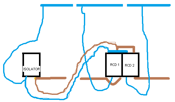

That is exactly how my Square D was designed:
Main isolator on the left, From there:
Busbar heading right for MCB's, and
Pair of tails to: RCD and short piece of 2P busbar to 2nd RCD. First RCD's 'load' busbar headed left for MCB's & 2nd RCD's 'load' busbar headed right for MCB's.
3 Neutral leads to appropriate neutral bars of course. IIRC the busbar was supplied in a single piece to cut to appropeiate lengths
Something like this:
