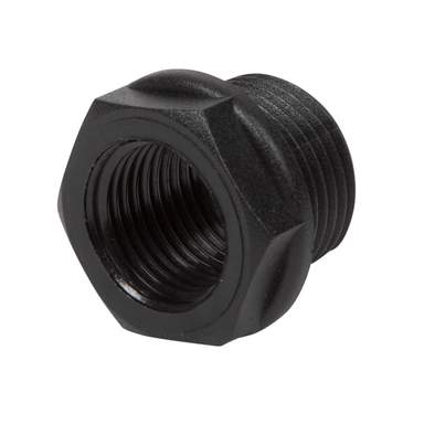

I need to feed a couple of small diameter cables (one 230V, the other 12V) into an IP55 enclosure. The cables ODs are too small for M20 glands, but M12 glands would do. Problem is that I can't find any IP55 enclosures of the right size that have anything smaller than M20 knock-outs and I don't want to try drilling my own M12 holes as (1) I don't have a suitable drill anyway and so (2) I'm reluctant to risk splitting the box.
I've come across M20/M16 reducers (which seem to cost even more than the complete glands!), but not any M20/M12 - do they exist anywhere please? If not, any other suggestions on how best to do this please?
you could increase the cable diameter by over sleeving a section with heat shrink a couple or more times
edit cef do a m20 t0 m16 plastic reducer for 58p

Thanks for the link to CEF - maybe a good compromise will be a couple of those with a couple of M16 glands .
If the cable is just under the size for the M20 then the M16 should work well.

If you;re going to CEF; simply ask for stuffing glands with a small hole. I've regularly sourced 20mm glands for 3mm cable from most wholesalers.
Thanks for the advice.
Space constraints suggest that the IP55 enclosure may have to be mounted with the long axis vertical/ That's not a problem except that the 'bottom' end only has one M20 knock-out for the two cables coming up from below.
My thought therefore is to fit a female M20 conduit adaptor and a short length of 20mm conduit going downwards (both of which I have anyway), then run both cables up the conduit with a divider between them (to separate the 230V and 12V SELV) and put a nice large plug of silicone sealer into the top end of the conduit. That ought to be adequate (?) and avoids the need to source stuffing glands and find a replacement box with 2 x knock-outs in the end. Any possible issues?
