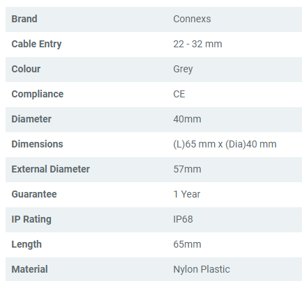

There are big ones out there, but you would probably then have to do something to deal with the fact that, if it is big enough for the plug to go through, it will be far too bit to seal onto the cable. For example, this 40mm one from CEF (click here) - which, as you can see, is said to have a 'cable entry' of 22 - 32mm.

Thanks John...but yes, it looks like that's only suitable for 22-32mm canoe...cat6 is about 6mm!
Yes, but that's a problem you will inevitably have - if a gland is big enough for the plug to go through, it almost certainly will be too big to tighten/seal onto the cable - so you'll have to 'seal' it somehow yourself - even if only with silicone.
