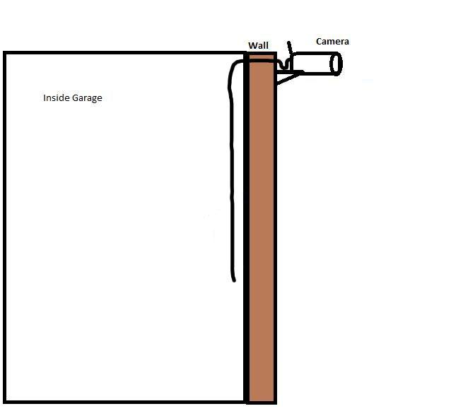

Conduit cable exit
Does the gland screw into the thread then?
Yes.
I was planning on using plastic conduit,
Ah....
As I'm pretty sure the plastic U box's don't have thread.
They don't.
You might be able to use a female adapter fixed to the box via a short length of conduit - a gland would probably screw into that.
If you don't want to use metal, why not put (e.g.) a Wiska box at high level, cables entering the bottom, one from the camera cable through a gland and the one going into the garage in flexi conduit, again with a drip loop, but entering the wall at high level, not running down it?

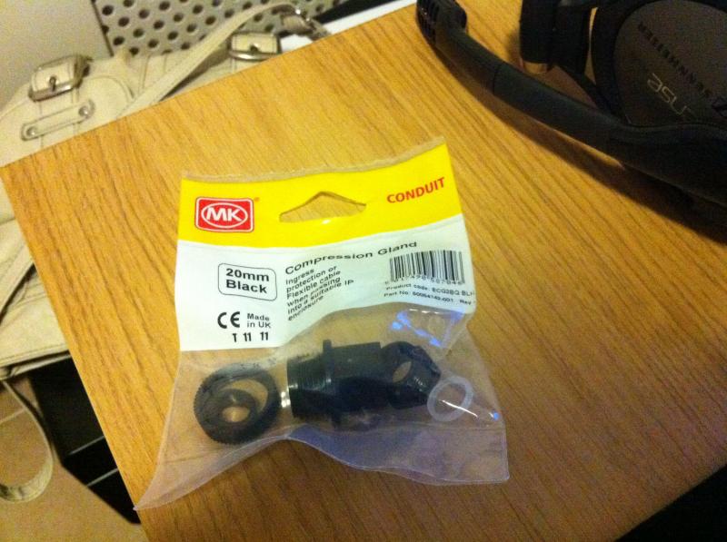

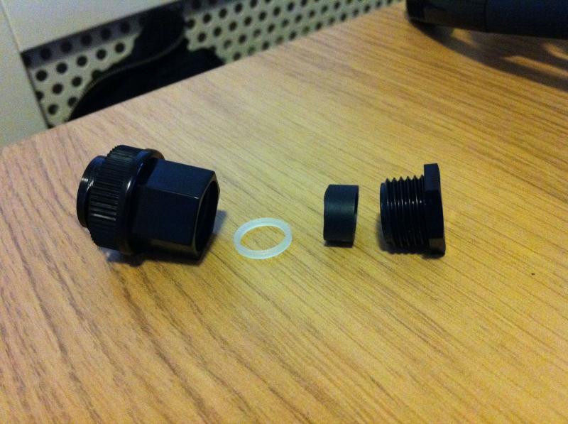

I have picked up a compression gland, and wondering how to use it correctly.
Does the little plastic ring go inside first, then the rubber seal on top, then screw the 2nd half in tight to make the compressed joint?

It goes together in the same way that it came apart.
I actual fact, its the way shown in your picture.
I wouldn't know? (Pic below) But thanks for confirming.
