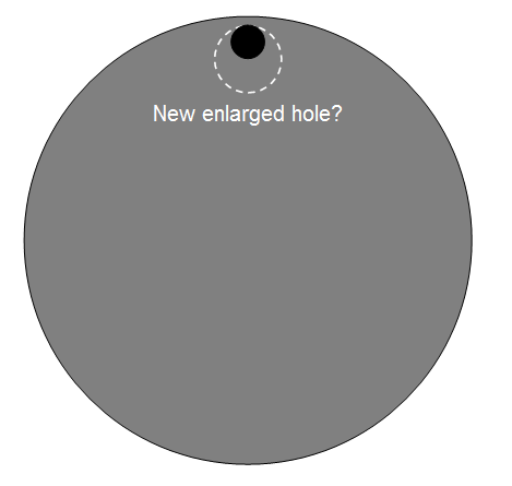

Cant you make the hole bigger? Or put it somewhere else?

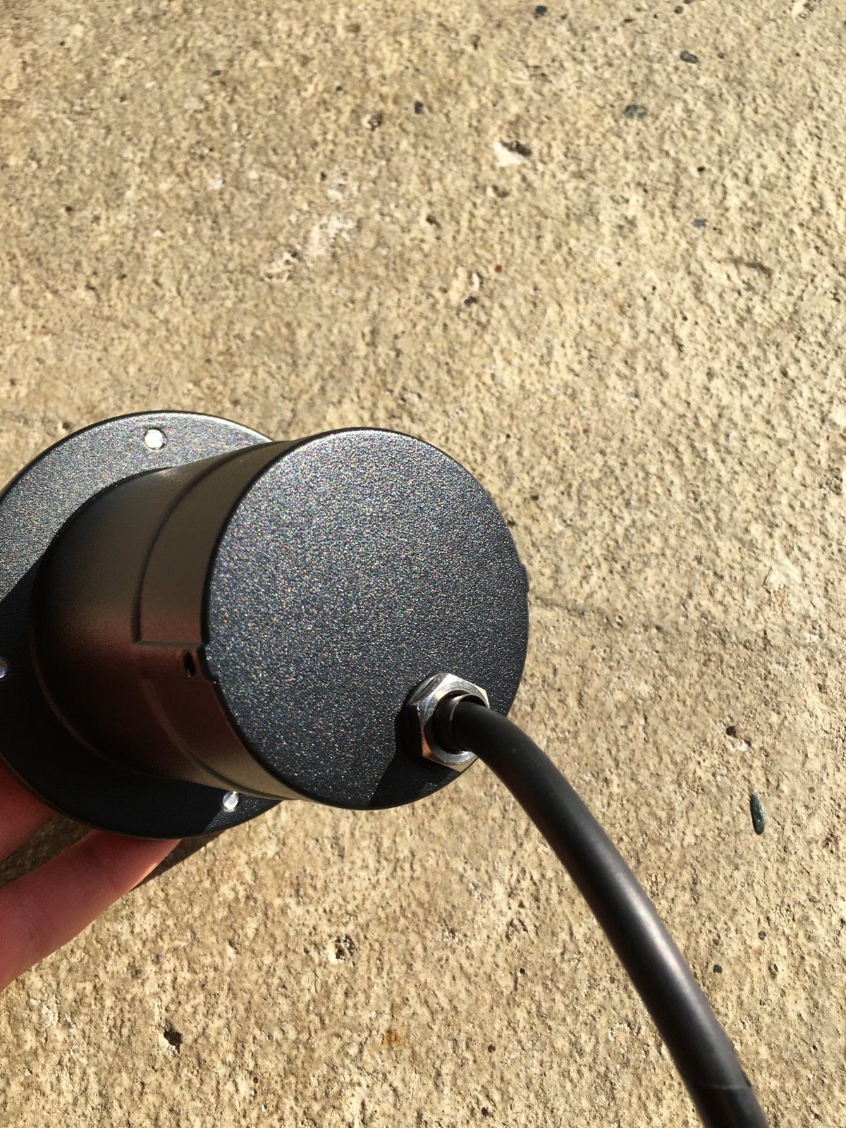

It’s an outside spike light. The hole in the light is right at the edge, so the size can’t be increased, and I don’t think I could make another hole, as the base has lots of mouldings that the gu10 lampholder is attached to.
That’s the back of the light.

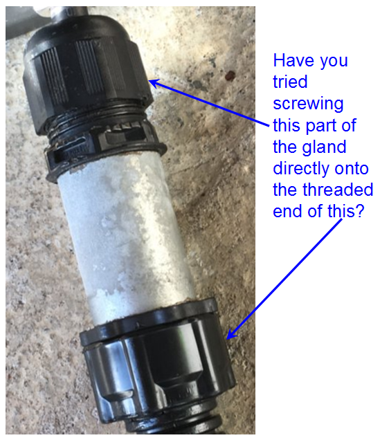

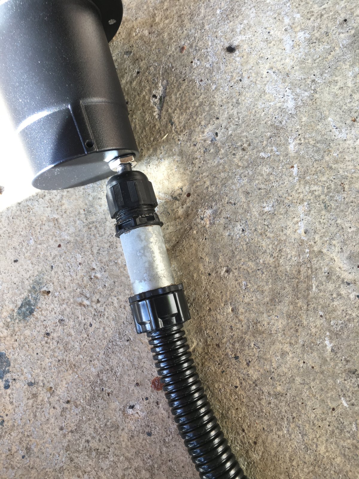

I was thinking of using this at the light end of the conduit.

Some may disagree but i dont like seing cable passing through a Metal unearthed coupler, however no one makes a plastic version, best you can use is two Male couplers and a very short bit of plastic pipe to butt them together.

I could swap the metal coupler for plastic. I thought this might be better than leaving the end open for water or animals to get into, and then get into the junction box.
