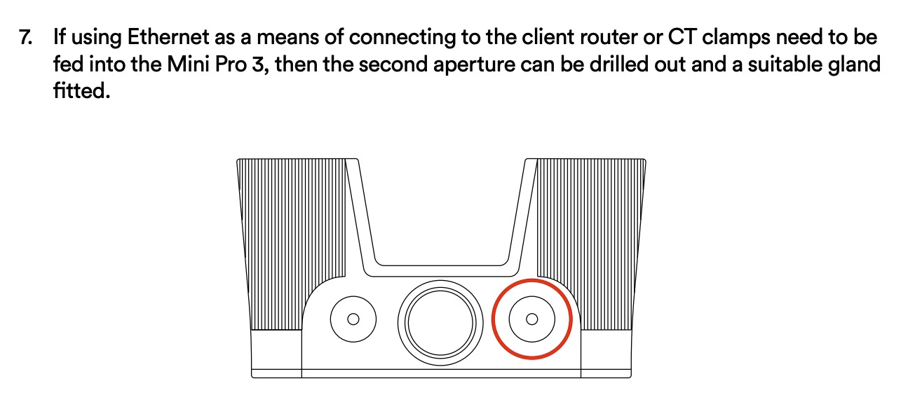

I'm having a EV charger installed, and it optionally can use ethernet.
The manual has this to say about it:
The diameter of that cutout is about 20mm - but I can't find a gland that would both be able to fit an RJ45 plug, which is 12.2mm (even without clip), while also being narrow enough for the cable, which is 4.8mm. The smallest one that would work is called a "PG19" apparently, but the smallest cable size it fits is 12mm, leaving just over 7mm gap.

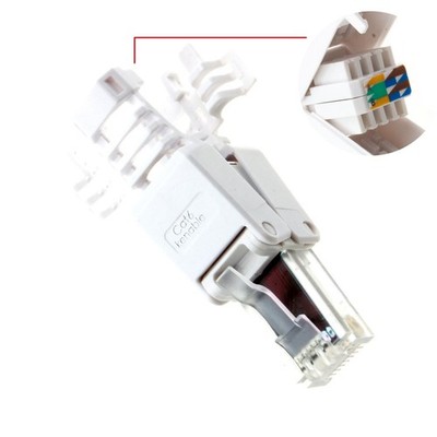

In any case, @Harry Bloomfield seems to have found something suitable?
Thanks - just to confirm, the dimensions I'm looking at here are the "cable diameter min/max", being 4mm/13mm respectively?
The description seems to suggest so.
So the 12mm plug will go through the hole ok, and the gland will close down to the 4.8mm of the cable?
No, will not accommodate the 12mm plug. You have to drill a slightly small hole in the reduction insert, then cut a slot out.
