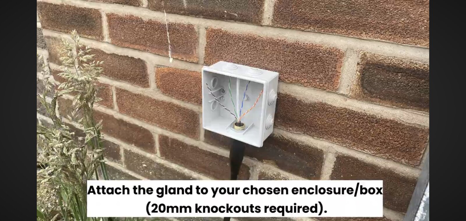

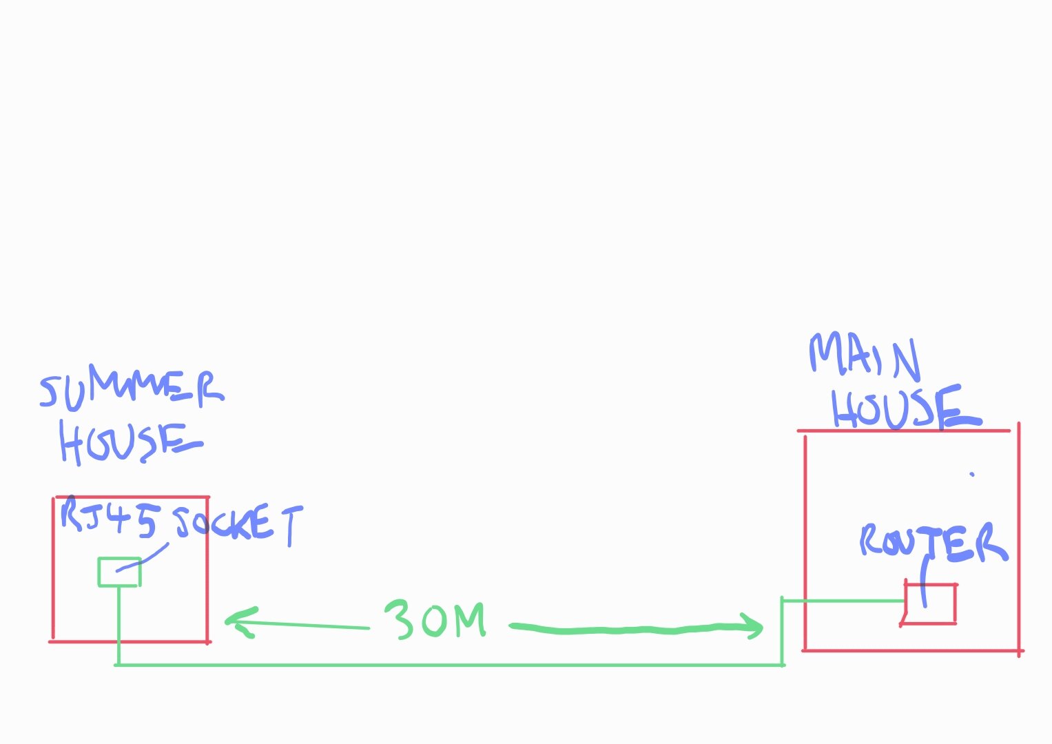

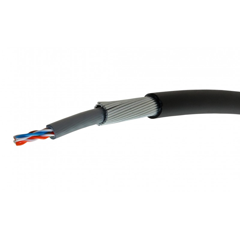

I'm replacing some external grade Cat5e cable with SWA Cat 6 armoured that connects a summer house to the router in the main house, 30m apart (see diagram).
Currently, the cable comes up through the base plate in the timber frame stud wall, and then pops out half way up the wall and punched down into the back of an RJ45 socket in the summer house.
On the house end it comes through the brick wall and travels a few metres before being terminated with an RJ45 connector, which plugs into the back of the router.
Few questions:

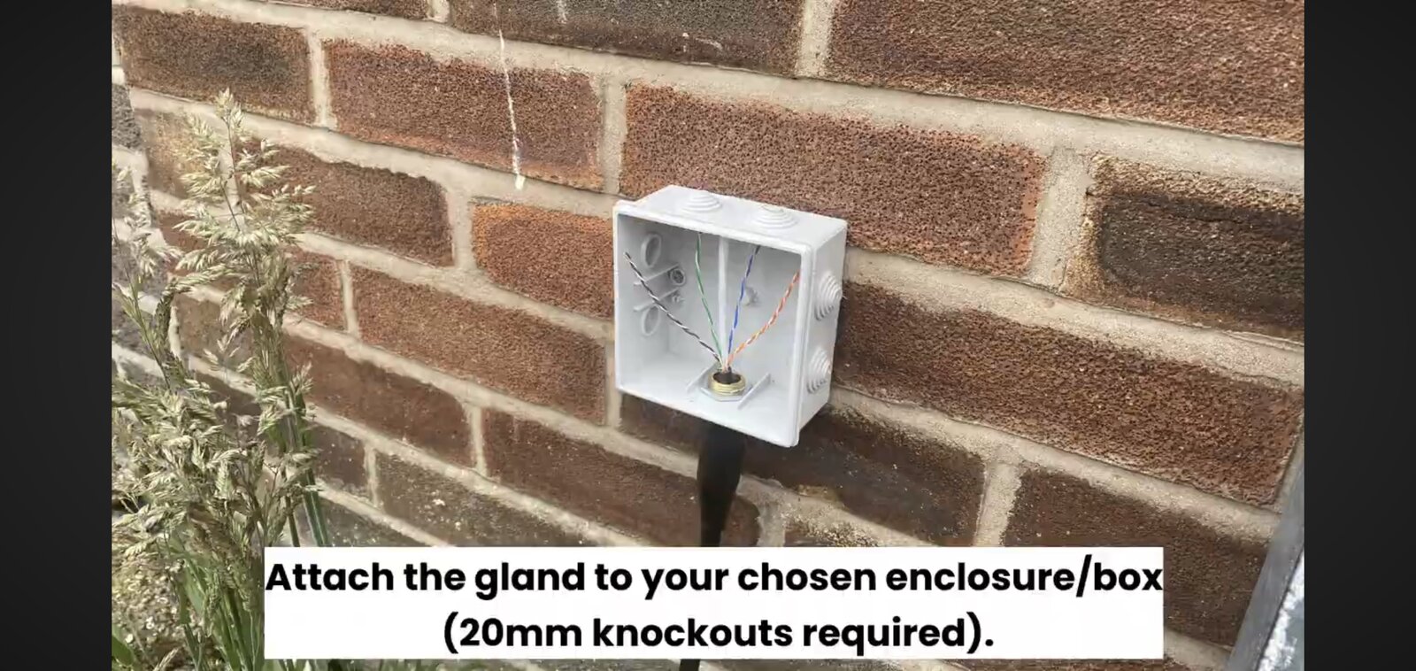

Do you need to ground the metal strands? On the summer house end, I can either run the cable into a Wiska box and gland on the outside, then strip back enough data cable and just pass it through the wall to the RJ45 socket (as per attached image) on the inside of the wall, and that way it is safe.
OR, do I run it up through the studwork like the original cable, strip back, run data into socket, and simply wrap electrical insulating tape over the top of any exposed strands?
On the house end, I'm a bit clueless. Bit ugly having a wiska box inside, and how would you add a faceplate anyway?
I've installed a fair bit of ethernet cable but not armoured, so please explain clearly as I'm no expert. Thanks

For power SWA yes you would normally ground the steel strands using an SWA connector, a banjo and a wire link to the earth bar etc.
Not sure about data swa but I would suggest yes you need to ground that too, not because it is carrying power but it will give a slight shielding effect and it's best being grounded at the source end.
Not sure what you mean. The SWA Cat 6 cable is connected to the main router in the house at one end, and a socket int he summer house at the other
I meant the steel wire armour. I can't see the need.
Any suggestions on how I terminate on the house end? Straight into the back of the router with an RJ45, and insulating tape over the metal strands, or terminate in some sort of internal box, then use a patch lead? If so what type of box? Thanks

I agree. Just ground the one end, it will provide some screening too. If both ends are grounded, you can get ground loops, and it can cause interference.
Use a simple metal box and a SWA gland, then a banjo on the inside to give you a connection point for the earth.
This should then go to your nearest earth point, the router will not provide one.
Failing to earth the outer wires can cause some issues, however you may be able to get away without earthing it.
In that case you will not have any EMI protection around the inner cables.

I did a reverse image search and got the answer from the Q/A section
Personally, I would just cut the SWA back so that it ends inside the exterior wall. The part entering the house will become flexible and can be treated as normal.
From what I have read, if it is unshielded cable and therefore does not need to be earthed.
There is no actual need, it's just belt and braces. Inside, they are twisted pairs, which naturally reject external noise, but the screen will help even more to prevent noise being picked up.
