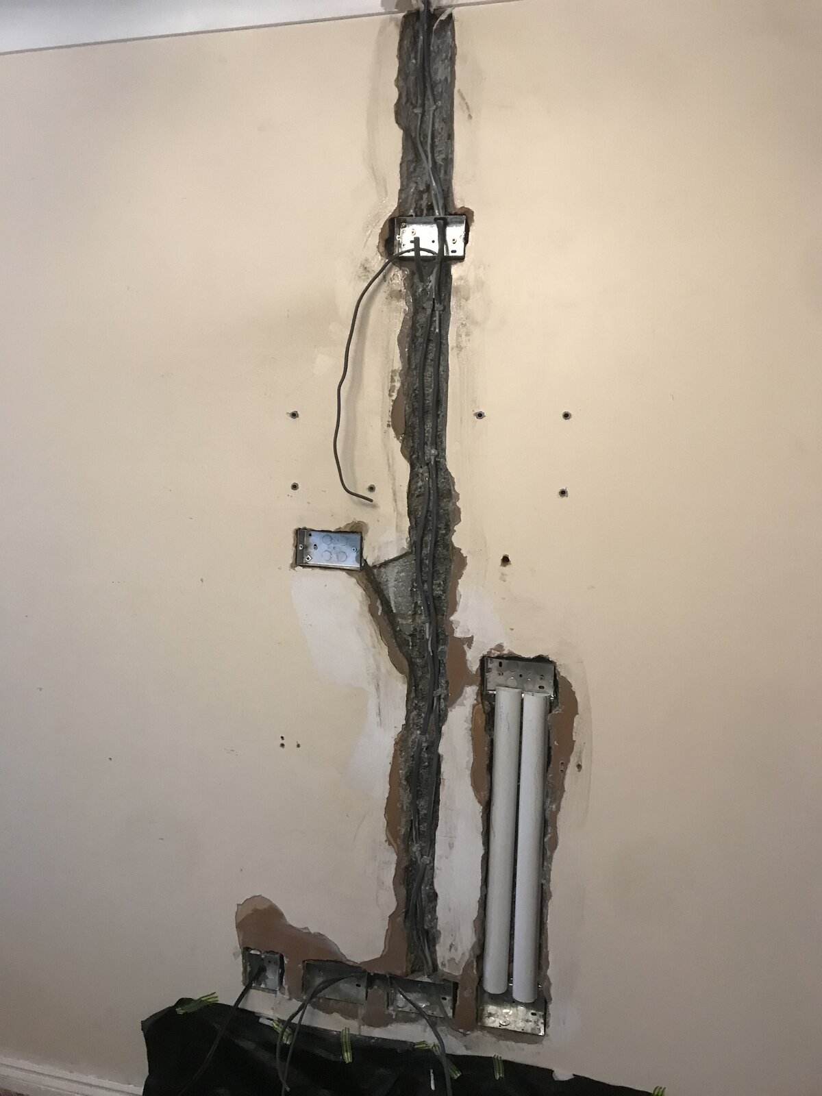

I am setting out some electrics for a wall that will have a TV hung on the wall and a wooden base unit with Sky, DVD, etc. Both of these require power. My plan was to bring a new power supply through the ceiling and down this wall. please see sketch below:
Because I am laying the cables, I know that the central sockets are where the cable is travelling vertical and I can miss this area when fixing the TV bracket to the wall. Anyone approaching this in the future wont know this and can assume that there is cable between the sockets on left too (travelling vertically). Is this bad practice and how do you guys handle this?

The cable routes meet the regulations. The presence of the sockets denote a possible route either horizontally or vertically from the sockets.
Usually a peek inside the socket back box reveals the direction of the cable.

I have a separate thread to determine the most appropriate option. Currently, I am considering the extension of the existing ring to include these sockets. Alternatively, I could wire a new leg into the existing MCB. This would then feed these sockets. the combined load of both rings will still be within 32amps and we will probably have 7 sockets in total across both legs.
Definitely not a spur-on-spur.

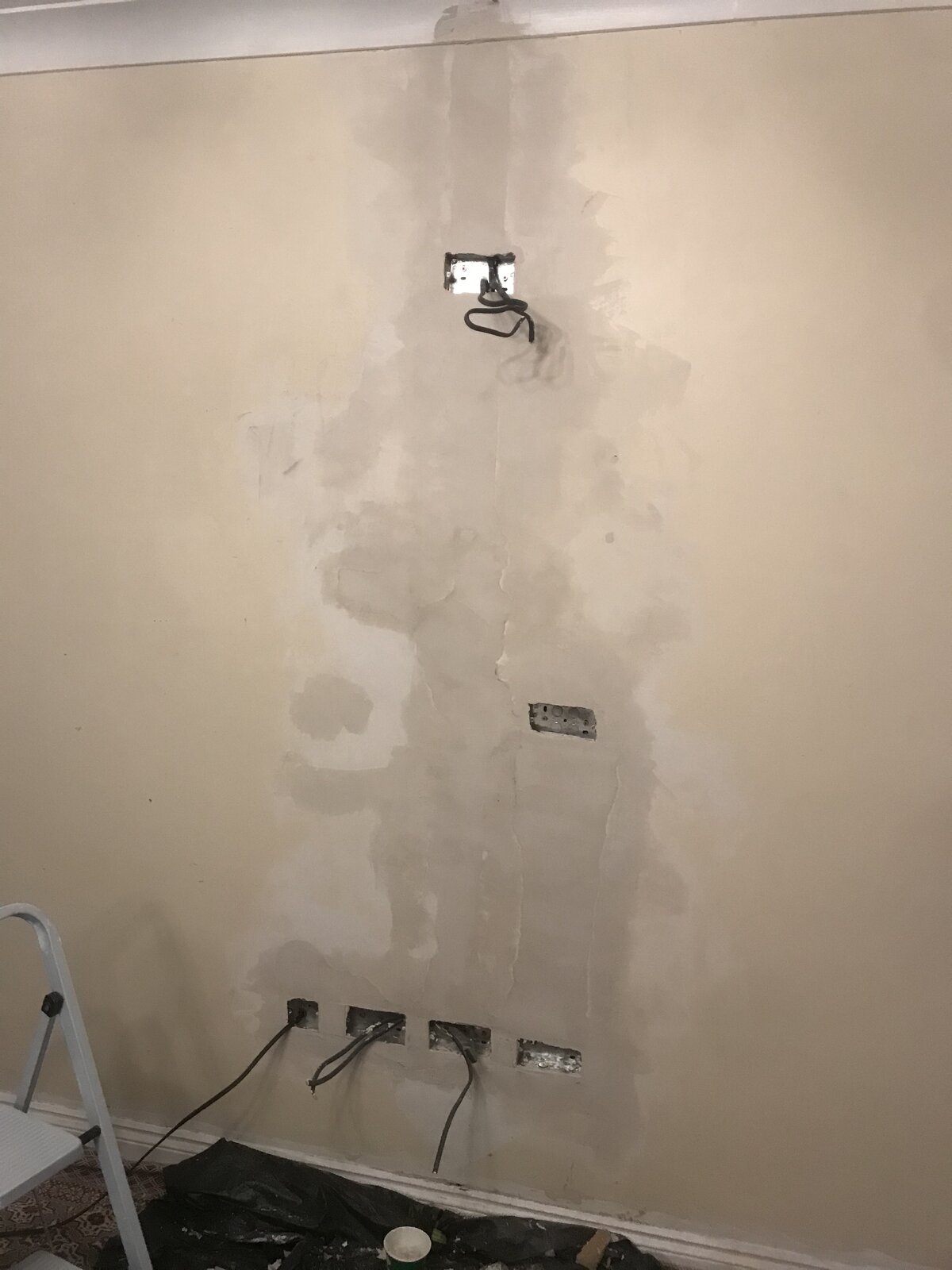

UPDATE: tried to keep these chases as tight as possible but didn’t have too much success. Was using a hammer drill with a chisel bit. I used a drill bit to go around the edges first.
The easifil smoothed it all out in the end.
I’d welcome your feedback and thanks for your help.

what happened to the box above and to the left of the box with two drain pipes below it?? other than that no worse than I have seen
