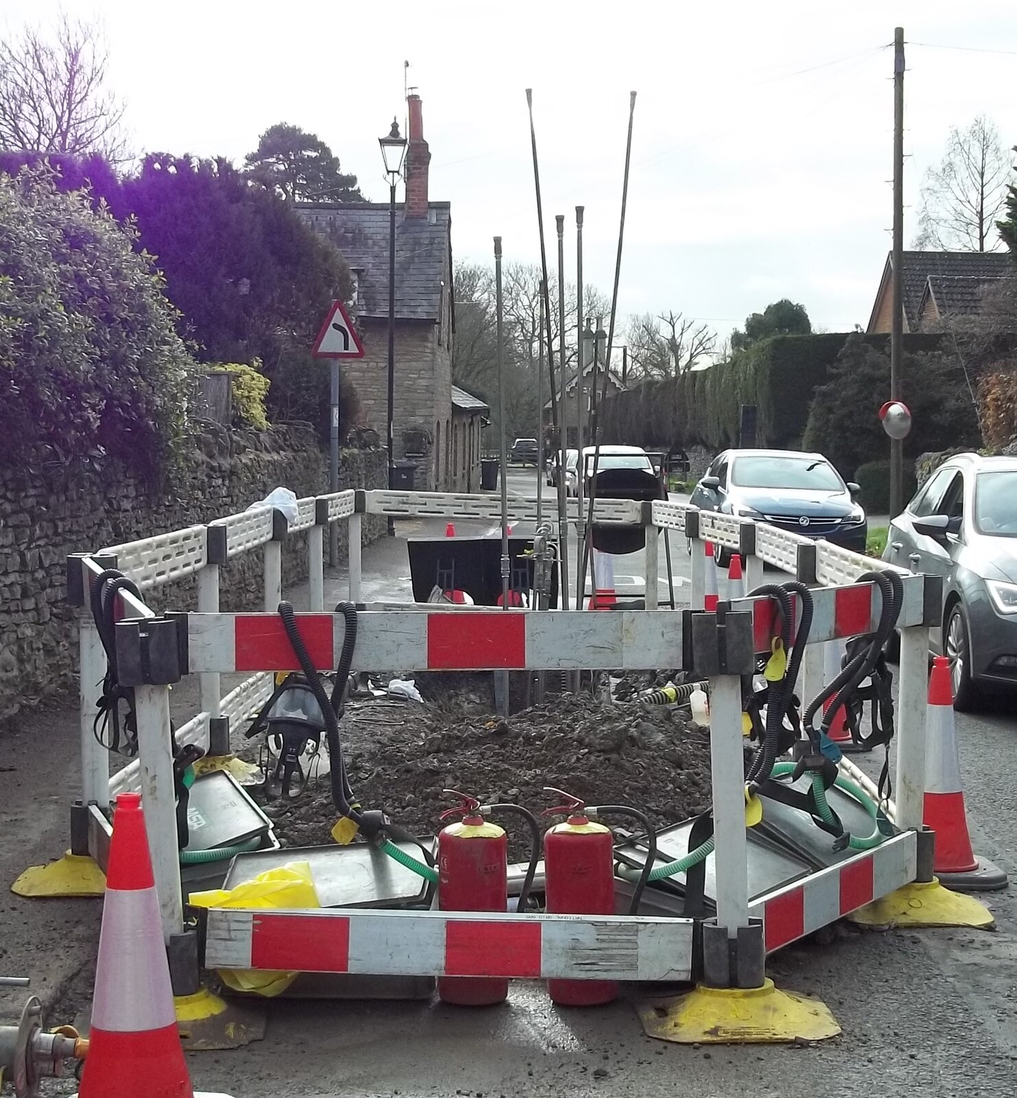

Lpg heavier than air, natural gas lighter than air, iirc relative density?
If it always rises then the vent pipes need not be so tall. ?
because they are not vent pipes, they are flame off points should the gas need to be burned rather than vented, many times it is safer to burn the excess gas rather than release it to atmosphere, if they were just vents the ends would be open, the mushroom shaped parts are flame arrestors that allow the gas to be burned, with no risk of the flame getting back to the gas supply
Also comms engineers ( OpenReach etc ) are required to have gas alarms in place when working at a 18 inch deep inspection chamber even when the chamber is fully open to atmosphere.
Because gas is the same as everything, it is lazy and will always take the easiest path of resistance, ig Nat gas is leaking underground , it will not push up through Tarmac or concrete, it will trac along drains, water pipes , any ducts and rise at the easiest place, hence why anyone working in a drain, duct, inspecion hatch must have nat gas alarms or some way of checking before carrying out any work, it is not just comms engineers

I had believed natural gas was heavier than air and thus would settle in the bottom of a trench. But no I am corrected.
But even so when gas mains are being replaced the safety vents for any gas leaking from the work are much higher than the road surface.

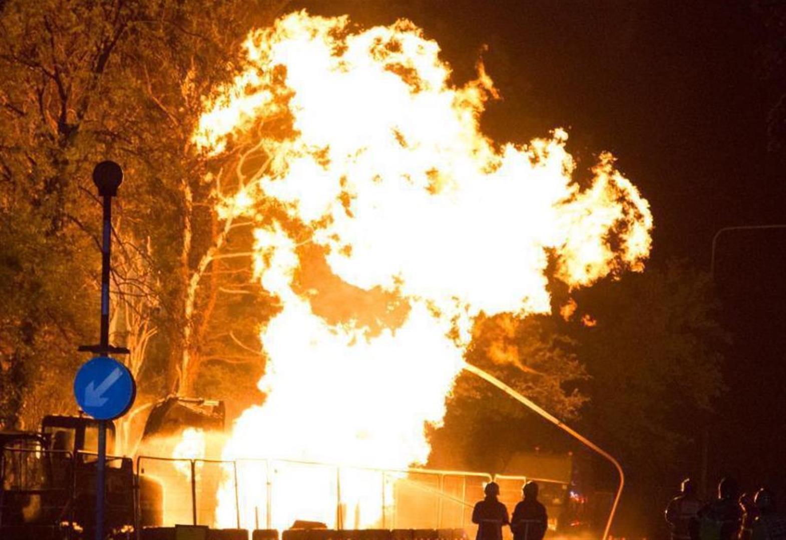

Vents are probably that high to prevent accidental ignition when the main is being purged. If it goes wrong the results can be catastrophic, SGN's Engineers were badly hurt in this incident.
