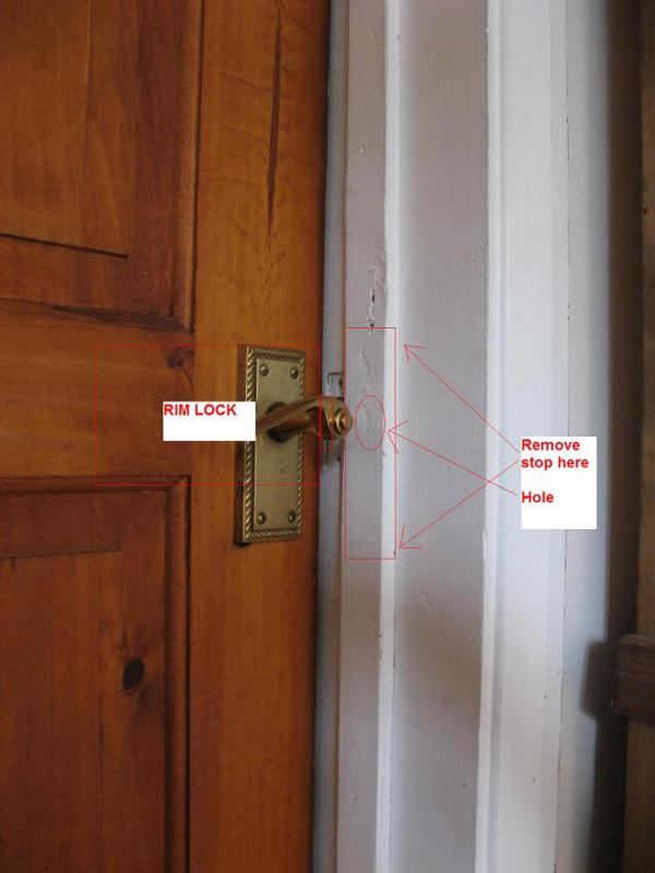

Just in case my first post was not clear, here's an absolutely awful picture, but it should help to illustrate things hopefully. The old handle is still on the door at the moment. Can the rimlock be fitted in the way shown?
So the issue (from what I can tell) is not so much that the latch will need reversing. It's more that the latch (if that's the right term) won't be able to go into a keep, but rather will need to spring into a hole somewhere around where the wooden door stop strip current is.
Thanks again for all the help. Much appreciated.

By internally fitted foxhole means the lock is fitted to the side of the door that opens into the room.Trying to fit the lock externally will be a lot of work for something that won't look right in the end.

as you are not going to use the deadlock part of your rimlock, and the latch part will be tricky to fit, I'd suggest fixing the lock case to the door as an ornament, with a tubular latch in the door, operated by a knob with the spindle passing through the rimlock body.
Tubular latches are available in quite a range of odd sizes, although 63mm in the most popular. You will need to get one with a backset matching the backset of the knob spindle in your rimlock.
If you want to see a typical tubular latch, there will most likely be one in your old door. You drill an 18mm hole (or thereabouts) into the edge of the door to accomodate it. In your case, do it adjacent to the centre ledge of your new LBF door, otherwise screw and glue a lock block to the edge to prevent it splitting.
edited
having looked again at your latest picture, you could set the rimlock back from the door edge enough for the latch not to touch the door lining ("frame") and to engage in the staple ("keep") which you would fix to the stop, perhaps with some chiselling to make it fit.
