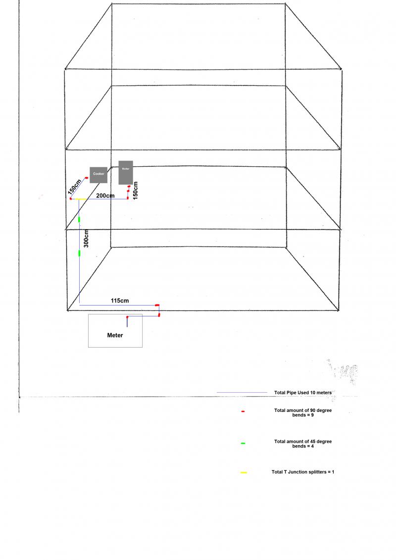

Hi please can anyone help me with this my current boiler Corgi should have a pressure reading of 20 but is currently only reading 12 so has failed it's first service.
the building is a new build and i believe that the person who fitted the pipe work has fitted to small diameter pipes. 22mm have been fitted the meter pressure checked by Bristish Gas is correct and the Engineer also stated that the piping should be 28mm
The Sum is as follows
10 Meters of Pipe
9 x 90 degree bends
4 x 45 degree bends
1 x T Junction Splitter
if it matters 3 meters of the 10 meters pipe is vertical and in those 3 meters the 4 x 45 degree bends are in the middle to take it up and over some brick work
Please help me work out what pipe size I am supposed to have for the following job
The image attached is the layout of the pipes
Impossible to say, without knowing what appliances are connected.
Why not trust the engineer he is most certainly correct, although you probably only need the first few Ms in 28mm.
I assume you're not carrying this work out yourself?
A RGI will be able to do the pipe sizing for you.

I would say its slightly undersized without checking properly, but not enough to cause an 8mb drop. something else must be happening, did the engineer check at the meter?

22mm is fine,(just) which means 2 things.
1. the BG guy hasn't a clue and didn't test it properly, did he wait 10 min.
2. the services pipe is blocked or damaged.

You could have the required 21mb but if the pipe is blocked or squat you won't get the flow rate.
My first concern would be the guy doing the testing at the boiler.
Ask to speak to a manager.
