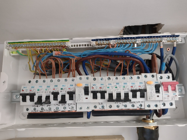

No Mate, this is another consumer unit (pic below)
