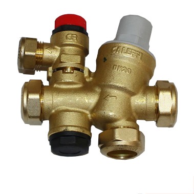

Ah right, thanks. So the valve I have, in addition to the red safety valve that goes to my tundish, has a grey cap with arrows pointing in either direction with + one side and a - on the other with a small black blanking plug in the middle. If I remove the plug there's an allen screw in there. If I turned the screw in the direction of the + will that increase the flow rate through the hot water cylinder (without affecting the pressure) and therefore give me more hot flow at my taps?
My valve looks like this: https://www.screwfix.com/p/strom-cold-water-inlet-control-group-22-x-22mm/1610v
Looking at the write up on it, it says that it 'reduces the water pressure to a safe and acceptable 3 bar for domestic water cylinders'. So, presumably that is factory set, non adjustable, and the adjustable screw only controls the flow?
the red pressure relief valve is pre set and cant be adjusted, the grey regulator should be factory set but can be adjusted but to be honest it shouldnt need to be unless it is faulty, not something a Diyer should be doing though as you can upset the whole control group if you get it wrong
Unfortunately, my advice is that unless you are G3 (unvented) qualified you should not be working on an unvented HW system from the combination valve till after the EV on the hot side.
You could potentially cause a dangerous situation, without knowing it, especially if increasing the inlet pressure above the manufacturers specifications.
Do you know what your cold mains dynamic pressure and flow is?
If the cold is running higher than the hot unvented then the cold supply probably hasn't been piped from the combi valve, it'll be fed directly from the incoming mains (Before the reducing valve)
I think that’s true. In the picture above, mains feed goes in the top, feed to the hot water cylinder comes out the bottom, the port with the blanking plug goes to the white expansion cylinder, the 15mm connection goes to the tundish and the remaining 22mm compression connection is blanked off. Should the cold feed come out of that one?
