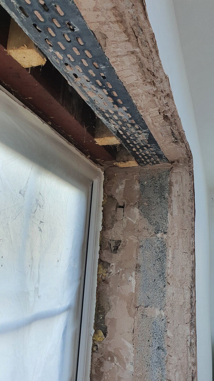

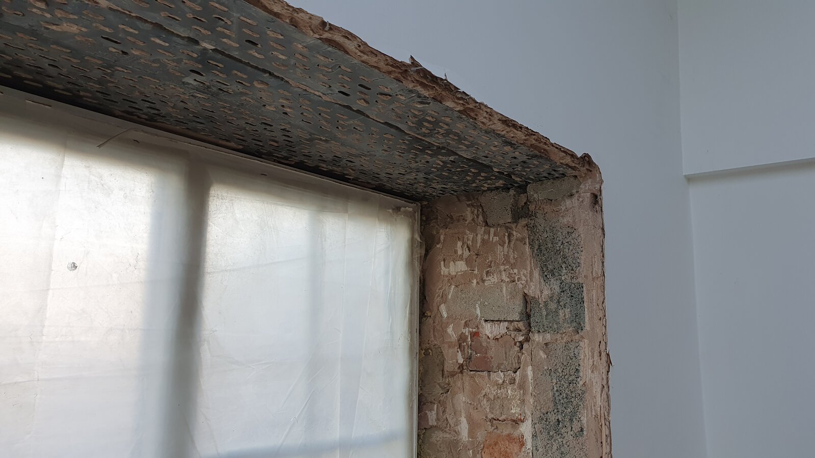

I've just chipped some of the plaster from the top of a cold window reveal. Above the 10mm of plaster there is a perforated metal window lintel. Icy cold. Also blowing Icy wind though it. No wonder there's so much condensation! Fitted in the early 80's.
When I do the internal insulation is there any reason why I can't fill the lintel with expanding foam?
What do you think?
Won't hurt, new builds have cavity closers on 4 sides to stop this, wouldn't hurt you doing top and both sides if your decorating at some point
Ah thank you. Makes you wonder why no-one had thought of the importance of insulation back then.Or did we all just expect to be cold through the winter and wear wooly jumpers? I remember it always being freezing in our house.
Anyway, when I have removed all the plaster from the reveals I'm hoping to get 10mm of aerogel blanket in there. I hope it will adhere to the metal lintel ok. But i will still be short of space for the PB. I'm looking at 6mm cement board. or 3mm if i could find a supplier. Can't think how to fix it to the top reveal tthough. Looks like its going to be mainly instastik at the moment.:)
If I use aerogel blanket on the top reveal, how will I attach the pb/Mg0? Can I use adhesive in both layers?
