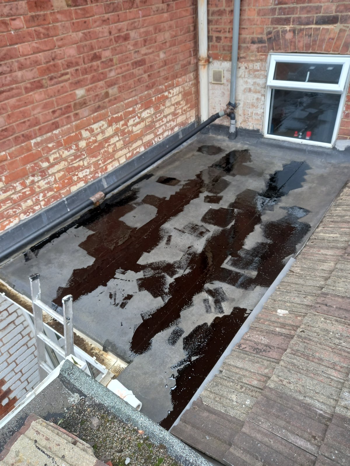

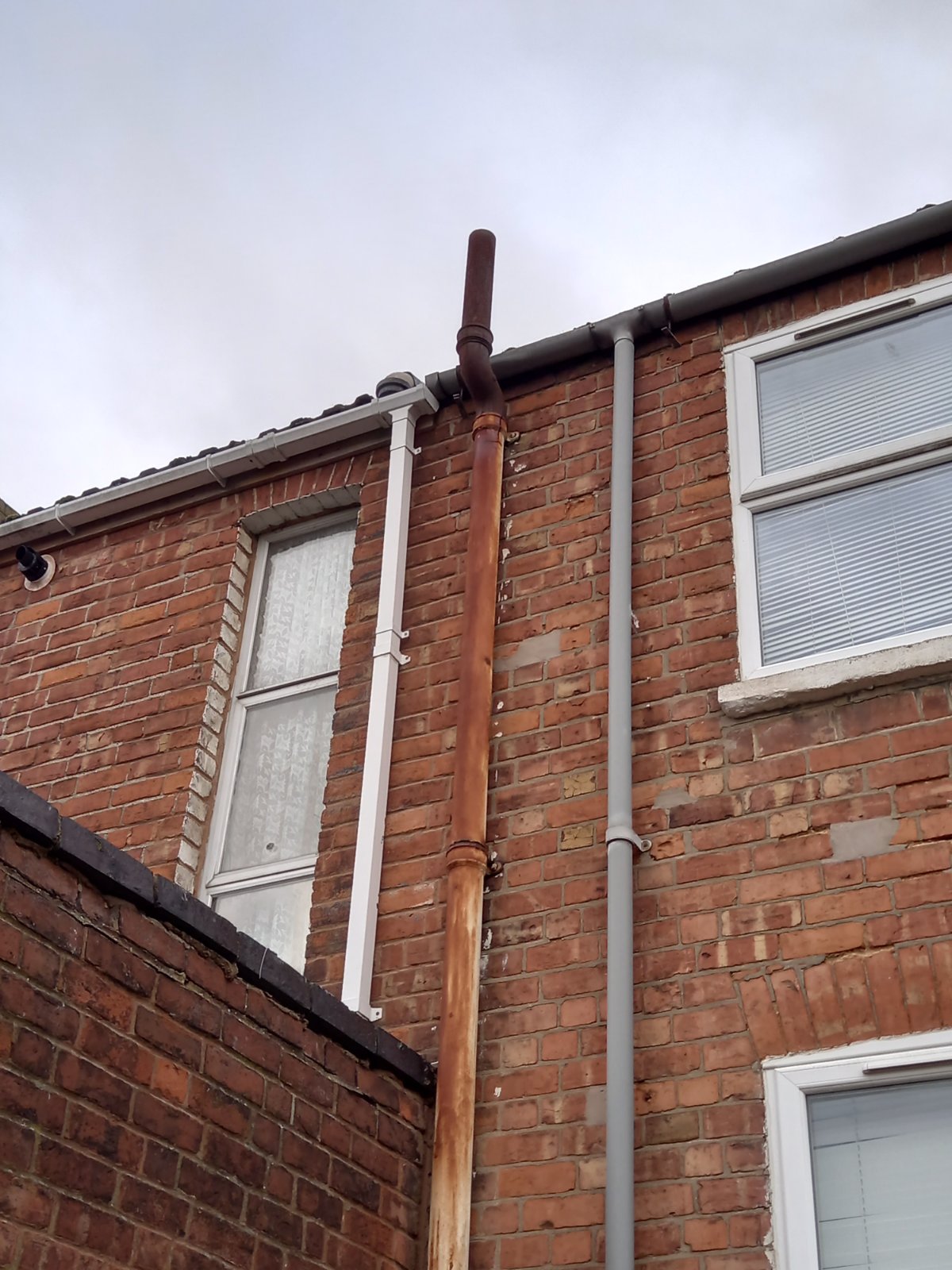

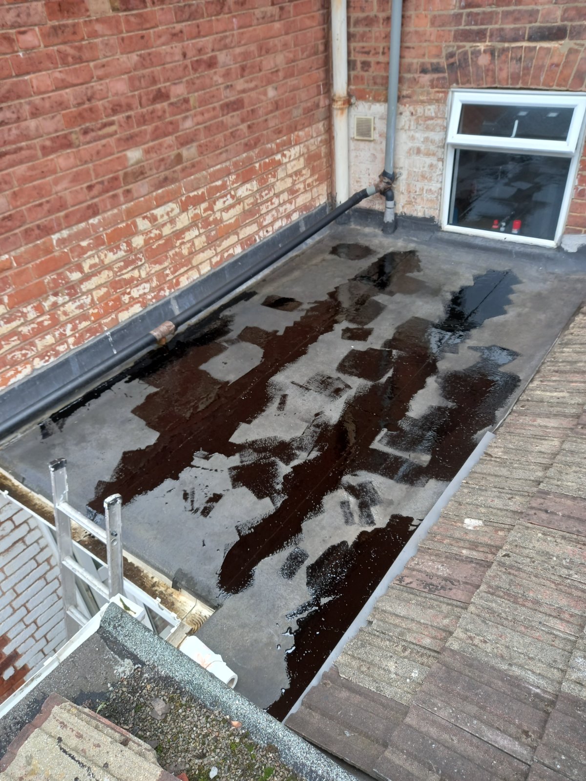

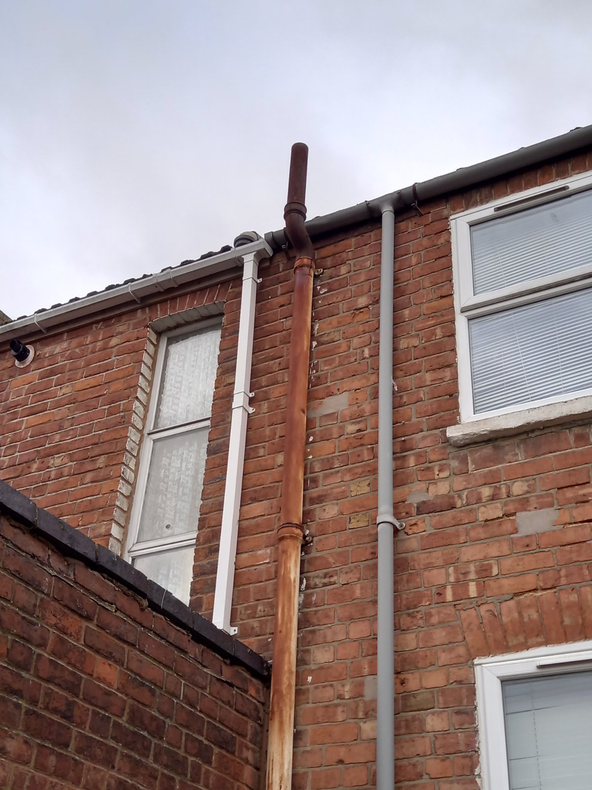

I'm aware that external AAVs are available, my query is: can I use one to replace the current (rotted) S&V and if so, can I get away without it needing to exit above the highest window?
As per the pics, I'm dealing with a high, 3-storey building. Access to replace the cast-iron pipe will need scaffolding at £1k a pop.
The flat roof btw is being replaced as I type, with EPDM rubber sheet and the rainwater pipe re-jigged to drain directly on to the roof rather than my heath-robinson affair seen here.

Better with an open vent, but yes, you could fit one lower down.
Drains need to breathe out as well as in! I would be very wary of changing an open vent for an AAV, as you're essentially then sealing the system, and could well find you start experiencing issues you didn't have before....
Assuming you'll have a scaffold of sufficient height to safely remove the top section of cast, I would be replacing like for like whilst access is available. Getting back up there at a later date to swap an AAV for an open vented section isn't going to be straightforward at that sort of height.
Advice is given based on over 30 years of experience in Plumbing and Drainage, having re read through the thread you have linked to in your initial post, I am reminded why I stopped commenting....
From the photos there do not appear to be any branch waste pipes connecting to the stack so why do you want to fit an external AAV? It only needs to be above the lowest sanitary appliance so maybe you could fit it on the ground floor below the flat roof? Unless I'm missing something?
It's boxed-in, inside.
If using an AAV it doesn't need to exit above the windows then it'd certainly be easier to fit and maintain than the current setup.
