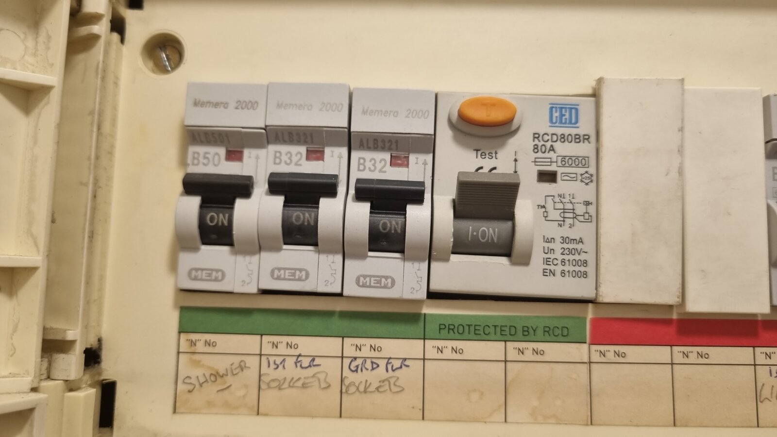

Removing electric shower, putting in a Stuart Turner 3 bar shower pump instead.
We have power for the shower running into the consumer unit with a 50 amp breaker and 30mA RCD.
Can this be used to power the pump (on a 5 amp spur)? No pull cord but there's a chunky switch in the airing cupboard.
Assuming that the cable is physically able to fit into the terminals (chunky 17mm cable).

Hot and cold water. Yes it will go at the base of the hot water tank and will be done properly with the correct flanges, full bore valves etc..
We don't have an electric immersion for some reason, central heating pump is a possibility but will need to check where the wires go.
The power for the shower would be more convenient since we can use smaller cable from the socket and then into a fused spur then into the pump. Would it be better to replace the 50amp breaker with a 32amp and use it?

I see no reason why not - after all, it's just 'a circuit', which is otherwise no longer going to be used. A 50A breaker and the large cable are obviously very serious 'overkill' for just a pump, but if that is supplied via a 5A FCU, there's no problem with that.

The only issue is the possible confusion for someone in the future trying to work out the isolation.
At least whilst it's all the circuit is doing, at the CU the label can be changed from "Showier" to "Shower Pump" and, of course, actual 'isolation' of the pump will be achievable (more locally to the pump) at the FCU (assuming it's a switched one - and the fuse can also be removed)..

Certainly does say "Shower". Will also put "Pump", and label the switch in the airing cupboard too.
