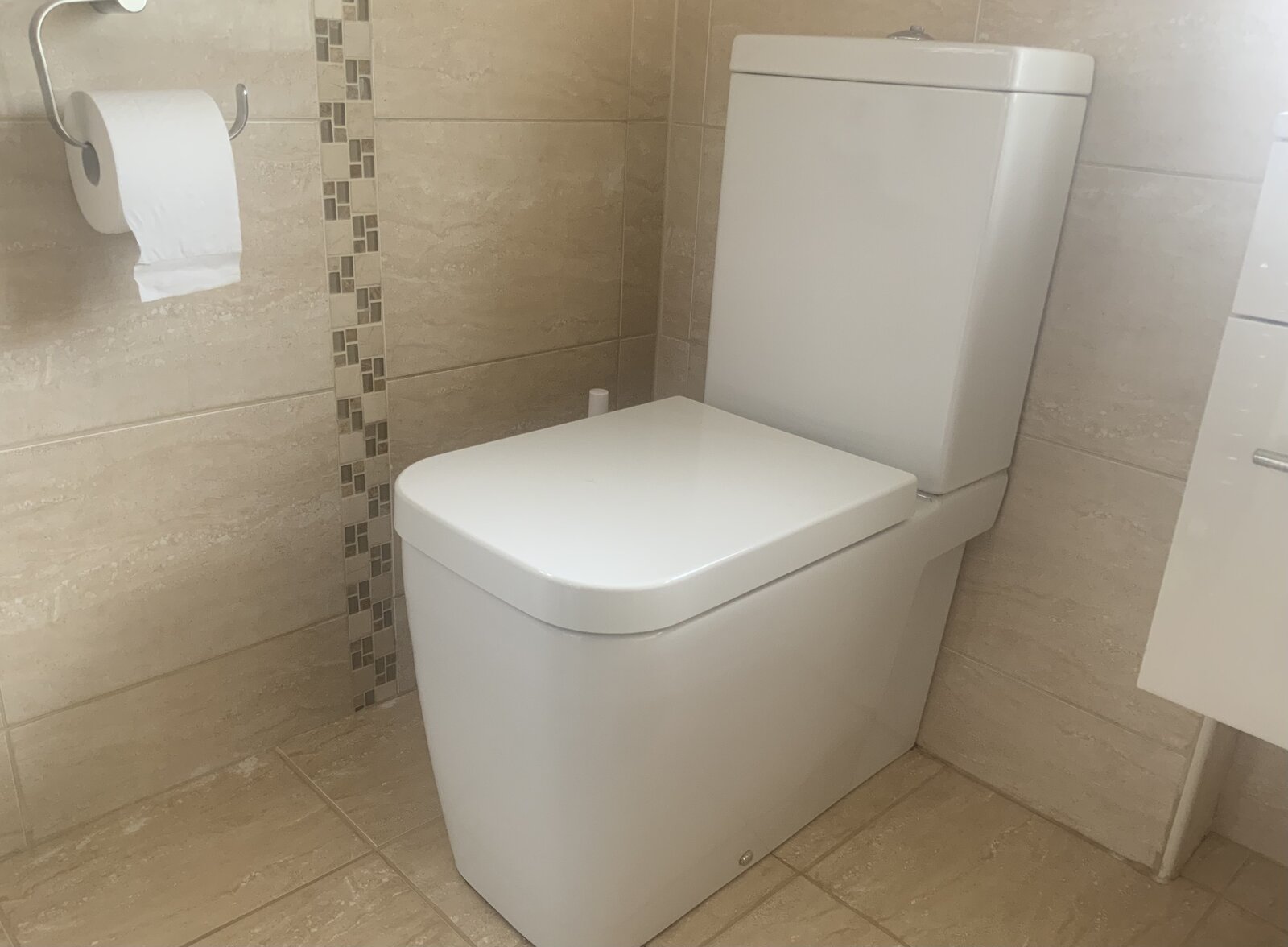

Can my WC flush valve be repaired in situ?
Yeah, it is the flush valve. Tried turning it and no joy as in my post #6. Guess I’ll have to take the whole bog out and it’s usually a bit of a pain. Can't get at anything until it’s removed in one piece. This type:

Just have. All done now. (y) Like an idiot, I was trying to turn the whole body, not just the top section!
I now consider myself a fully qualified plumber. ;)

Back on subject. It’s started doing the same again. Just bad luck? Fit another flush valve? Also, just as the fill comes to a stop, it makes an 'orrible screeching sound. New fill valve needed as well or can they be repaired in situ as it is a right palaver getting the bog out.
Post a picture of what is fitted in the cistern.
Andy
Andy. This is it with the blue cap removed. Are there any user replaceable parts inside although I’ve just been rattling the float lever up and down for a bit and now it makes a short 'eek' when shutting down instead of a 10 second 'eeeeeeeeeeeeeeeeeeeeeeeeeeeeek'. Could I have dislodged a bit of limescale?
Also, the flush valve was replaced just over a year ago and occasionally leaks. I only found that out when the cystern started filling and 'eeeeeeeeeeeking' every 15 minutes during the night. I imagine I’ve just been unlucky with the fill valve and will need to replace it again.
