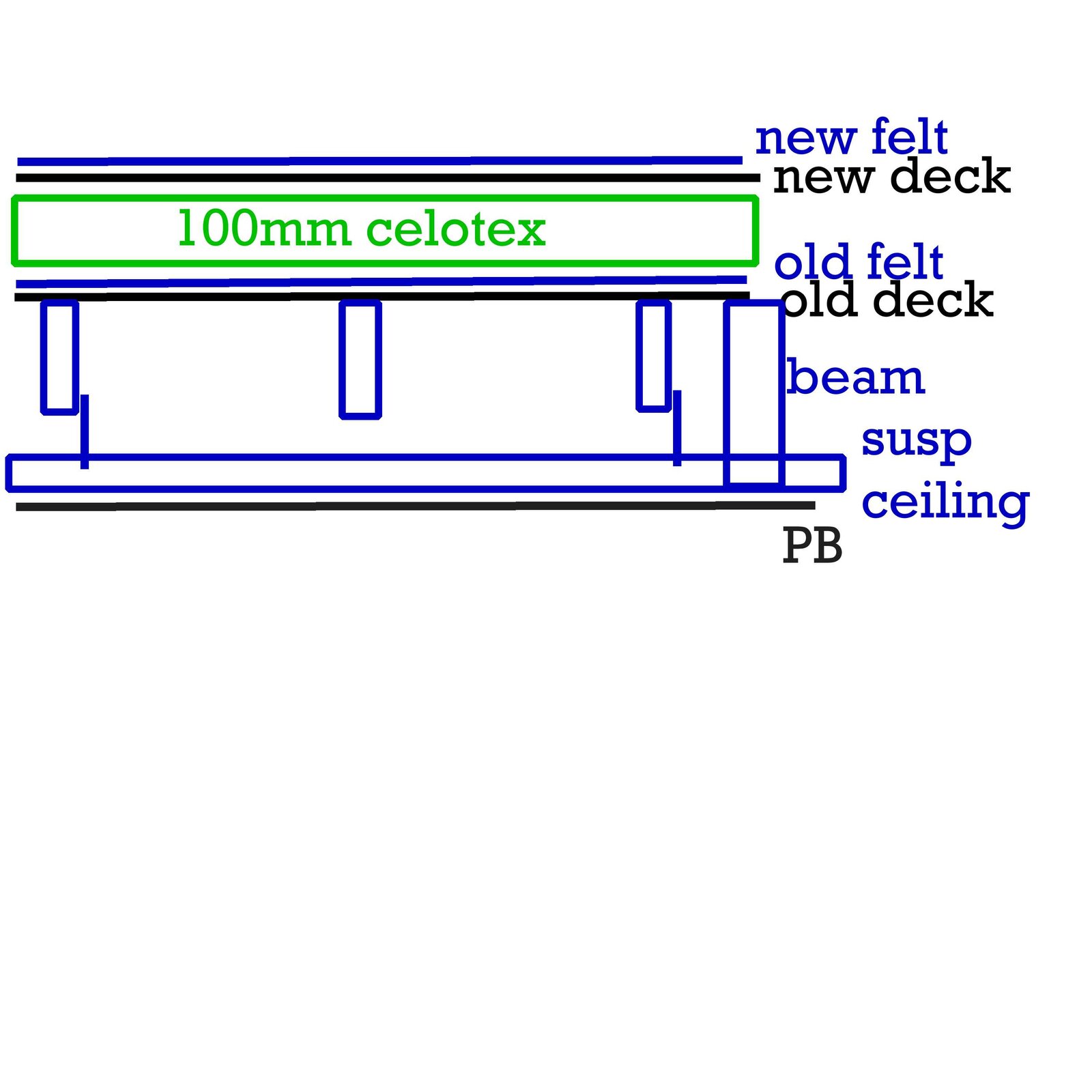

Before digging into this post too much further I'd like to see a sketch of the cross section you have
100% correct there - it is a warm deck flat roof.
I know we can get DPM in liquid form (i.e. Blackjack etc), and as this is going to be in a protected space then I'd be surprised if there isn't liquid VB too, although it's not the traditional method used.

What's the condition of the old felt?
