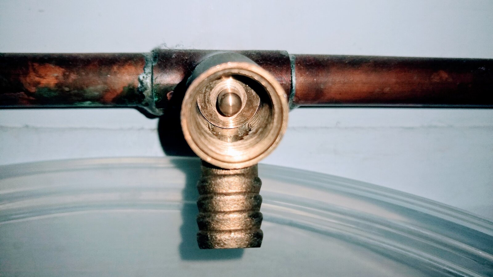

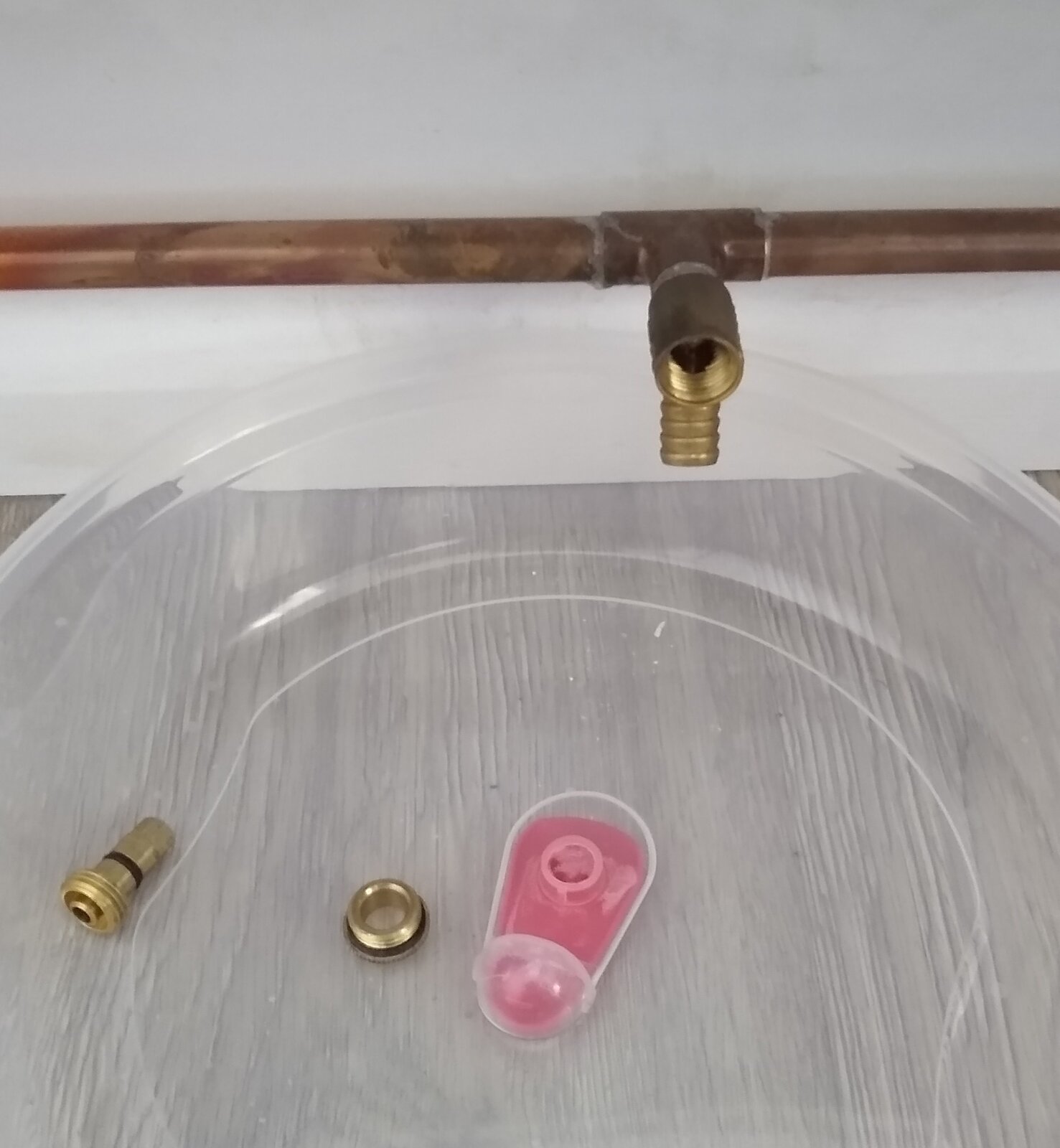

Can't drain system
17 Dec 2018
529
10
have switched off the boiler
Stuck the hose on the drain off
Opened it up and nothing.
I've even taken the whole thing apart and still nothing. I have opened/closed the bleed valves and still nothing
What else can i do?

Here's a pic of the inside of the drain valve

If i stick the hose on the bottom
And my thumb on the hole will i be okay?
Or should i cover everything in my room from the inevitable soaking? :D
Thanks guys.
Once the jobs done, do i need replace anything? Like washers to prevent leakage or should i just replace if i notice a leak?
The drain valve is only 5 months old
If you're draining down the whole system, can you drain the bulk of the water from a different drain-cock? That would limit the flood when the washer comes out!
just have the origional bits that you have removed ready and when you pull the washer out , screw the other bits back on , its called snatching its great fun
Please video you doing it and post it on here!
You can also earn £250.
Andy
I would have filmed it.. But you would have been disappointed :D:D
It was easy work. Stuck a flat head screwdriver in the hole, wiggled it a bit..
Water started coming out... Nothing major.. Simple stuck my wet vac on the end to contain the water and drain the system fast..
Easy job.. Thanks for the advice guys
